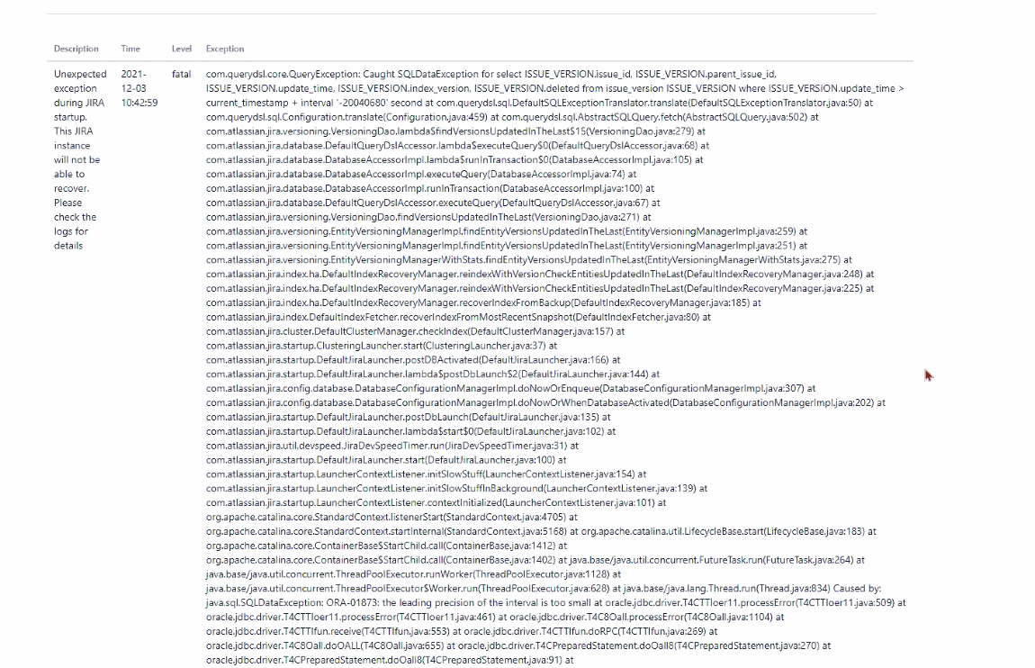

Jira fails to startup, due to the following ORA-01873 SQLDataException is thrown in the Jira UI:
Full error message: ORA-01873: the leading precision of the interval is too small

    2021-12-03 07:49:06,798-0700 localhost-startStop-1 ERROR [c.a.jira.startup.LauncherContextListener] Unable to start JIRA. com.querydsl.core.QueryException: Caught SQLDataException for select ISSUE_VERSION.issue_id, ISSUE_VERSION.parent_issue_id, ISSUE_VERSION.update_time, ISSUE_VERSION.index_version, ISSUE_VERSION.deleted from issue_version ISSUE_VERSION where ISSUE_VERSION.update_time > current_timestamp + interval '-20030247' second at com.querydsl.sql.DefaultSQLExceptionTranslator.translate(DefaultSQLExceptionTranslator.java:50) at com.querydsl.sql.Configuration.translate(Configuration.java:459) at com.querydsl.sql.AbstractSQLQuery.fetch(AbstractSQLQuery.java:502) at com.atlassian.jira.versioning.VersioningDao.lambda$findVersionsUpdatedInTheLast$15(VersioningDao.java:279) at com.atlassian.jira.database.DefaultQueryDslAccessor.lambda$executeQuery$0(DefaultQueryDslAccessor.java:68) at com.atlassian.jira.database.DatabaseAccessorImpl.lambda$runInTransaction$0(DatabaseAccessorImpl.java:105) at com.atlassian.jira.database.DatabaseAccessorImpl.executeQuery(DatabaseAccessorImpl.java:74) at com.atlassian.jira.database.DatabaseAccessorImpl.runInTransaction(DatabaseAccessorImpl.java:100) at com.atlassian.jira.database.DefaultQueryDslAccessor.executeQuery(DefaultQueryDslAccessor.java:67) at com.atlassian.jira.versioning.VersioningDao.findVersionsUpdatedInTheLast(VersioningDao.java:271) at com.atlassian.jira.versioning.EntityVersioningManagerImpl.findEntityVersionsUpdatedInTheLast(EntityVersioningManagerImpl.java:259) at com.atlassian.jira.versioning.EntityVersioningManagerImpl.findEntityVersionsUpdatedInTheLast(EntityVersioningManagerImpl.java:251) at com.atlassian.jira.versioning.EntityVersioningManagerWithStats.findEntityVersionsUpdatedInTheLast(EntityVersioningManagerWithStats.java:275) at com.atlassian.jira.index.ha.DefaultIndexRecoveryManager.reindexWithVersionCheckEntitiesUpdatedInTheLast(DefaultIndexRecoveryManager.java:248) at com.atlassian.jira.index.ha.DefaultIndexRecoveryManager.reindexWithVersionCheckEntitiesUpdatedInTheLast(DefaultIndexRecoveryManager.java:225) at com.atlassian.jira.index.ha.DefaultIndexRecoveryManager.recoverIndexFromBackup(DefaultIndexRecoveryManager.java:185) at com.atlassian.jira.index.DefaultIndexFetcher.recoverIndexFromMostRecentSnapshot(DefaultIndexFetcher.java:80) at com.atlassian.jira.cluster.DefaultClusterManager.checkIndex(DefaultClusterManager.java:157) at com.atlassian.jira.startup.ClusteringLauncher.start(ClusteringLauncher.java:37) at com.atlassian.jira.startup.DefaultJiraLauncher.postDBActivated(DefaultJiraLauncher.java:166) at com.atlassian.jira.startup.DefaultJiraLauncher.lambda$postDbLaunch$2(DefaultJiraLauncher.java:144) at com.atlassian.jira.config.database.DatabaseConfigurationManagerImpl.doNowOrEnqueue(DatabaseConfigurationManagerImpl.java:307) at com.atlassian.jira.config.database.DatabaseConfigurationManagerImpl.doNowOrWhenDatabaseActivated(DatabaseConfigurationManagerImpl.java:202) at com.atlassian.jira.startup.DefaultJiraLauncher.postDbLaunch(DefaultJiraLauncher.java:135) at com.atlassian.jira.startup.DefaultJiraLauncher.lambda$start$0(DefaultJiraLauncher.java:102) at com.atlassian.jira.util.devspeed.JiraDevSpeedTimer.run(JiraDevSpeedTimer.java:31) at com.atlassian.jira.startup.DefaultJiraLauncher.start(DefaultJiraLauncher.java:100) at com.atlassian.jira.startup.LauncherContextListener.initSlowStuff(LauncherContextListener.java:154) at com.atlassian.jira.startup.LauncherContextListener.initSlowStuffInBackground(LauncherContextListener.java:139) at com.atlassian.jira.startup.LauncherContextListener.contextInitialized(LauncherContextListener.java:101) ... 5 filtered at java.base/java.util.concurrent.FutureTask.run(FutureTask.java:264) at java.base/java.util.concurrent.ThreadPoolExecutor.runWorker(ThreadPoolExecutor.java:1128) at java.base/java.util.concurrent.ThreadPoolExecutor$Worker.run(ThreadPoolExecutor.java:628) at java.base/java.lang.Thread.run(Thread.java:834) Caused by: java.sql.SQLDataException: ORA-01873: the leading precision of the interval is too small at oracle.jdbc.driver.T4CTTIoer11.processError(T4CTTIoer11.java:509) at oracle.jdbc.driver.T4CTTIoer11.processError(T4CTTIoer11.java:461) at oracle.jdbc.driver.T4C8Oall.processError(T4C8Oall.java:1104) at oracle.jdbc.driver.T4CTTIfun.receive(T4CTTIfun.java:553) at oracle.jdbc.driver.T4C8Oall.doOALL(T4C8Oall.java:655) at oracle.jdbc.driver.T4CPreparedStatement.doOall8(T4CPreparedStatement.java:270) at oracle.jdbc.driver.T4CPreparedStatement.doOall8(T4CPreparedStatement.java:91) at oracle.jdbc.driver.T4CPreparedStatement.executeForDescribe(T4CPreparedStatement.java:807) at oracle.jdbc.driver.OracleStatement.executeMaybeDescribe(OracleStatement.java:983) at oracle.jdbc.driver.OracleStatement.doExecuteWithTimeout(OracleStatement.java:1168) at oracle.jdbc.driver.OraclePreparedStatement.executeInternal(OraclePreparedStatement.java:3666) at oracle.jdbc.driver.T4CPreparedStatement.executeInternal(T4CPreparedStatement.java:1426) at oracle.jdbc.driver.OraclePreparedStatement.executeQuery(OraclePreparedStatement.java:3713) at oracle.jdbc.driver.OraclePreparedStatementWrapper.executeQuery(OraclePreparedStatementWrapper.java:1167) at org.apache.commons.dbcp2.DelegatingPreparedStatement.executeQuery(DelegatingPreparedStatement.java:83) at org.apache.commons.dbcp2.DelegatingPreparedStatement.executeQuery(DelegatingPreparedStatement.java:83) at com.atlassian.jira.ofbiz.sql.PreparedStatementWrapper.executeQuery(PreparedStatementWrapper.java:42) at com.atlassian.jira.diagnostic.connection.DiagnosticPreparedStatement.lambda$executeQuery$5(DiagnosticPreparedStatement.java:59) at com.atlassian.diagnostics.internal.platform.monitor.db.DefaultDatabaseDiagnosticsCollector.recordExecutionTime(DefaultDatabaseDiagnosticsCollector.java:70) at com.atlassian.jira.diagnostic.connection.DatabaseDiagnosticsCollectorDelegate.recordExecutionTime(DatabaseDiagnosticsCollectorDelegate.java:55) at com.atlassian.jira.diagnostic.connection.DiagnosticPreparedStatement.executeQuery(DiagnosticPreparedStatement.java:59) at com.querydsl.sql.AbstractSQLQuery.fetch(AbstractSQLQuery.java:446) ... 36 more Caused by: Error : 1873, Position : 236, Sql = select ISSUE_VERSION.issue_id, ISSUE_VERSION.parent_issue_id, ISSUE_VERSION.update_time, ISSUE_VERSION.index_version, ISSUE_VERSION.deleted from issue_version ISSUE_VERSION where ISSUE_VERSION.update_time > current_timestamp + interval '-20030247' second, OriginalSql = select ISSUE_VERSION.issue_id, ISSUE_VERSION.parent_issue_id, ISSUE_VERSION.update_time, ISSUE_VERSION.index_version, ISSUE_VERSION.deleted from issue_version ISSUE_VERSION where ISSUE_VERSION.update_time > current_timestamp + interval '-20030247' second, Error Msg = ORA-01873: the leading precision of the interval is too small ... 58 more
