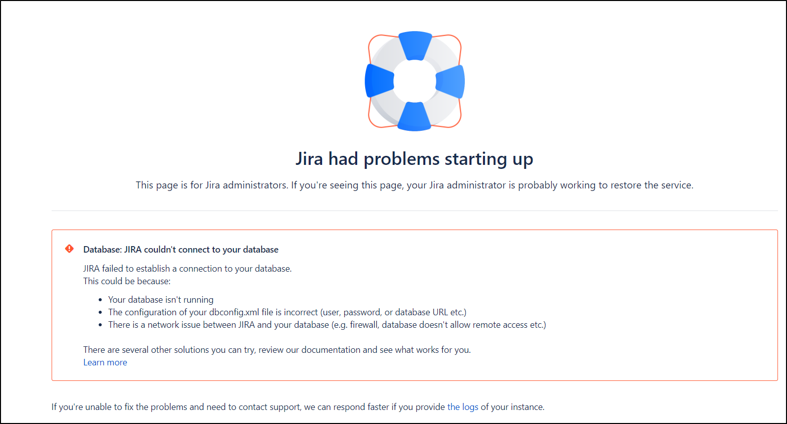

When starting up Jira, you encounter the following warning.
Reviewing the atlassian-jira.log we can see that the startup fails due to Jira not being allowed to retrieve the database public key.
atlassian-jira.log
1 2 3 4 5 6 7 8 9 10 11 12 13 14 15 16 17 18 19 20 21 22 23 24 25 26 27 28 29 2024-03-13 17:47:05,013-0500 JIRA-Bootstrap ERROR      [c.a.config.bootstrap.DefaultAtlassianBootstrapManager] Could not successfully test your database:  java.sql.SQLNonTransientConnectionException: Public Key Retrieval is not allowed     at com.mysql.cj.jdbc.exceptions.SQLError.createSQLException(SQLError.java:111)     at com.mysql.cj.jdbc.exceptions.SQLExceptionsMapping.translateException(SQLExceptionsMapping.java:122)     at com.mysql.cj.jdbc.ConnectionImpl.createNewIO(ConnectionImpl.java:815)     at com.mysql.cj.jdbc.ConnectionImpl.<init>(ConnectionImpl.java:438)     at com.mysql.cj.jdbc.ConnectionImpl.getInstance(ConnectionImpl.java:241)     at com.mysql.cj.jdbc.NonRegisteringDriver.connect(NonRegisteringDriver.java:189)     at java.sql/java.sql.DriverManager.getConnection(Unknown Source)     at java.sql/java.sql.DriverManager.getConnection(Unknown Source)     ... Caused by: com.mysql.cj.exceptions.UnableToConnectException: Public Key Retrieval is not allowed     ...     at com.mysql.cj.exceptions.ExceptionFactory.createException(ExceptionFactory.java:61)     at com.mysql.cj.protocol.a.authentication.CachingSha2PasswordPlugin.nextAuthenticationStep(CachingSha2PasswordPlugin.java:131)     at com.mysql.cj.protocol.a.authentication.CachingSha2PasswordPlugin.nextAuthenticationStep(CachingSha2PasswordPlugin.java:49)     at com.mysql.cj.protocol.a.NativeAuthenticationProvider.proceedHandshakeWithPluggableAuthentication(NativeAuthenticationProvider.java:446)     at com.mysql.cj.protocol.a.NativeAuthenticationProvider.connect(NativeAuthenticationProvider.java:215)     at com.mysql.cj.protocol.a.NativeProtocol.connect(NativeProtocol.java:1428)     at com.mysql.cj.NativeSession.connect(NativeSession.java:133)     at com.mysql.cj.jdbc.ConnectionImpl.connectOneTryOnly(ConnectionImpl.java:935)     at com.mysql.cj.jdbc.ConnectionImpl.createNewIO(ConnectionImpl.java:805)     ... 34 more 2024-03-13 17:47:05,168-0500 JIRA-Bootstrap ERROR      [c.a.jira.health.HealthChecks] JIRA couldn't connect to your database 2024-03-13 17:47:05,168-0500 JIRA-Bootstrap ERROR      [c.a.jira.health.HealthChecks] JIRA failed to establish a connection to your database.     This could be because:         - Your database isn't running         - The configuration of your dbconfig.xml file is incorrect (user, password, or database URL etc.)         - There is a network issue between JIRA and your database (e.g. firewall, database doesn't allow remote access etc.)
