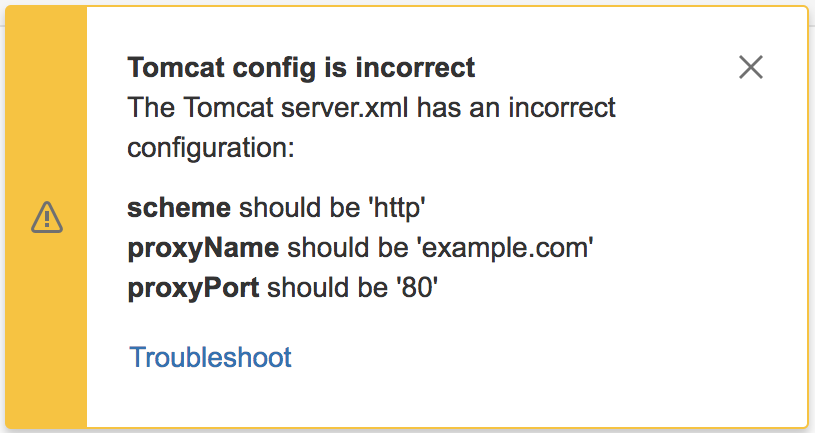

JIRA displays the following message to administrators:
Tomcat config is incorrect
The Tomcat server.xml has an incorrect configuration:
scheme should be '<recommended scheme>' proxyName should be '<recommended proxyName>' proxyPort should be '<recommended proxyPort>'

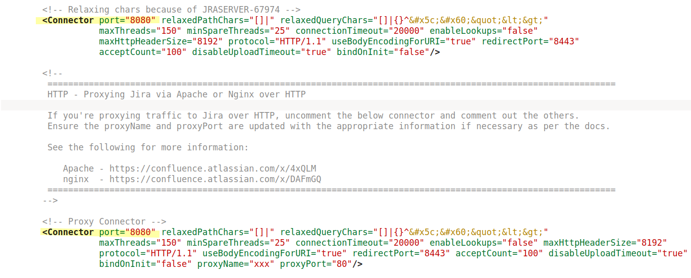

  • This message can appear also if there's an active duplicate connector in server.xml. I.e. it would appear like this:
    Notice the connector ports are the same which is incorrect

Cause 2
Either change the connector port on one the connectors, or comment out the redundant connector and restart Jira
