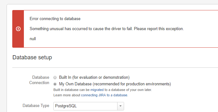

In Jira, when testing the database connection to PostgreSQL with SSL enabled, you may receive an error message:
Error connecting to database
The following appears in the catalina.log:
2018-05-27 15:25:48,747 http-nio-8080-exec-1 ERROR anonymous 925x38x1 92lmp6 10.53.222.101 /secure/SetupDatabase!connectionCheck.jspa [c.a.config.bootstrap.DefaultAtlassianBootstrapManager] Could not successfully test your database: org.postgresql.util.PSQLException: Something unusual has occurred to cause the driver to fail. Please report this exception. at org.postgresql.Driver.connect(Driver.java:275) at java.sql.DriverManager.getConnection(DriverManager.java:664) at java.sql.DriverManager.getConnection(DriverManager.java:247) at com.atlassian.config.bootstrap.DefaultAtlassianBootstrapManager.getTestDatabaseConnection(DefaultAtlassianBootstrapManager.java:347) at com.atlassian.jira.config.database.JdbcDatasource.getConnection(JdbcDatasource.java:211) at com.atlassian.jira.config.database.DatabaseConfig.testConnection(DatabaseConfig.java:87) at com.atlassian.jira.web.action.setup.SetupDatabase.testConnection(SetupDatabase.java:225) at com.atlassian.jira.web.action.setup.SetupDatabase.doValidation(SetupDatabase.java:189) at com.atlassian.jira.web.action.setup.SetupDatabase.doConnectionCheck(SetupDatabase.java:121) ... 3 filtered at java.lang.reflect.Method.invoke(Method.java:498) at webwork.util.InjectionUtils$DefaultInjectionImpl.invoke(InjectionUtils.java:70) at webwork.util.InjectionUtils.invoke(InjectionUtils.java:56) ... 2 filtered at com.atlassian.jira.action.JiraActionSupport.execute(JiraActionSupport.java:63) ... 7 filtered at javax.servlet.http.HttpServlet.service(HttpServlet.java:729) ... 49 filtered at com.atlassian.jira.security.JiraSecurityFilter.lambda$doFilter$2(JiraSecurityFilter.java:78) ... 1 filtered at com.atlassian.jira.security.JiraSecurityFilter.doFilter(JiraSecurityFilter.java:76) ... 28 filtered at com.atlassian.jira.servermetrics.CorrelationIdPopulatorFilter.doFilter(CorrelationIdPopulatorFilter.java:30) ... 27 filtered at com.atlassian.jira.servermetrics.MetricsCollectorFilter.doFilter(MetricsCollectorFilter.java:25) ... 26 filtered at java.util.concurrent.ThreadPoolExecutor.runWorker(ThreadPoolExecutor.java:1149) at java.util.concurrent.ThreadPoolExecutor$Worker.run(ThreadPoolExecutor.java:624) at org.apache.tomcat.util.threads.TaskThread$WrappingRunnable.run(TaskThread.java:61) at java.lang.Thread.run(Thread.java:748) Caused by: java.lang.NullPointerException at org.apache.log4j.CategoryKey.<init>(CategoryKey.java:32) at org.apache.log4j.Hierarchy.getLogger(Hierarchy.java:266) at org.apache.log4j.Hierarchy.getLogger(Hierarchy.java:247) at org.apache.log4j.LogManager.getLogger(LogManager.java:228) at org.apache.log4j.Logger.getLogger(Logger.java:104) at java.util.logging.Logger.log(Logger.java:738) at org.postgresql.core.v3.ConnectionFactoryImpl.log(ConnectionFactoryImpl.java:317) at org.postgresql.core.v3.ConnectionFactoryImpl.openConnectionImpl(ConnectionFactoryImpl.java:261) at org.postgresql.core.ConnectionFactory.openConnection(ConnectionFactory.java:49) at org.postgresql.jdbc.PgConnection.<init>(PgConnection.java:195) at org.postgresql.Driver.makeConnection(Driver.java:452) at org.postgresql.Driver.connect(Driver.java:254) ... 164 more
