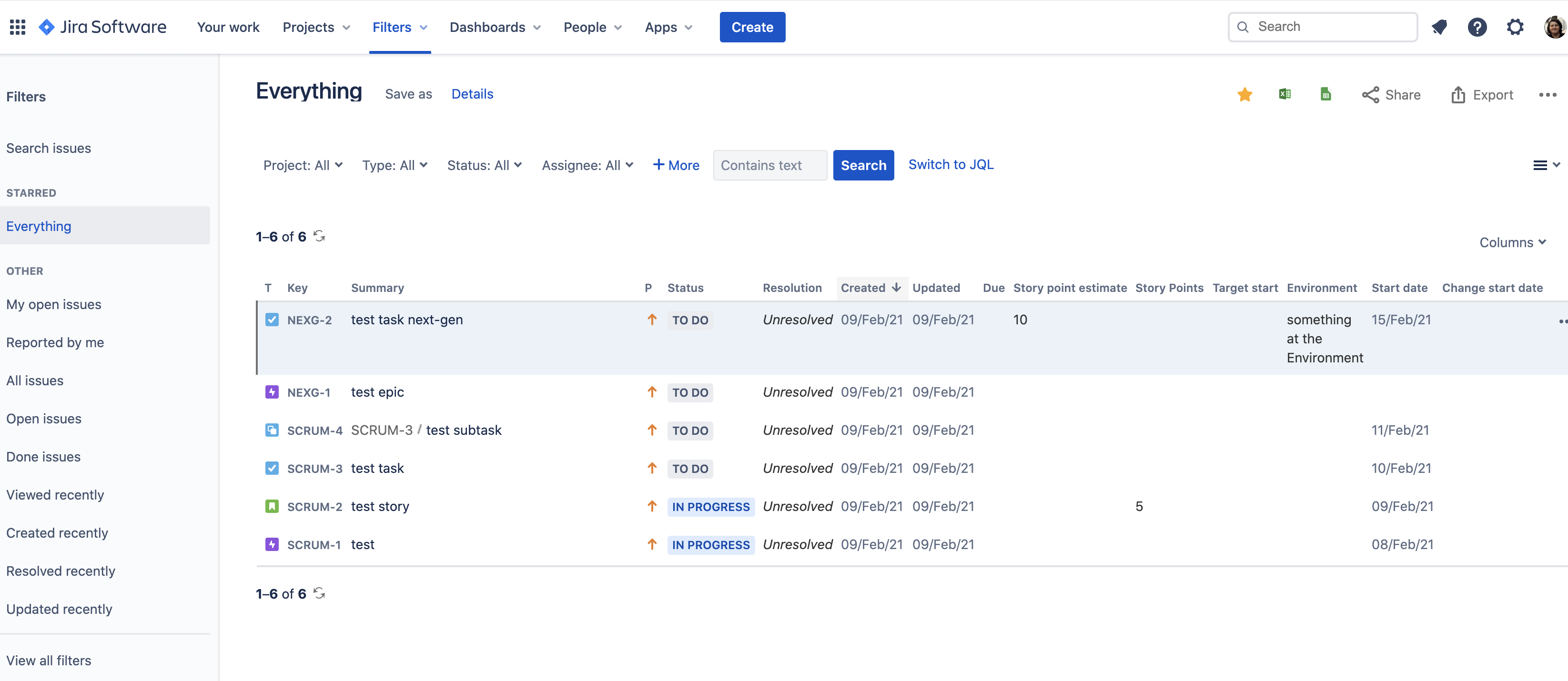

Jira Cloud:
* Custom Field "Environment" created as "Multiple Selection" and with the values "Cloud 1" and "Cloud 2";
* New Project Area of type Next-Gen created;
* We can observe that it does contain its own Environment field, but it is using a free format - We typed "something at the Environment"

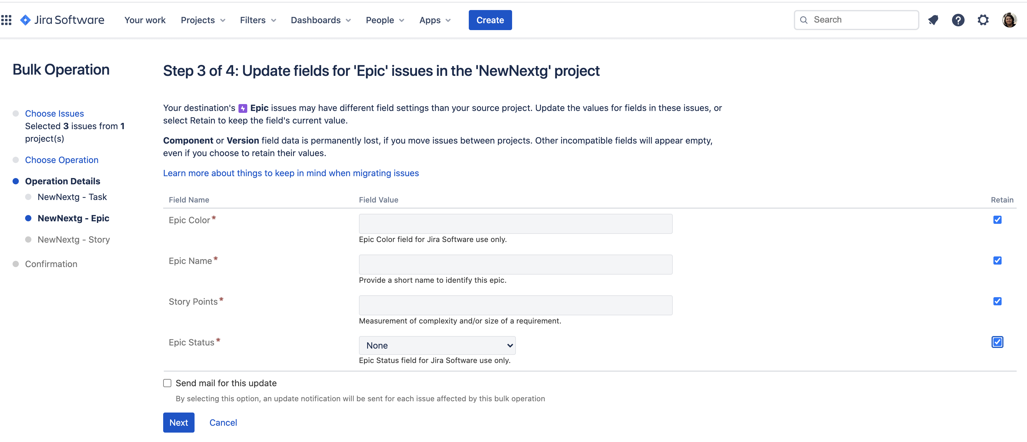

Migrating to Jira Server
  • Prior to creating the backup, it is required to migrate next-gen Projects to Classic;
  • As part of the migration, the wizard asks for some specific actions for some fields. The "Environment" was not listed:
  • The content of the Environment variable from the next-gen project was preserved during the migration to Classic
