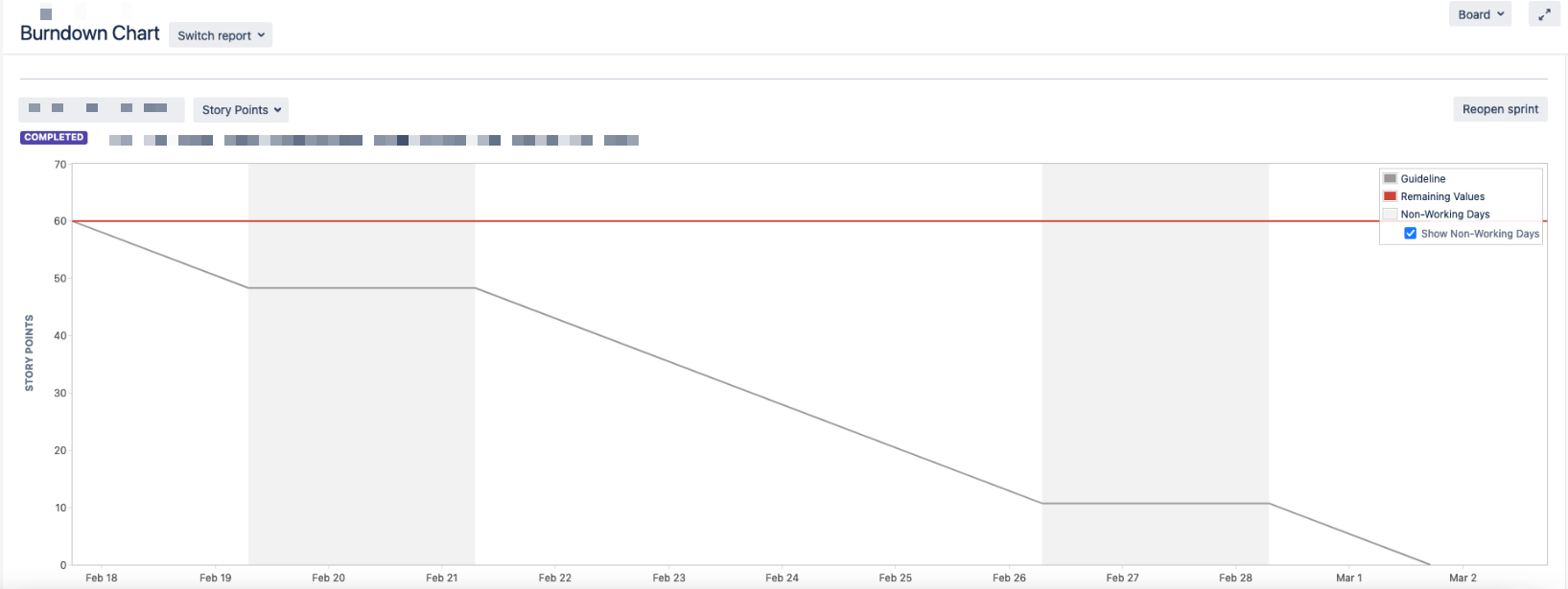

Jira reports (Sprint report , burndown chart..) might show incorrect curves when a ticket has a corrupt workflow transition. For instance, even though tickets were closed during the sprint, we can see that the remaining value doesn't drop.

  • Check if a ticket has the same transition for instance, we can check if a workflow is inserting 'Done' status as a source and destination transition which is an incorrect state
    SELECT * FROM CHANGEITEM WHERE FIELD='status' AND OLDSTRING='Done' AND NEWSTRING='Done';

  • There is an extra post-function in Done (or other) causing problem: Set issue status to the linked status of the destination workflow step causing Jira to insert erroneous data in the CHANGEITEM table.
