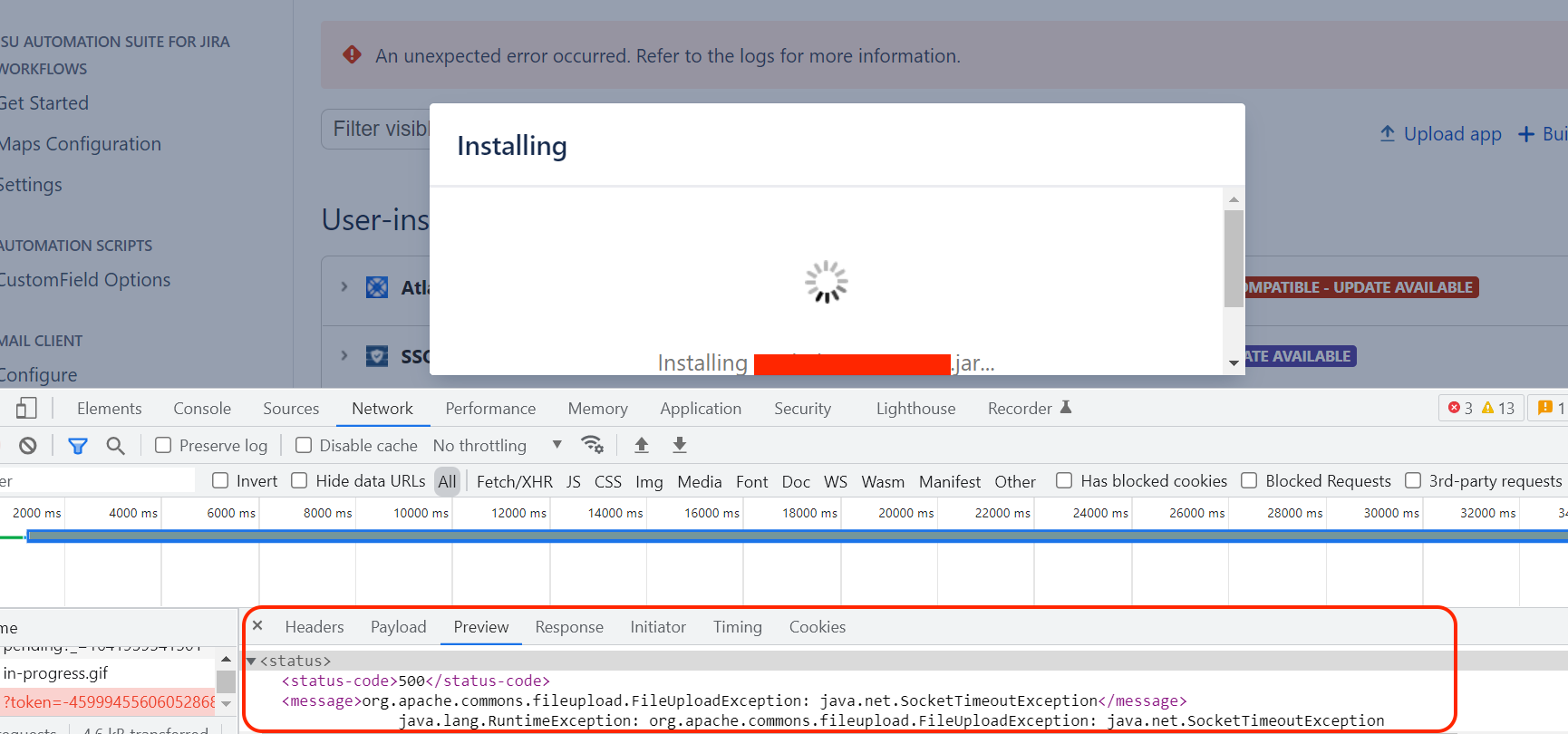

When trying to install an add-on *.jar file in Jira via the upload app button from the page ⚙ > Manage Apps > Manage Apps, the installation fails. Instead, a spinning wheel is shown in the UI, and a java.net.SocketTimeoutException error is thrown in the browser developer tool:

  • When collecting a HAR file while replicating the issue, we can see that a 500 HTTP code is returned from the POST request sent to <JIRA_BASE_URL>/rest/plugins/1.0/?token=-XXXXXXXXXXXXXX:
