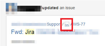

Any notification sent by JIRA for an issue with custom issue type will have the icon broken if that was defined to use a system avatar instead of a custom one.
The following error appears in the atlassian-jira.log everytime an e-mail notification is triggered
1 2 3 4 5 6 2015-07-30 17:12:42,234 atlassian-scheduler-quartz1.clustered_Worker-4 ERROR admin Support - Mails [atlassian.jira.avatar.AvatarManagerImpl] System Avatar not found at the following resource path: /avatars/medium_genericissue.png 2015-07-30 17:12:46,321 atlassian-scheduler-quartz1.clustered_Worker-4 WARN admin Support - Mails [jira.mail.util.MailAttachmentsManagerImpl] Cannot add avatar as Mail attachment for 'issue type: Issue' java.io.IOException: File not found at com.atlassian.jira.avatar.AvatarManagerImpl.processAvatarData(AvatarManagerImpl.java:379) at com.atlassian.jira.avatar.AvatarManagerImpl.readAvatarData(AvatarManagerImpl.java:492) ...
