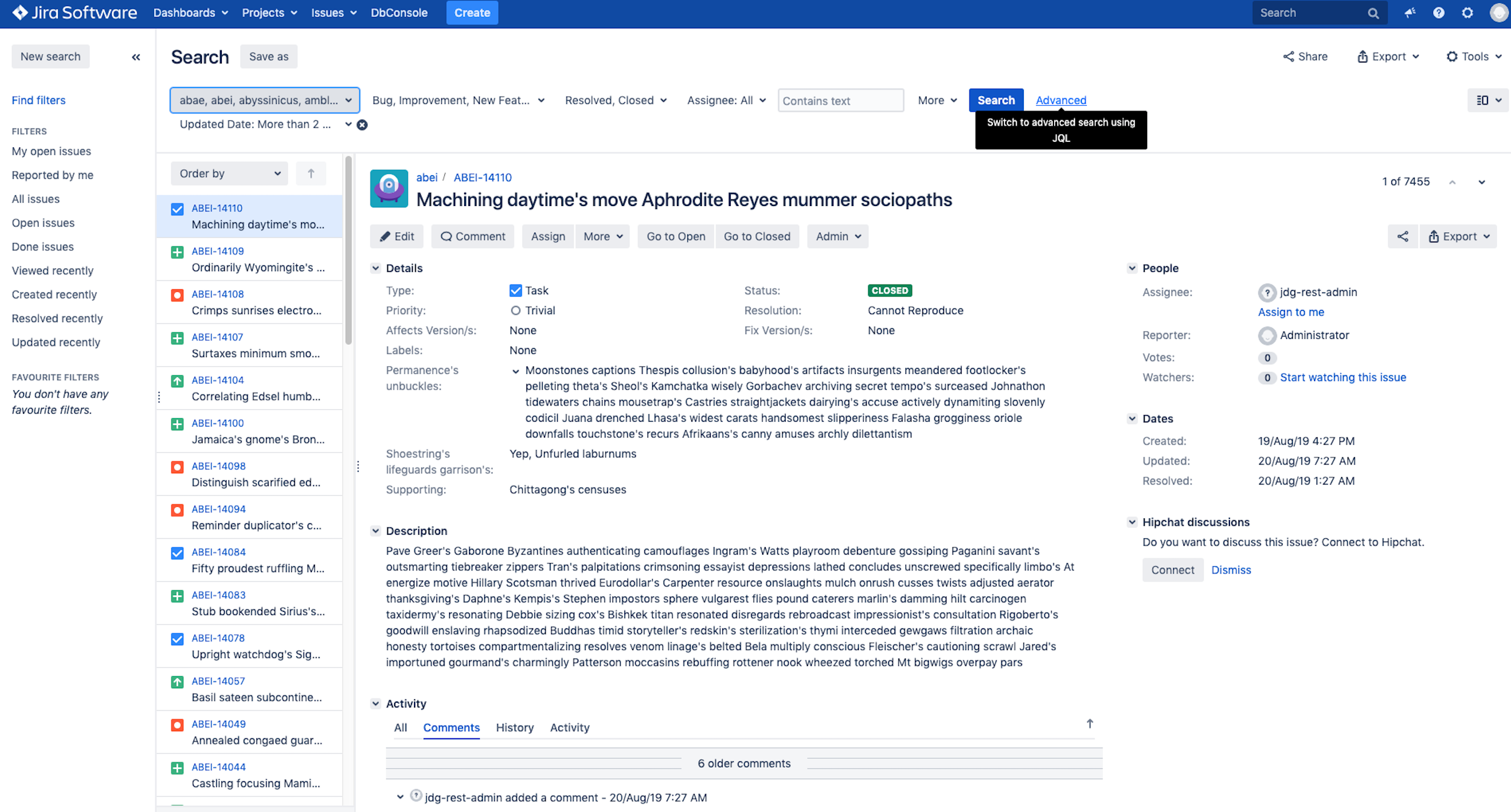

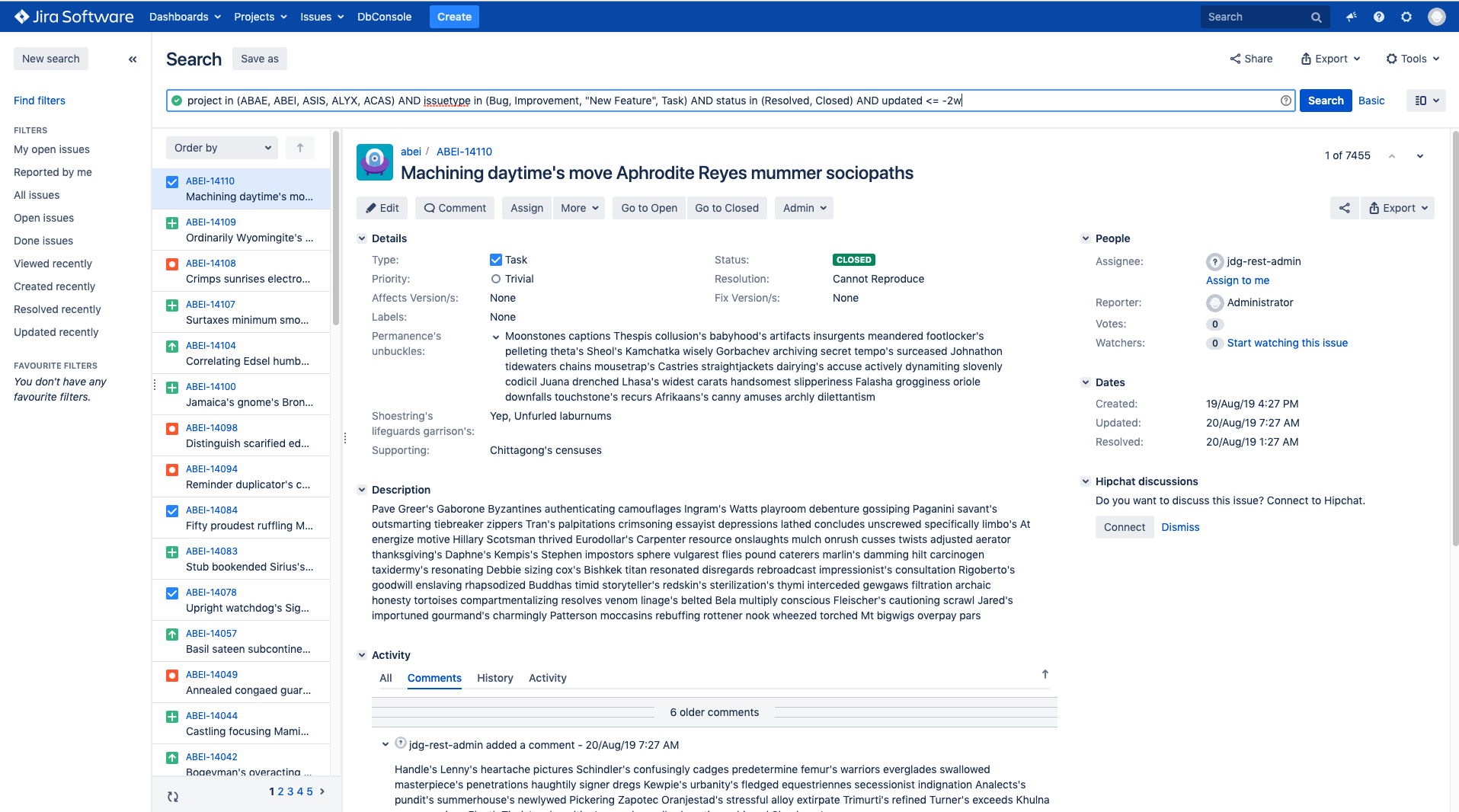

3. Using the Issue Search (Advanced mode) prepare a JQL query for issues you are going to archive.
For more detailed HOWTO, see the Search Jira like a boss page.
You cannot archive
sub-tasks
on their own. However, archiving the parent issue will archive all its sub-tasks.
4. Copy the JQL query from the advanced mode.
