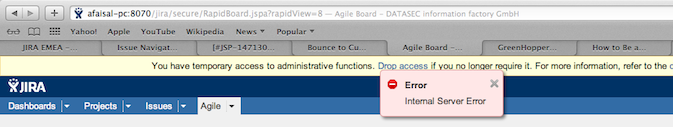

When accessing a GreenHopper board, instead of getting the board it returns an Internal Server Error, as per illustrated below:

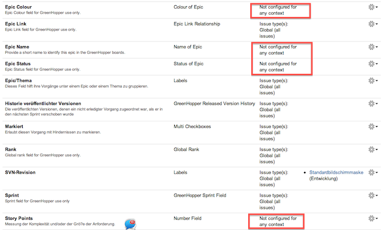

The problem may occur because some of GreenHopper custom fields do not have any Configuration Context configured. Please refer to the screenshot below:
Diagnostic steps
  • In our case here, we can see that the Epic Colour, Epic Name, Epic Status and Story Points field are missing their configuration context.
Resolution
  • In order to fix the problem, we need to recreate the fields default configuration context
  • Go to Administration > Custom Fields, and add the configuration context for all of the affected fields
