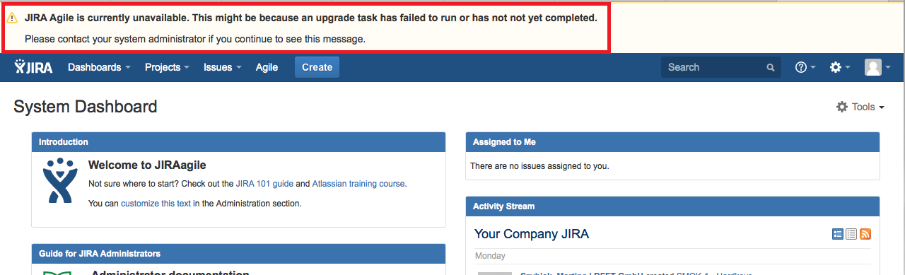

The following error message "JIRA Agile is currently unavailable. This might be because an upgrade task has failed to run or has not not yet completed" appears after installing JIRA Agile
