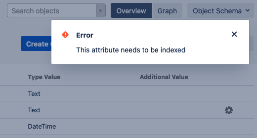

This attribute must be indexed
When attempting to edit the configuration of an Object-referencing attribute we see:

Both errors mentioned here may be caused by having an attribute that must be indexed, such as the 'Label' or an 'Object-Referencing' attribute, not being marked to be indexed by Insight.
Since this is not an operation that is permitted through the UI, this misconfiguration can be caused by an incomplete upgrade task by Insight, or direct database tampering.
Attributes that must be indexed
Although the 'Label' and an Object type attribute, are the main causes for the error messages above, there are other attributes that Insight expects to be indexed, and cannot be disabled through the UI, that we should also take note of if running into this scenario, those being:
  • The 4 fields that are created automatically for each object type (Key, Created, Updated & Label field).
  • Any attribute that references another object.
