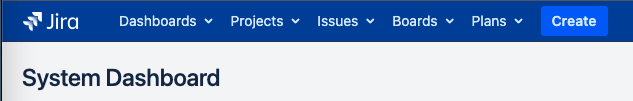

Summary
Although having Jira Service Management installed and licensed, suddenly the Insight top menu button disappears.
Attempts of accessing the app contents directly re-direct users to Jira's homepage.
