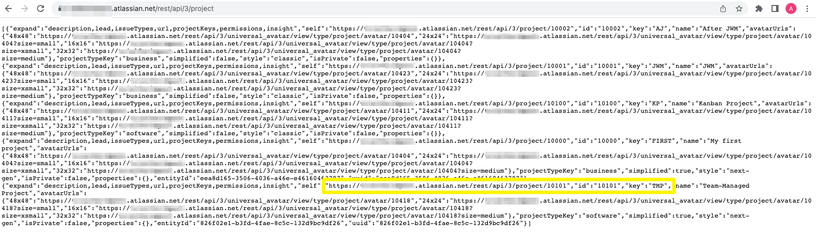

You need to start with locating your team-managed project's ID:
  1. Go to https://<instance name>.atlassian.net/rest/api/3/project
  2. Identify your project: you can use your browser(Ctrl+F / Cmnd+F) to search for Project key or Project name.
  3. The ID is located just before Project key. Example:
    • id":"10101","key":"TMP","name":"Team-Managed Project"

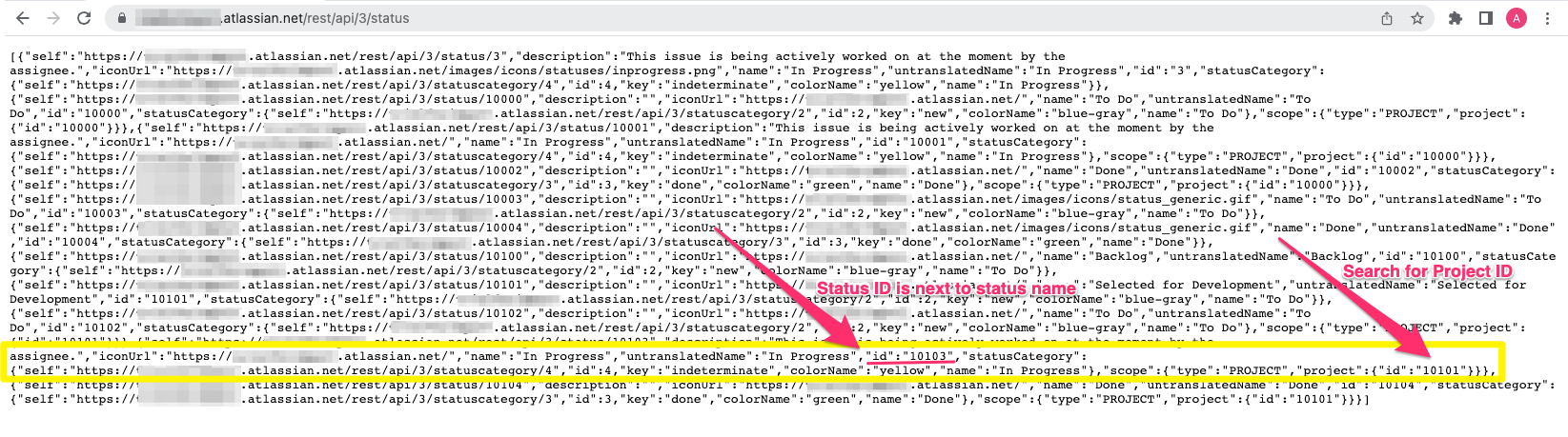

Then you need to get the status ID which corresponds the status in JQL query:
  1. Go to https://<instance name>.atlassian.net/rest/api/3/status
  2. Search for your Project ID. Statuses with their IDs will be listed next to it. These are usually five digits in length and should start with 10, 100 or similar (depending how many custom statuses are on your instance).
  3. Copy the relevant Status ID
Use obtained ID in your JQL query - eg. "Status was 10103".
