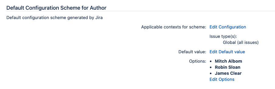

  • You have a Jira custom field of type Select List (single choice) called Author with the configuration as shown below. You would like another custom field called Book to show only books written by the selected author in the Jira custom field.

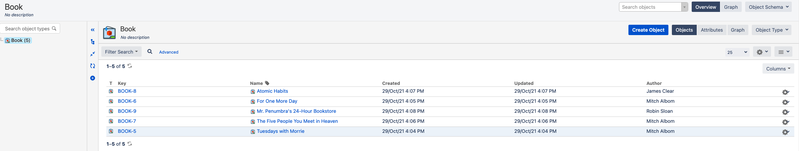

  • You have created an Insight object schema with an object type called Book, with books written by these authors as objects.

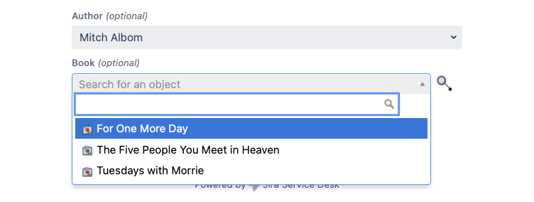

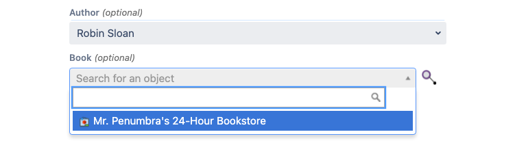

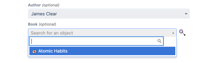

  4. Test it out on the Customer Portal or Jira's create issue screen. Example result:
