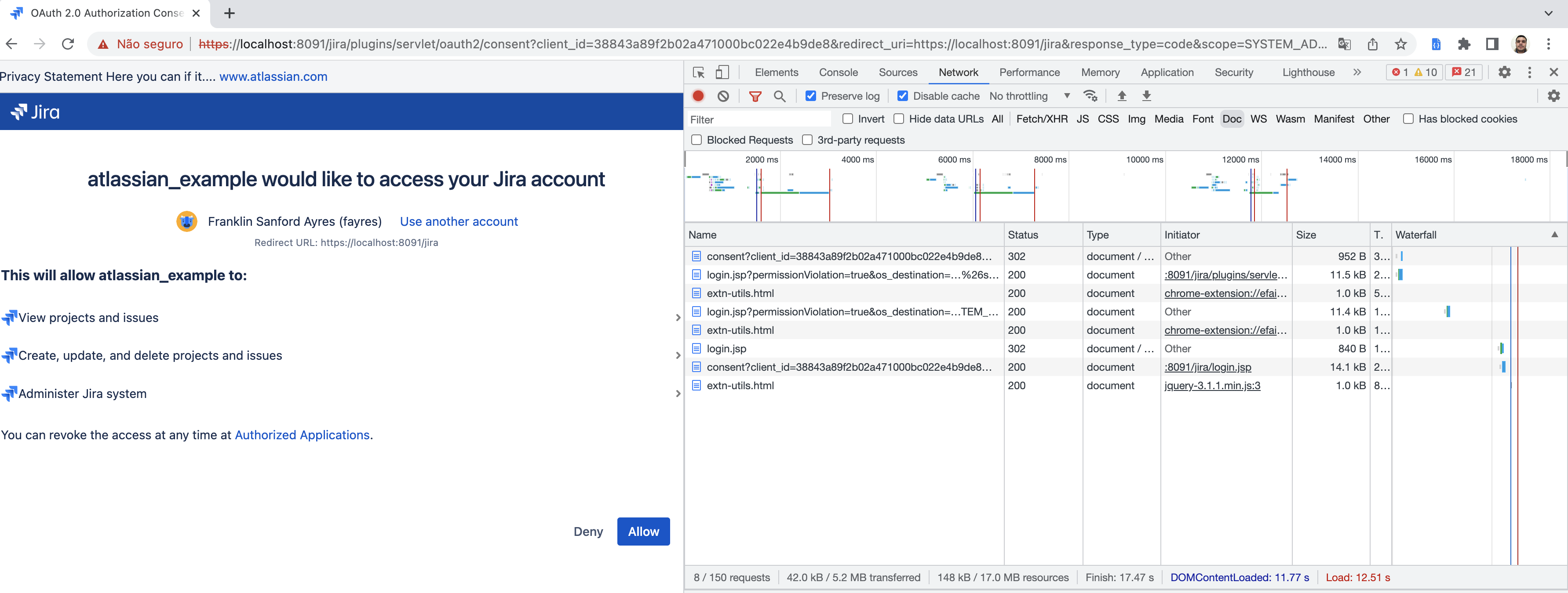

To allow the application
Paste the Jira URL to the browser with the developer tools opened in the network tab:
1

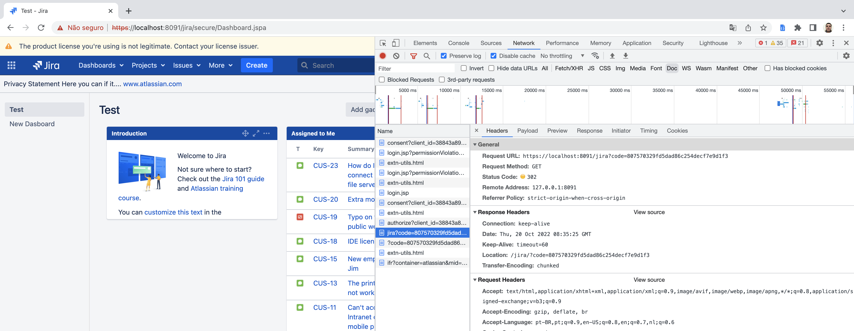

https://localhost:8091/jira/plugins/servlet/oauth2/consent?client_id=38843a89f2b02a471000bc022e4b9de8&redirect_uri=https://localhost:8091/jira&response_type=code&scope=SYSTEM_ADMIN
In the developer tools search for the code parameter just after the redirect URI like https://localhost:8091/jira/?code=807570329fd5dad86c254decf7e9d1f3

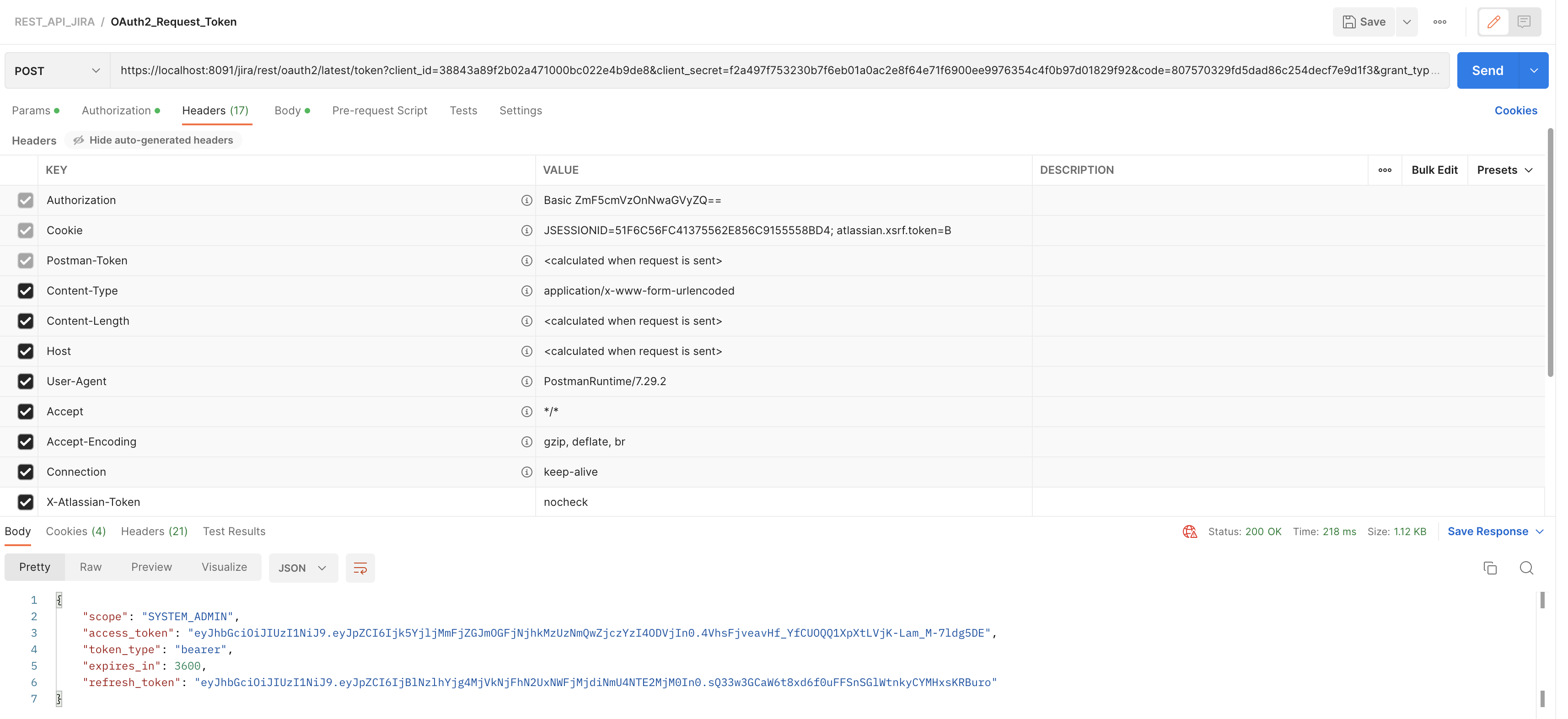

With the code you can use Postman to make a call to get the token for that you need to POST for example to:
1
https://localhost:8091/jira/rest/oauth2/latest/token?client_id=38843a89f2b02a471000bc022e4b9de8&client_secret=f2a497f753230b7f6eb01a0ac2e8f64e71f6900ee9976354c4f0b97d01829f92&code=807570329fd5dad86c254decf7e9d1f3&grant_type=authorization_code&redirect_uri=https://localhost:8091/jira
ℹ️ Make sure to add the header "Content-Type: application/x-www-form-urlencoded" to this request.
It will give a response like this:
1 2 3 4 5 6 7
{ "scope": "SYSTEM_ADMIN", "access_token": "eyJhbGciOiJIUzI1NiJ9.eyJpZCI6Ijk5YjljMmFjZGJmOGFjNjhkMzUzNmQwZjczYzI4ODVjIn0.4VhsFjveavHf_YfCUOQQ1XpXtLVjK-Lam_M-7ldg5DE", "token_type": "bearer", "expires_in": 3600, "refresh_token": "eyJhbGciOiJIUzI1NiJ9.eyJpZCI6IjBlNzlhYjg4MjVkNjFhN2UxNWFjMjdiNmU4NTE2MjM0In0.sQ33w3GCaW6t8xd6f0uFFSnSGlWtnkyCYMHxsKRBuro" }

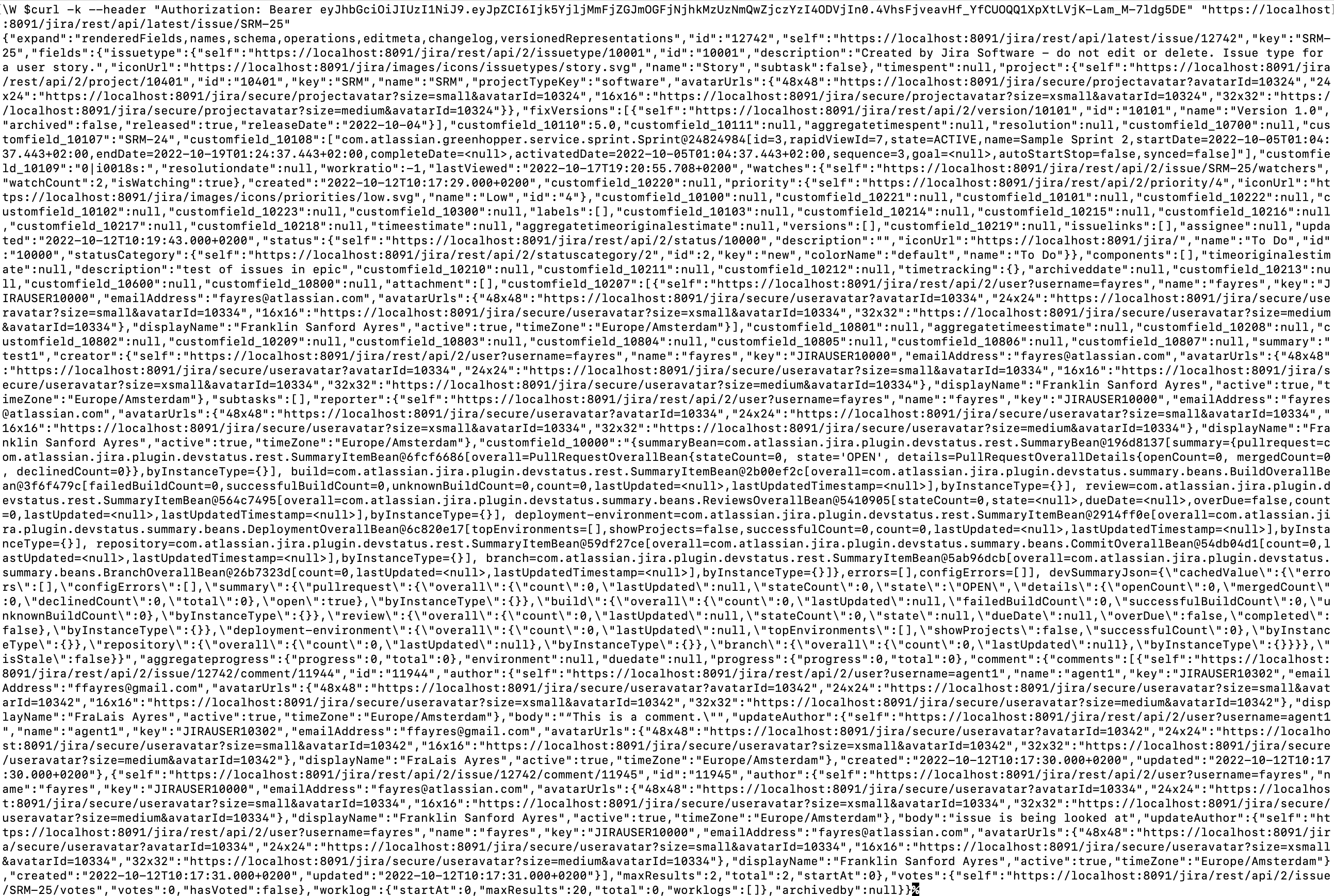

Use the access_token to call an issue in Jira for example using cURL:
1
curl -k --header "Authorization: Bearer eyJhbGciOiJIUzI1NiJ9.eyJpZCI6Ijk5YjljMmFjZGJmOGFjNjhkMzUzNmQwZjczYzI4ODVjIn0.4VhsFjveavHf_YfCUOQQ1XpXtLVjK-Lam_M-7ldg5DE" "https://localhost:8091/jira/rest/api/latest/issue/SRM-25"
It will give you the information from the issue like:
1
{"expand":"renderedFields,names,schema,operations,editmeta,changelog,versionedRepresentations","id":"12742","self":"https://localhost:8091/jira/rest/api/latest/issue/12742","key":"SRM-25","fields":{"issuetype":{"self":"https://localhost:8091/jira/rest/api/2/issuetype/10001","id":"10001","description":"Created by Jira Software - do not edit or delete. Issue type for a user story.","iconUrl":"https://localhost:8091/jira/images/icons/issuetypes/story.svg","name":"Story","subtask":false},"timespent":null,"project":{"self":"https://localhost:8091/jira/rest/api/2/project/10401","id":"10401","key":"SRM","name":"SRM","projectTypeKey":"software","avatarUrls":{"48x48":"https://localhost:8091/jira/secure/projectavatar?avatarId=10324","24x24":"https://localhost:8091/jira/secure/projectavatar?size=small&avatarId=10324","16x16":"https://localhost:8091/jira/secure/projectavatar?size=xsmall&avatarId=10324","32x32":"https://localhost:8091/jira/secure/projectavatar?size=medium&avatarId=10324"}},"fixVersions":[{"self":"https://localhost:8091/jira/rest/api/2/version/10101","id":"10101","name":"Version 1.0","archived":false,"released":true,"releaseDate":"2022-10-04"}],"customfield_10110":5.0,"customfield_10111":null,"aggregatetimespent":null,"resolution":null,"customfield_10700":null,"customfield_10107":"SRM-24","customfield_10108":["com.atlassian.greenhopper.service.sprint.Sprint@3979acde[id=3,rapidViewId=7,state=ACTIVE,name=Sample Sprint 2,startDate=2022-10-05T01:04:37.443+02:00,endDate=2022-10-19T01:24:37.443+02:00,completeDate=<null>,activatedDate=2022-10-05T01:04:37.443+02:00,sequence=3,goal=<null>,autoStartStop=false,synced=false]"],"customfield_10109":"0|i0018s:","resolutiondate":null,"workratio":-1,"lastViewed":"2022-10-17T19:20:55.708+0200","watches":{"self":"https://localhost:8091/jira/rest/api/2/issue/SRM-25/watchers","watchCount":2,"isWatching":true},"created":"2022-10-12T10:17:29.000+0200","customfield_10220":null,"priority":{"self":"https://localhost:8091/jira/rest/api/2/priority/4","iconUrl":"https://localhost:8091/jira/images/icons/priorities/low.svg","name":"Low","id":"4"},"customfield_10100":null,"customfield_10221":null,"customfield_10101":null,"customfield_10222":null,"customfield_10102":null,"customfield_10223":null,"customfield_10300":null,"labels":[],"customfield_10103":null,"customfield_10214":null,"customfield_10215":null,"customfield_10216":null,"customfield_10217":null,"customfield_10218":null,"timeestimate":null,"aggregatetimeoriginalestimate":null,"versions":[],"customfield_10219":null,"issuelinks":[],"assignee":null,"updated":"2022-10-12T10:19:43.000+0200","status":{"self":"https://localhost:8091/jira/rest/api/2/status/10000","description":"","iconUrl":"https://localhost:8091/jira/","name":"To Do","id":"10000","statusCategory":{"self":"https://localhost:8091/jira/rest/api/2/statuscategory/2","id":2,"key":"new","colorName":"default","name":"To Do"}},"components":[],"timeoriginalestimate":null,"description":"test of issues in epic","customfield_10210":null,"customfield_10211":null,"customfield_10212":null,"timetracking":{},"archiveddate":null,"customfield_10213":null,"customfield_10600":null,"customfield_10800":null,"attachment":[],"customfield_10207":[{"self":"https://localhost:8091/jira/rest/api/2/user?username=fayres","name":"fayres","key":"JIRAUSER10000","emailAddress":"fayres@atlassian.com","avatarUrls":{"48x48":"https://localhost:8091/jira/secure/useravatar?avatarId=10334","24x24":"https://localhost:8091/jira/secure/useravatar?size=small&avatarId=10334","16x16":"https://localhost:8091/jira/secure/useravatar?size=xsmall&avatarId=10334","32x32":"https://localhost:8091/jira/secure/useravatar?size=medium&avatarId=10334"},"displayName":"Franklin Sanford Ayres","active":true,"timeZone":"Europe/Amsterdam"}],"customfield_10801":null,"aggregatetimeestimate":null,"customfield_10208":null,"customfield_10802":null,"customfield_10209":null,"customfield_10803":null,"customfield_10804":null,"customfield_10805":null,"customfield_10806":null,"customfield_10807":null,"summary":"test1","creator":{"self":"https://localhost:8091/jira/rest/api/2/user?username=fayres","name":"fayres","key":"JIRAUSER10000","emailAddress":"fayres@atlassian.com","avatarUrls":{"48x48":"https://localhost:8091/jira/secure/useravatar?avatarId=10334","24x24":"https://localhost:8091/jira/secure/useravatar?size=small&avatarId=10334","16x16":"https://localhost:8091/jira/secure/useravatar?size=xsmall&avatarId=10334","32x32":"https://localhost:8091/jira/secure/useravatar?size=medium&avatarId=10334"},"displayName":"Franklin Sanford Ayres","active":true,"timeZone":"Europe/Amsterdam"},"subtasks":[],"reporter":{"self":"https://localhost:8091/jira/rest/api/2/user?username=fayres","name":"fayres","key":"JIRAUSER10000","emailAddress":"fayres@atlassian.com","avatarUrls":{"48x48":"https://localhost:8091/jira/secure/useravatar?avatarId=10334","24x24":"https://localhost:8091/jira/secure/useravatar?size=small&avatarId=10334","16x16":"https://localhost:8091/jira/secure/useravatar?size=xsmall&avatarId=10334","32x32":"https://localhost:8091/jira/secure/useravatar?size=medium&avatarId=10334"},"displayName":"Franklin Sanford Ayres","active":true,"timeZone":"Europe/Amsterdam"},"customfield_10000":"{summaryBean=com.atlassian.jira.plugin.devstatus.rest.SummaryBean@69d1a9e6[summary={pullrequest=com.atlassian.jira.plugin.devstatus.rest.SummaryItemBean@1ba4e34e[overall=PullRequestOverallBean{stateCount=0, state='OPEN', details=PullRequestOverallDetails{openCount=0, mergedCount=0, declinedCount=0}},byInstanceType={}], build=com.atlassian.jira.plugin.devstatus.rest.SummaryItemBean@7939f10f[overall=com.atlassian.jira.plugin.devstatus.summary.beans.BuildOverallBean@45bbd3f5[failedBuildCount=0,successfulBuildCount=0,unknownBuildCount=0,count=0,lastUpdated=<null>,lastUpdatedTimestamp=<null>],byInstanceType={}], review=com.atlassian.jira.plugin.devstatus.rest.SummaryItemBean@37c49dd4[overall=com.atlassian.jira.plugin.devstatus.summary.beans.ReviewsOverallBean@352bd3d1[stateCount=0,state=<null>,dueDate=<null>,overDue=false,count=0,lastUpdated=<null>,lastUpdatedTimestamp=<null>],byInstanceType={}], deployment-environment=com.atlassian.jira.plugin.devstatus.rest.SummaryItemBean@32cfdf2[overall=com.atlassian.jira.plugin.devstatus.summary.beans.DeploymentOverallBean@1893a219[topEnvironments=[],showProjects=false,successfulCount=0,count=0,lastUpdated=<null>,lastUpdatedTimestamp=<null>],byInstanceType={}], repository=com.atlassian.jira.plugin.devstatus.rest.SummaryItemBean@baaa6e2[overall=com.atlassian.jira.plugin.devstatus.summary.beans.CommitOverallBean@60f4591d[count=0,lastUpdated=<null>,lastUpdatedTimestamp=<null>],byInstanceType={}], branch=com.atlassian.jira.plugin.devstatus.rest.SummaryItemBean@453fb9c[overall=com.atlassian.jira.plugin.devstatus.summary.beans.BranchOverallBean@1d51265[count=0,lastUpdated=<null>,lastUpdatedTimestamp=<null>],byInstanceType={}]},errors=[],configErrors=[]], devSummaryJson={\"cachedValue\":{\"errors\":[],\"configErrors\":[],\"summary\":{\"pullrequest\":{\"overall\":{\"count\":0,\"lastUpdated\":null,\"stateCount\":0,\"state\":\"OPEN\",\"details\":{\"openCount\":0,\"mergedCount\":0,\"declinedCount\":0,\"total\":0},\"open\":true},\"byInstanceType\":{}},\"build\":{\"overall\":{\"count\":0,\"lastUpdated\":null,\"failedBuildCount\":0,\"successfulBuildCount\":0,\"unknownBuildCount\":0},\"byInstanceType\":{}},\"review\":{\"overall\":{\"count\":0,\"lastUpdated\":null,\"stateCount\":0,\"state\":null,\"dueDate\":null,\"overDue\":false,\"completed\":false},\"byInstanceType\":{}},\"deployment-environment\":{\"overall\":{\"count\":0,\"lastUpdated\":null,\"topEnvironments\":[],\"showProjects\":false,\"successfulCount\":0},\"byInstanceType\":{}},\"repository\":{\"overall\":{\"count\":0,\"lastUpdated\":null},\"byInstanceType\":{}},\"branch\":{\"overall\":{\"count\":0,\"lastUpdated\":null},\"byInstanceType\":{}}}},\"isStale\":false}}","aggregateprogress":{"progress":0,"total":0},"environment":null,"duedate":null,"progress":{"progress":0,"total":0},"comment":{"comments":[{"self":"https://localhost:8091/jira/rest/api/2/issue/12742/comment/11944","id":"11944","author":{"self":"https://localhost:8091/jira/rest/api/2/user?username=agent1","name":"agent1","key":"JIRAUSER10302","emailAddress":"ffayres@gmail.com","avatarUrls":{"48x48":"https://localhost:8091/jira/secure/useravatar?avatarId=10342","24x24":"https://localhost:8091/jira/secure/useravatar?size=small&avatarId=10342","16x16":"https://localhost:8091/jira/secure/useravatar?size=xsmall&avatarId=10342","32x32":"https://localhost:8091/jira/secure/useravatar?size=medium&avatarId=10342"},"displayName":"FraLais Ayres","active":true,"timeZone":"Europe/Amsterdam"},"body":"“This is a comment.\"","updateAuthor":{"self":"https://localhost:8091/jira/rest/api/2/user?username=agent1","name":"agent1","key":"JIRAUSER10302","emailAddress":"ffayres@gmail.com","avatarUrls":{"48x48":"https://localhost:8091/jira/secure/useravatar?avatarId=10342","24x24":"https://localhost:8091/jira/secure/useravatar?size=small&avatarId=10342","16x16":"https://localhost:8091/jira/secure/useravatar?size=xsmall&avatarId=10342","32x32":"https://localhost:8091/jira/secure/useravatar?size=medium&avatarId=10342"},"displayName":"FraLais Ayres","active":true,"timeZone":"Europe/Amsterdam"},"created":"2022-10-12T10:17:30.000+0200","updated":"2022-10-12T10:17:30.000+0200"},{"self":"https://localhost:8091/jira/rest/api/2/issue/12742/comment/11945","id":"11945","author":{"self":"https://localhost:8091/jira/rest/api/2/user?username=fayres","name":"fayres","key":"JIRAUSER10000","emailAddress":"fayres@atlassian.com","avatarUrls":{"48x48":"https://localhost:8091/jira/secure/useravatar?avatarId=10334","24x24":"https://localhost:8091/jira/secure/useravatar?size=small&avatarId=10334","16x16":"https://localhost:8091/jira/secure/useravatar?size=xsmall&avatarId=10334","32x32":"https://localhost:8091/jira/secure/useravatar?size=medium&avatarId=10334"},"displayName":"Franklin Sanford Ayres","active":true,"timeZone":"Europe/Amsterdam"},"body":"issue is being looked at","updateAuthor":{"self":"https://localhost:8091/jira/rest/api/2/user?username=fayres","name":"fayres","key":"JIRAUSER10000","emailAddress":"fayres@atlassian.com","avatarUrls":{"48x48":"https://localhost:8091/jira/secure/useravatar?avatarId=10334","24x24":"https://localhost:8091/jira/secure/useravatar?size=small&avatarId=10334","16x16":"https://localhost:8091/jira/secure/useravatar?size=xsmall&avatarId=10334","32x32":"https://localhost:8091/jira/secure/useravatar?size=medium&avatarId=10334"},"displayName":"Franklin Sanford Ayres","active":true,"timeZone":"Europe/Amsterdam"},"created":"2022-10-12T10:17:31.000+0200","updated":"2022-10-12T10:17:31.000+0200"}],"maxResults":2,"total":2,"startAt":0},"votes":{"self":"https://localhost:8091/jira/rest/api/2/issue/SRM-25/votes","votes":0,"hasVoted":false},"worklog":{"startAt":0,"maxResults":20,"total":0,"worklogs":[]},"archivedby":null}}
