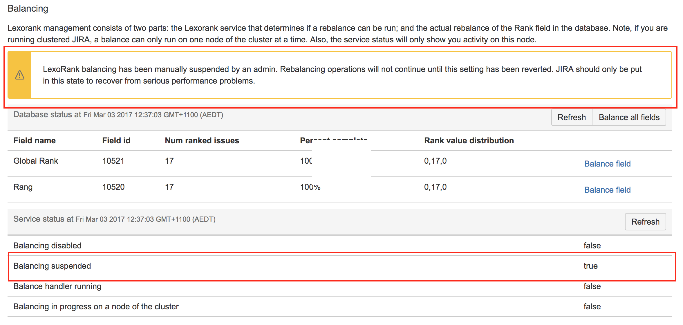

  • Once Lexoranking is disabled, the 'Lexorank Management UI' will display the following warning :
  • To re-enable rebalancing, use this call (to be performed during off peak hours when the instance is stable)
    curl -X PUT -H "Content-Type: application/json" -d "{\"suspendBalancing\":\"false\"}" -u <Admin User> <Base Url>/rest/greenhopper/1.0/lexorank/balance
