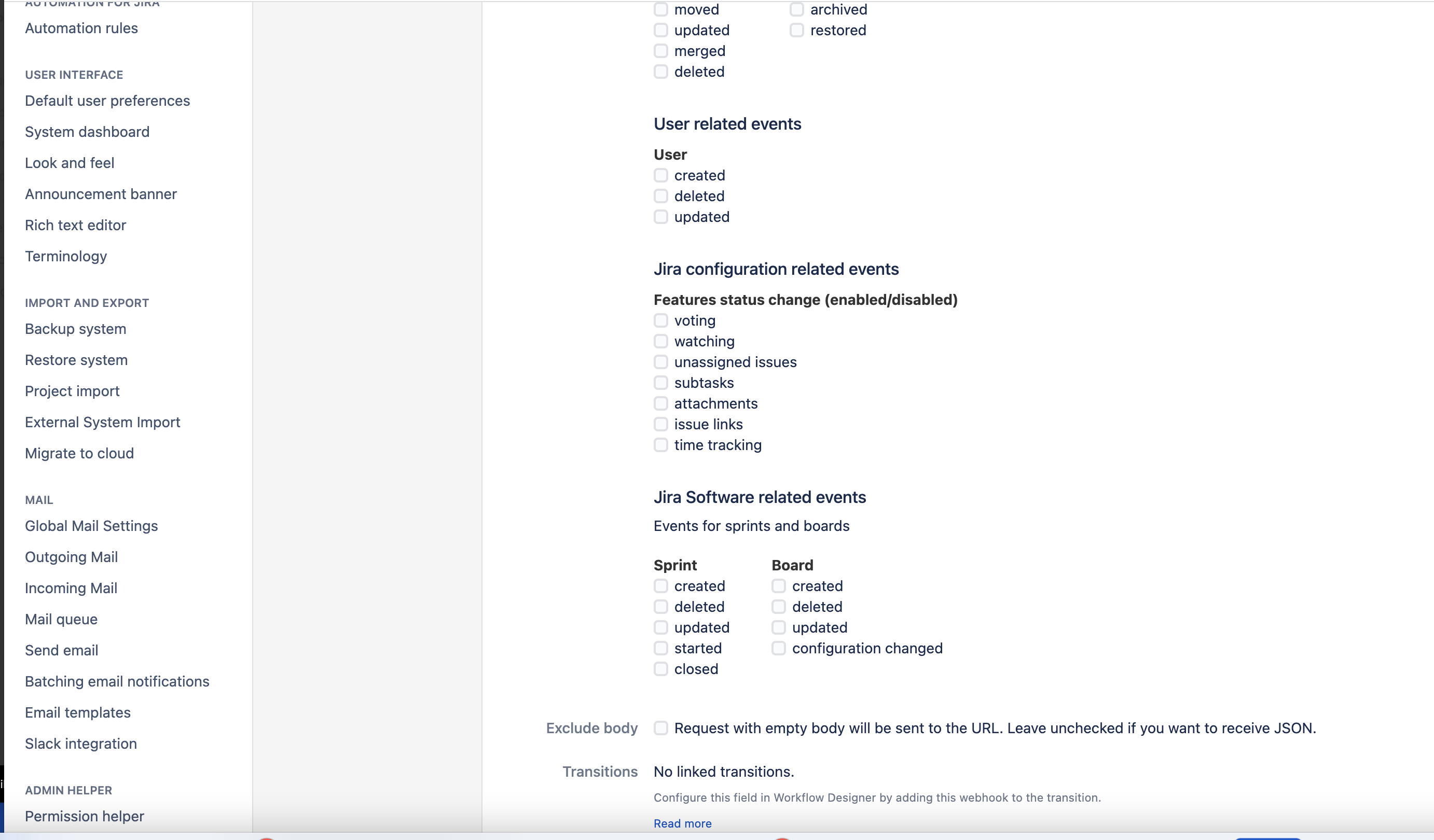

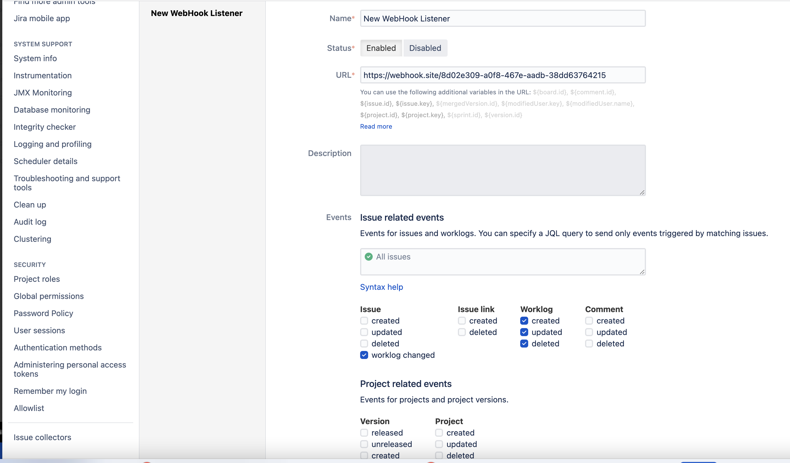

2. Configure Jira webhook to capture worklog actions - create, update, delete and send a hook. You can use a free web hook server for the test, like https://webhook.site/.

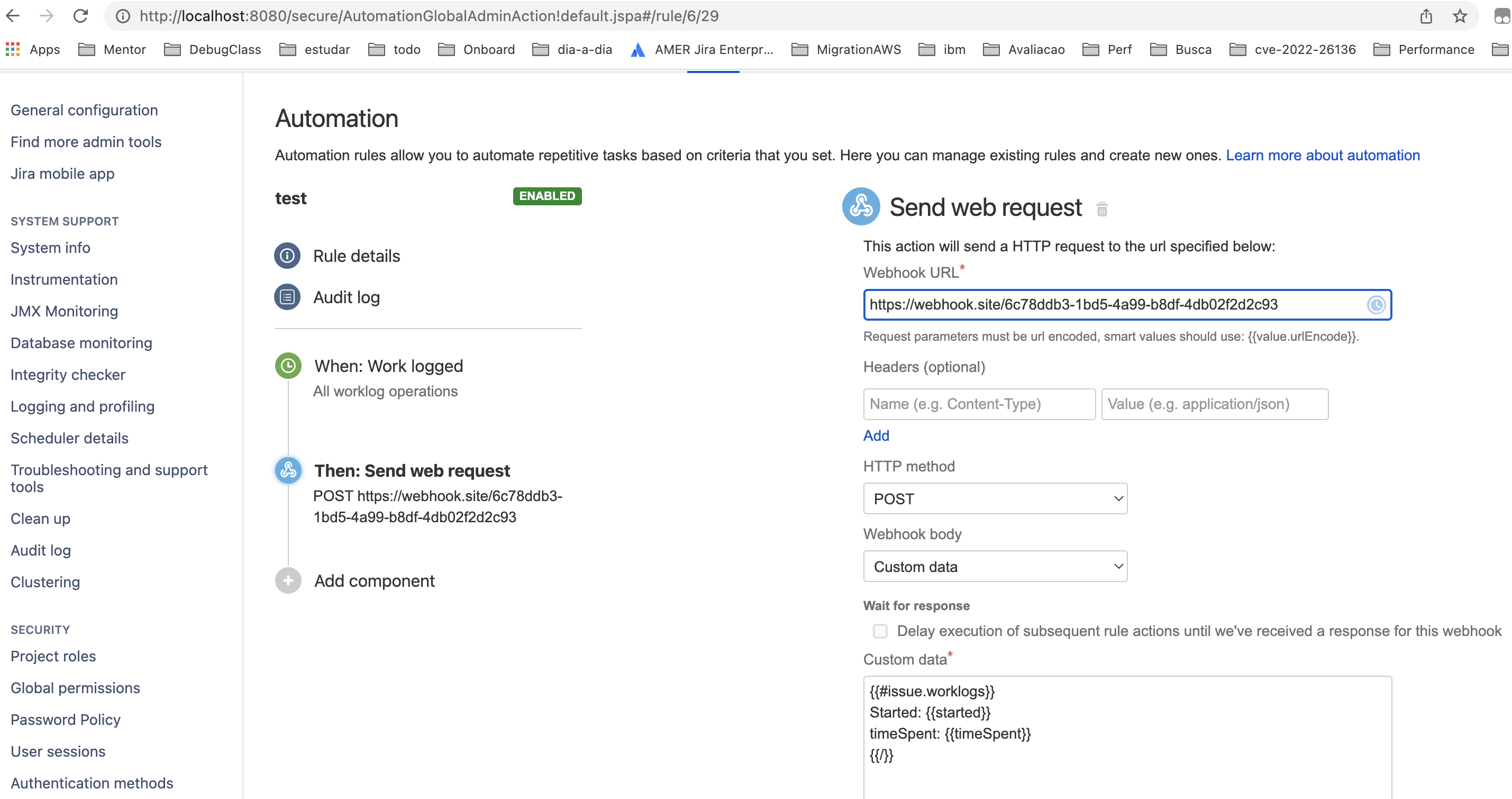

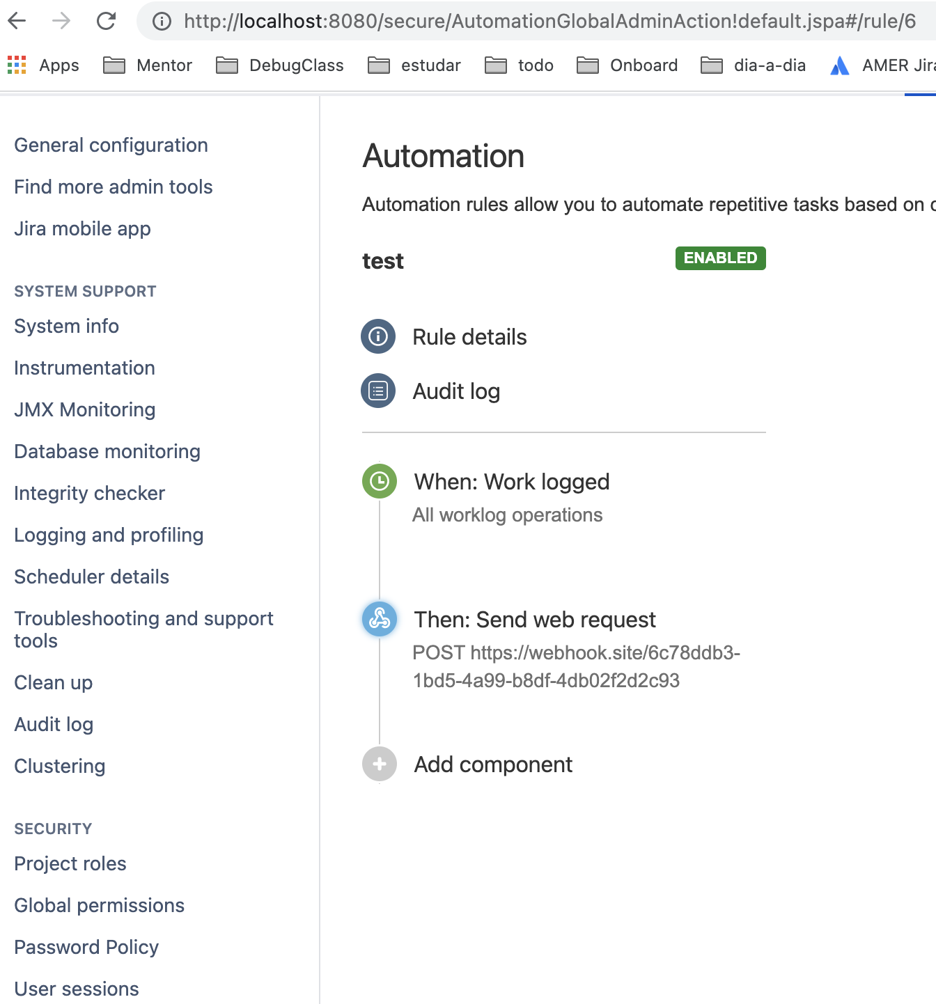

2. Create an Automation Rule to be triggered when a worklog event happens.
Sample of a JSON payload:
{{#issue.worklogs}} "self":{{self}}, "author":{ "self":{{author.self}}, "name":{{author.name}}, "key":{{author.key}}, "emailAddress":{{author.emailAddress}}, "displayName":{{author.displayName}}, "active":{{author.active}}, "timeZone":{{author.timeZone}}, "updateAuthor":{ "self":{{updateAuthor.self}}, "name":{{updateAuthor.name}}, "key":{{updateAuthor.key}}, "emailAddress":{{updateAuthor.emailAddress}}, "displayName":{{updateAuthor.displayName}}, "active":{{updateAuthor.active}}, "timeZone":{{updateAuthor.timeZone}}, "comment":{{comment}}, "created":{{created}}, "updated":{{updated}}, "started":{{started}}, "timeSpent":{{timeSpent}}, "timeSpentSeconds":{{timeSpentSeconds}}, "id":{{id}}, "issueId":{{issueId}} {{/}}

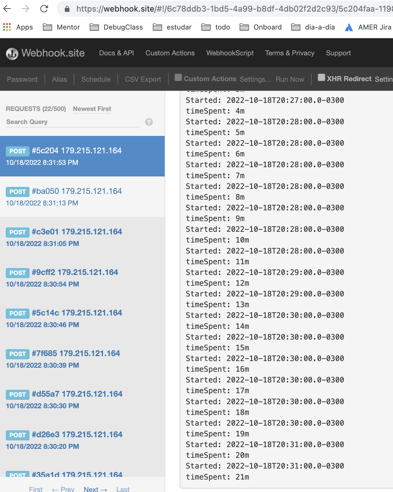

4. Observe the content received on the Webhook server, all worklog entries were received:
