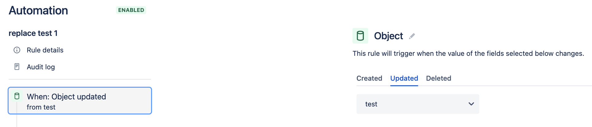

First, we need to fetch the Assets object data in the automation rule. This can be done with the help of 'Object' trigger and specifying the Asset object schema details. More about object triggers can be found here - Object trigger.
Assets related automation rules that involve
Object Trigger
should be created from the Global Automation page

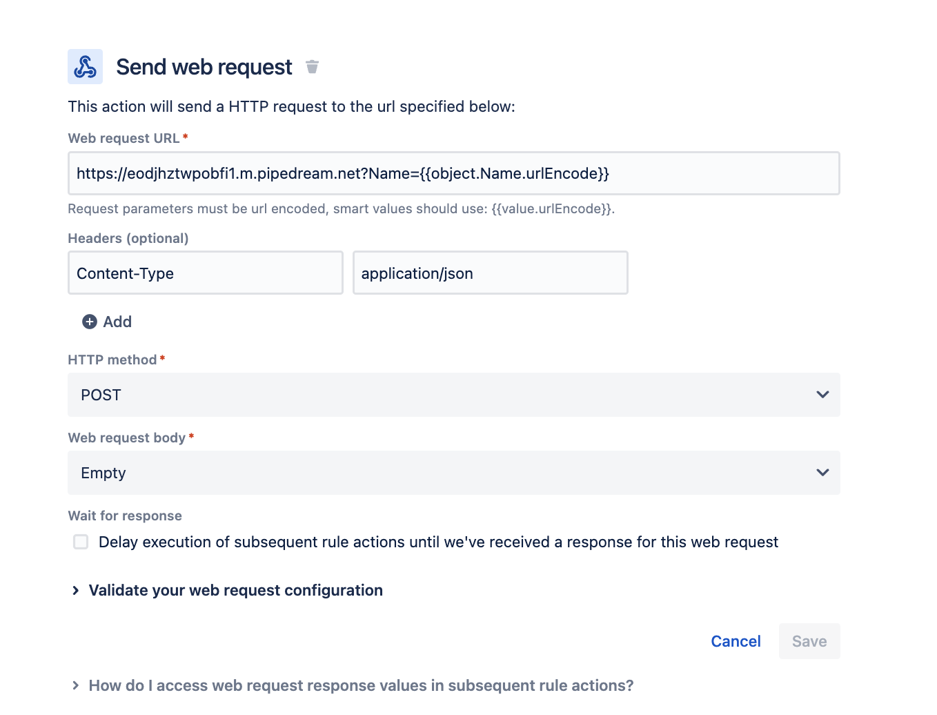

1- By passing the parameters directly in the url: In this method the Asset object values are added directly to the webhook url.

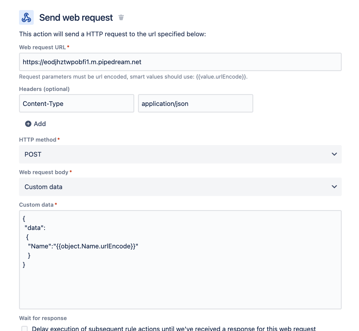

2- By adding the parameters as custom data: In this method the Asset object data is added as the request body through custom data.

ℹ️ In both scenarios, notice the use of {{object.Name.urlEncode}} for encoding the blank space and special characters in the url. This will heavily depend on what the receiving service expects the data to be formatted as. For example, .asJsonString may be more appropriate in the latter example. You can read more about the JSON Functions here: Jira Smart Values - JSON Functions.
