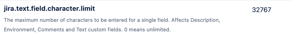

This error might be noticed during the issue clone process when a System or Custom Field is higher than defined on jira.text.field.character.limit
  • Administration( ⚙ ) >System > General Configuration > Advanced Settings > jira.text.field.character.limit

The Validation is on any System or Custom text field character limit and by default, the limit is '32767'.
Solution
1 - Check the value for jira.text.field.character.limit. Go to Administration ( ⚙ ) > System > General Configuration > Advanced Settings > jira.text.field.character.limit
