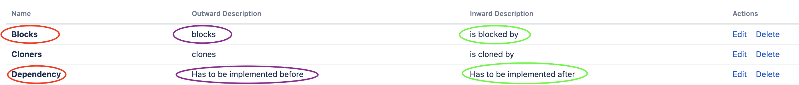

This is the easy scenario. For instance, you have two link types called Blocks and Dependency configured as follows:

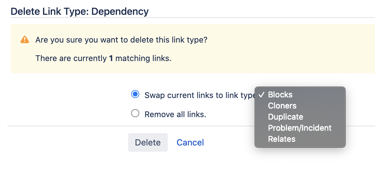

In this case, proceed with deleting the duplicate link type. You will be prompted to swap it:
Once you confirm the deletion, all existing links using the deleted type will be changed.

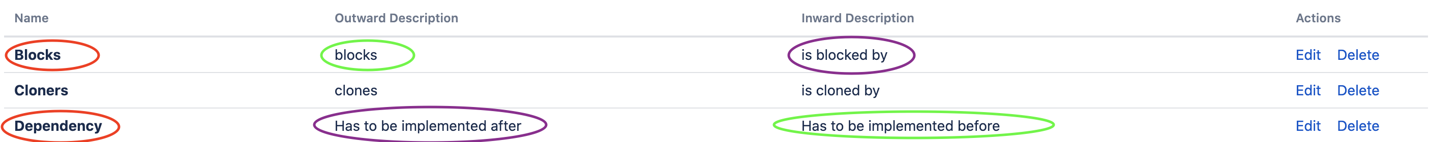

Case B) If inward and outward descriptions have opposite meanings
Here's an example:
In this case, you won't be able to simply delete and swap the issue link because if you do so, the logical meaning of links for all issues using the old type will be inverted. i.e.
Before deletion and swap
After deletion and swap
ABC-123 has to be implemented before XYZ-123
ABC-123 is blocked by XYZ-123 ( this is wrong)
