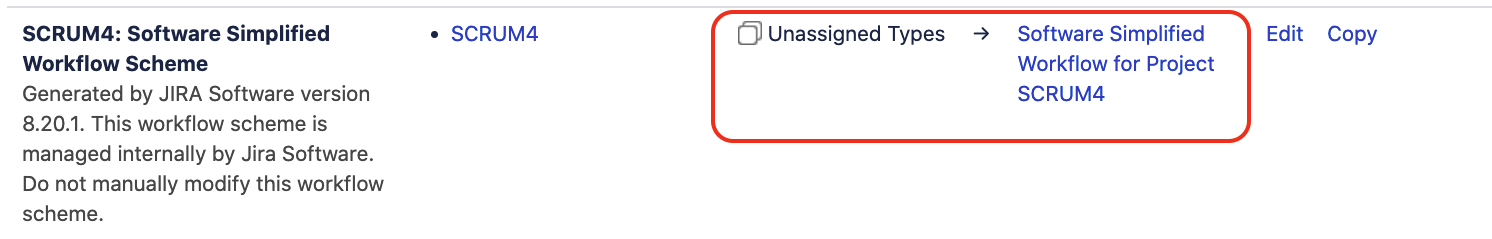

  2. Take a look at the workflow scheme associated to the Jira Software project for which you need to make the Epic Link required at issue creation, so that we can identify the workflow that we will need to copy and edit:

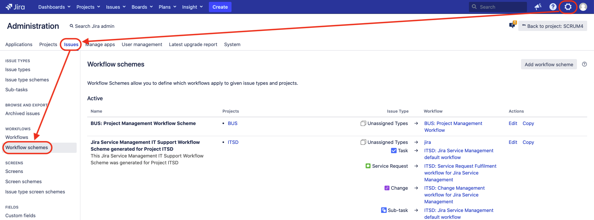

    1. Go to the page ⚙ > Issues > Workflow Schemes
    2. Search for the Jira Software project, and check the mapping between workflows and issue type. In any newly Jira Software project that is created, there should be only 1 workflow, which is associated to any issue type. Take note of this workflow. In the example from the screenshot below, we can see that all issue types are associated to the workflow "Software Simplified Workflow for Project SCRUM4".

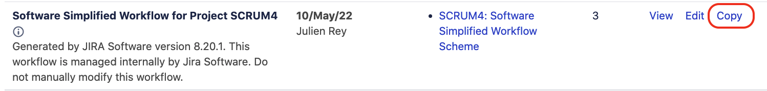

    1. Go to the page ⚙ > Issues > Workflows

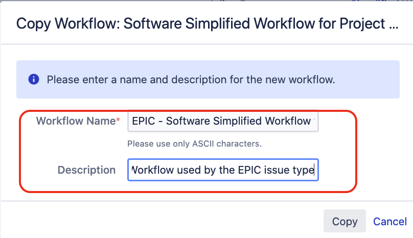

    2. Scroll down to the workflow that you identified earlier, click on the Copy button next to it and make sure to use add a descriptive name and description for this workflow, to make it clear that this workflow will be only used by the Epic Issue type

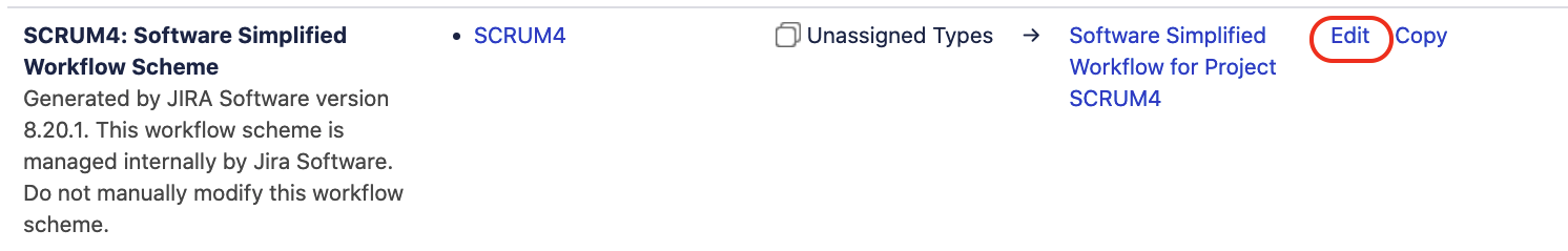

    3. Once the workflow was copied, go back to the page ⚙ > Issues > Workflow Schemes, scroll down again to the workflow scheme used by the Software project, and this time click on the Edit button:

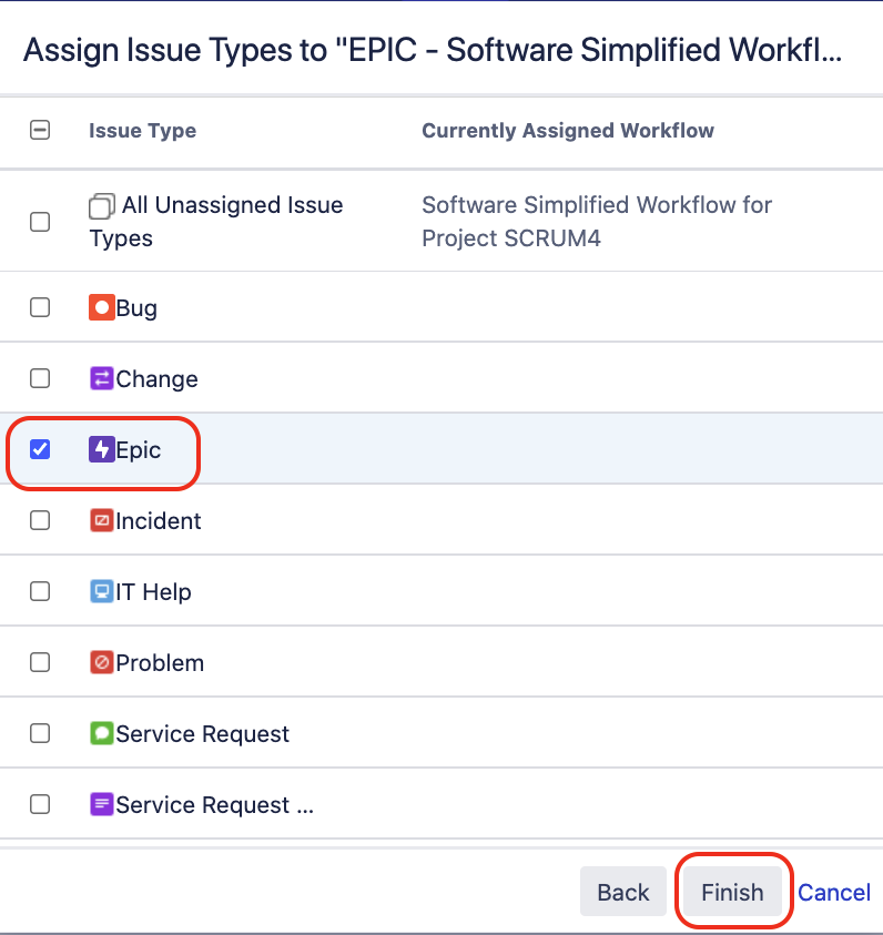

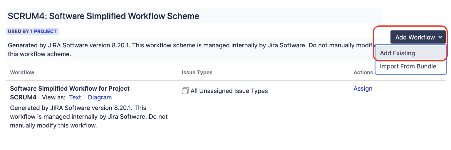

    4. Click on Add Workflow > Add Existing

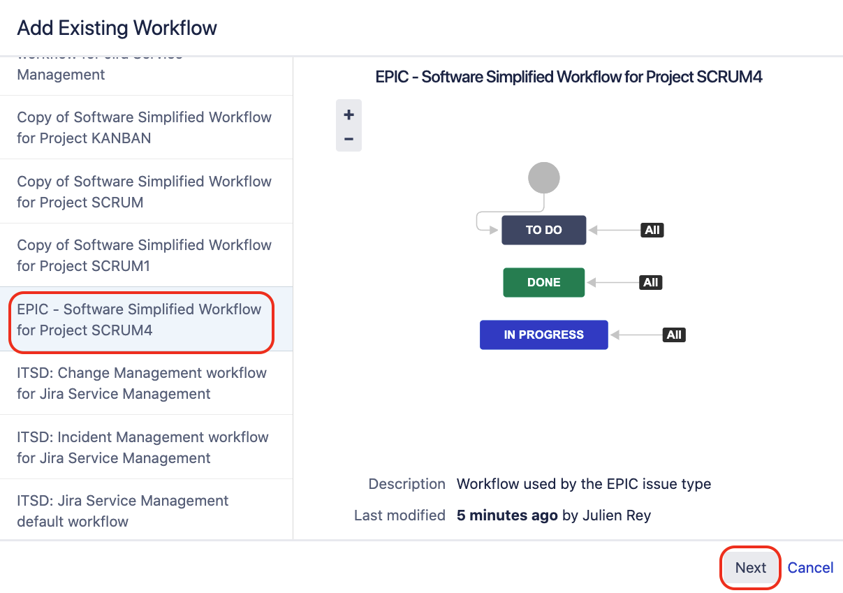

    5. Look for the workflow that was copied earlier and which was dedicated to the Epic Issue Type, and click on Next

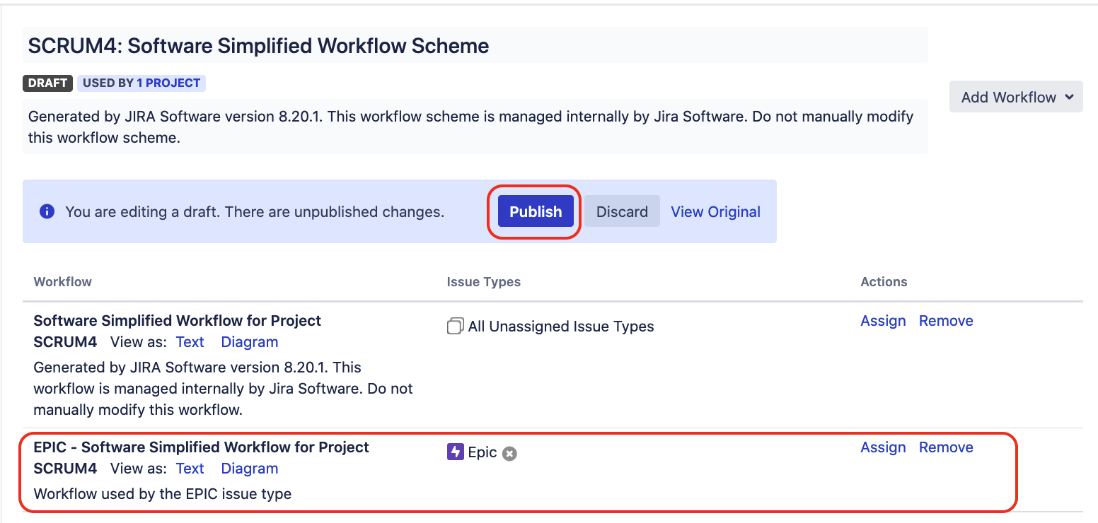

    6. Assign this workflow to the Epic type and click on Finish
    7. After that, verify that the Epic type has now its own dedicated workflow (that we will leave untouched), while all the other issue types are associated to the same workflow (that we will edit in the steps below). Once you verified that the workflow to issue type mapping looks correct, click on Publish to make these changes live:

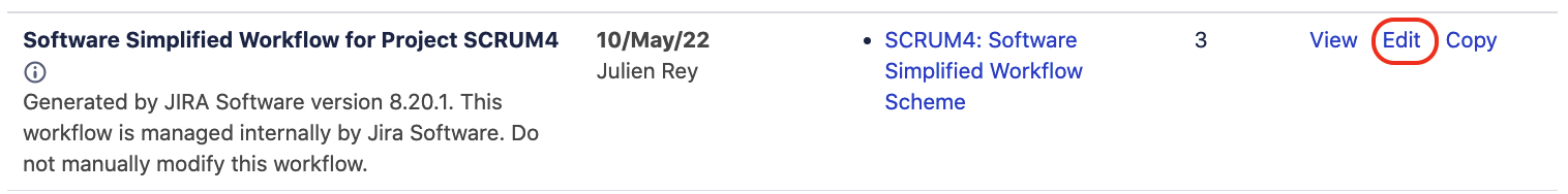

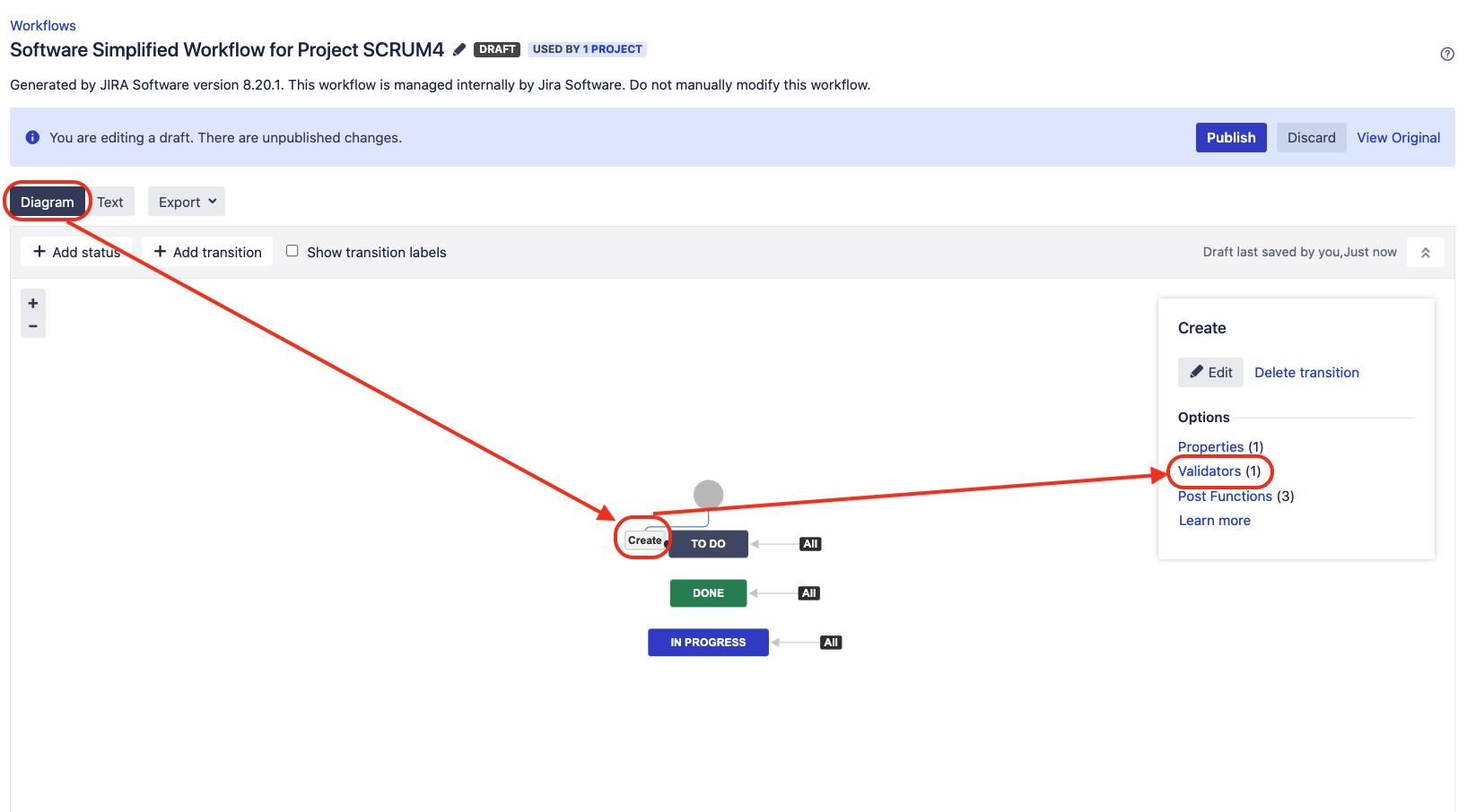

  4. It is now time to edit the workflow associated to all the issue types (except the Epic type), to make the Epic Link field required:
    1. Go back to the page ⚙ > Issues > Workflows, and click on the Edit button next to the workflow which is associated to all the issue types except the Epic type:
    2. Switch to the Diagram mode, click on the Create transition, and then click on the Validators link:

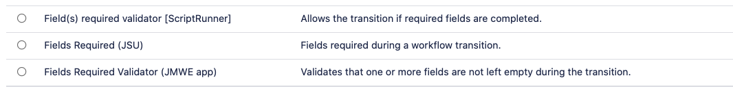

    3. Click on the Add Validator button, and from the list of Validators that shows up, select the 'Fields Required' validator, and then choose the Epic Link field as the required field.
    4. Save and publish your workflow

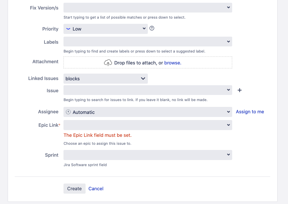

  5. Once this solution is implemented, you will see that:

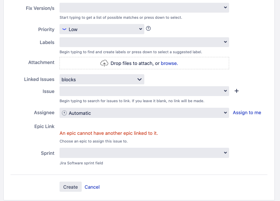

    1. Next time you try to create a new issue in the Software project (other than an Epic type), the Epic Link field will be required:
    2. Next time you try to create an Epic in that same project, the Epic Link field will not be required, which is the expected behavior since Epic Links cannot be added to Epics:
