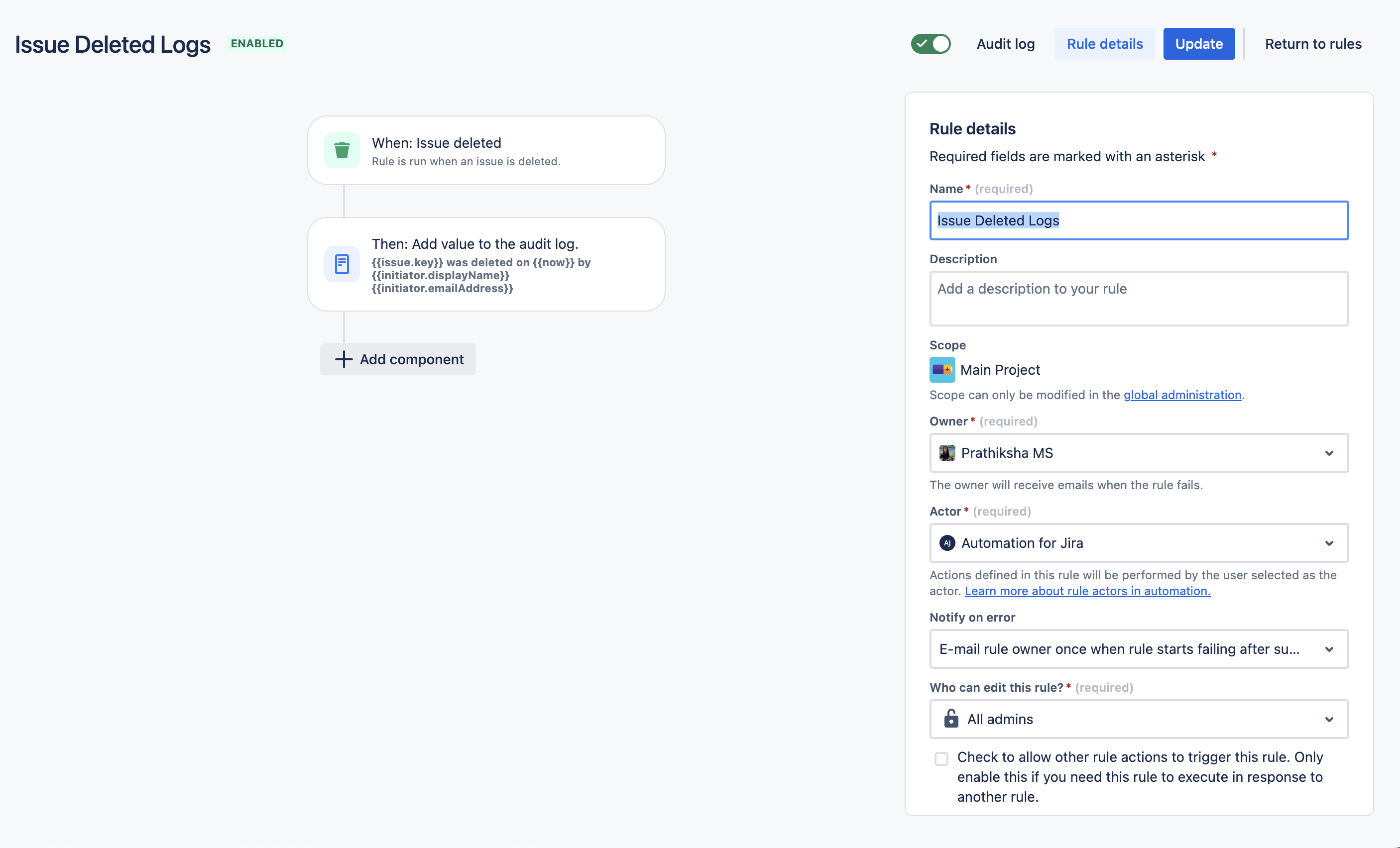

Solution
We can configure a rule that would capture the information about the issue deleted along with the timestamp and the details of the user who deleted it.
  1. Navigate to Project Settings > Automation
  2. Select Create Rule > Trigger Issue Deleted
  3. Add a Log action
    {{issue.key}} was deleted on {{now}} by {{initiator.displayName}} {{initiator.emailAddress}}
    Sample rule that you can import:
    IssueDeletedRule.json
    {"cloud":true,"rules":[{"id":18072903,"clientKey":"90147d1d-bf46-3a28-9f06-037195f5b6bd","name":"Issue Deleted Logs","state":"ENABLED","description":"","authorAccountId":"5e68a319308ac10ced3a1fe8","actor":{"type":"ACCOUNT_ID","value":"557058:f58131cb-b67d-43c7-b30d-6b58d40bd077"},"created":1709131463775,"updated":1709131463775,"trigger":{"id":"408759849","component":"TRIGGER","parentId":null,"conditionParentId":null,"schemaVersion":1,"type":"jira.issue.event.trigger:deleted","value":{"eventKey":"jira:issue_deleted","issueEvent":"issue_deleted"},"children":[],"conditions":[],"connectionId":null},"components":[{"id":"408759850","component":"ACTION","parentId":null,"conditionParentId":null,"schemaVersion":1,"type":"codebarrel.action.log","value":"{{issue.key}} was deleted on {{now}} by {{initiator.displayName}} {{initiator.emailAddress}}","children":[],"conditions":[],"connectionId":null}],"canOtherRuleTrigger":false,"notifyOnError":"FIRSTERROR","projects":[],"labels":[],"tags":[],"ruleScope":{"resources":["ari:cloud:jira:b9f4065b-ff83-4da7-aa54-f91b864ef1f6:project/10024"]},"ruleHome":{"ruleLifecycleHome":{"locationARI":"ari:cloud:jira:b9f4065b-ff83-4da7-aa54-f91b864ef1f6:project/10024"},"ruleBillingHome":{"locationARI":"ari:cloud:jira-servicedesk::site/b9f4065b-ff83-4da7-aa54-f91b864ef1f6"}},"writeAccessType":"UNRESTRICTED","collaborators":[],"billingType":"NORMAL"}]}
You can choose to send email in the same rule as well, but if you choose to use the Notification Scheme it would ensure that this rule wouldn't count towards the execution limits in automation. You can find more details about the limits on New Cloud Automation Limits
