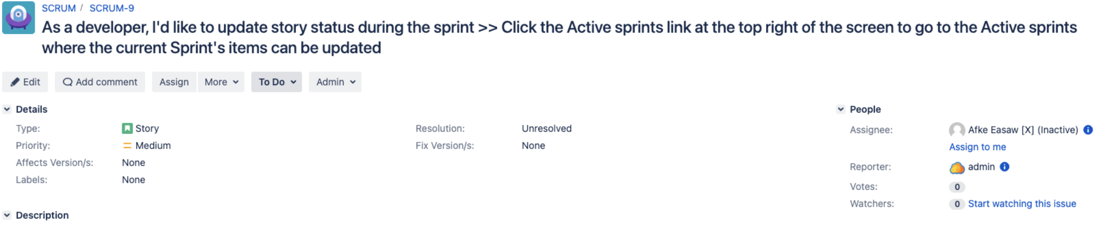

For the following assignee was removed the user from the LDAP, and then Jira correctly set it as Inactive:

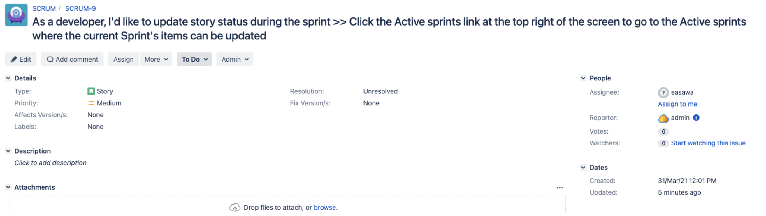

However, after disabling the entire user directory, now the Assignee shows lower case user name without any indication if it is active or not:
It's possible to search for the assignee in lower case but it is not possible to know issues with Assignees that are deleted using JQL.
