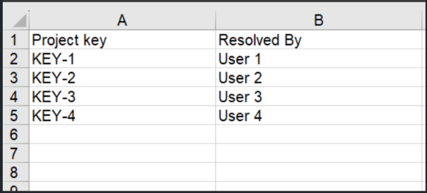

The purpose of this article is to describe a way to write a script that will return the mapping of issue-key and user who resolved that issue:

The mapping "Issue Key/Jira user" can be obtained by using the expand=changelog parameter from the the REST API getIssue.
The example below shows a snippet of the information obtained when using this parameter:
<base-url>/rest/api/2/issue/<issue-key>?expand=changelog" {         "id": "10305",         "author": {           "self": "<base-url>/rest/api/2/user?username=testUser1",           "name": "testUser1",           "key": "JIRAUSER10100",           "emailAddress": "testUser1@test.com",           "avatarUrls": {             "48x48": "https://www.gravatar.com/avatar/94fba03762323f286d7c3ca9e001c541?d=mm&s=48",             "24x24": "https://www.gravatar.com/avatar/94fba03762323f286d7c3ca9e001c541?d=mm&s=24",             "16x16": "https://www.gravatar.com/avatar/94fba03762323f286d7c3ca9e001c541?d=mm&s=16",             "32x32": "https://www.gravatar.com/avatar/94fba03762323f286d7c3ca9e001c541?d=mm&s=32"           },           "displayName": "testUser1",           "active": true,           "timeZone": "Etc/UTC"         },         "created": "2024-09-12T09:21:41.323+0000",         "items": [           {             "field": "resolution",             "fieldtype": "jira",             "from": null,             "fromString": null,             "to": "10000",             "toString": "Done"           },           {             "field": "status",             "fieldtype": "jira",             "from": "3",             "fromString": "In Progress",             "to": "10001",             "toString": "Done"           }         ]     }
To get the name of the user who resolved the issue from the example above, you will need to:
  • first look for the change made to the resolution field (in the Items → Field key)
  • then look for the displayName key (which is testUser1 in the example above)
