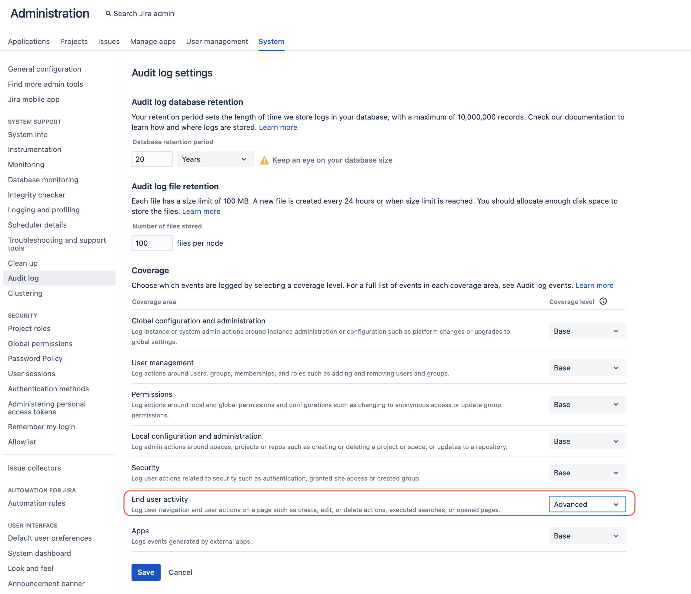

To view which users deleted a Jira issue, you need to first update the Audit Logs configuration by following the steps below:

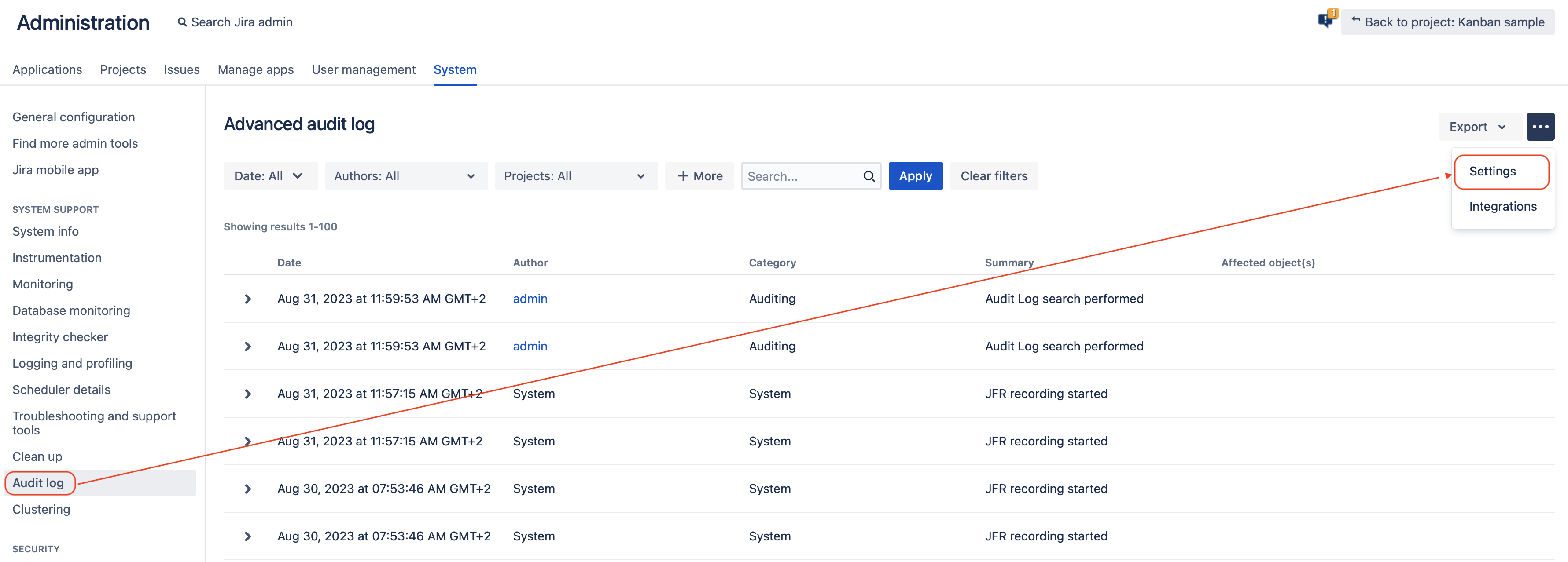

  1. Go to ⚙ > System > Audit Logs
  2. Click on ... > Settings
  3. Under Coverage, look for the End user activity setting, change it to Advanced, and click Save
    ℹ️ Note that, with such settings, several issue operations will be recorded in the Audit Logs as explained in The Audit Logs documentation:
    Issue deleted, Issue archived, Issue restored, Issue attachment deleted, Comment of another user deleted, Sub-task deleted, Archived issues exported (8.12.0+), Issues exported (8.12.0+)

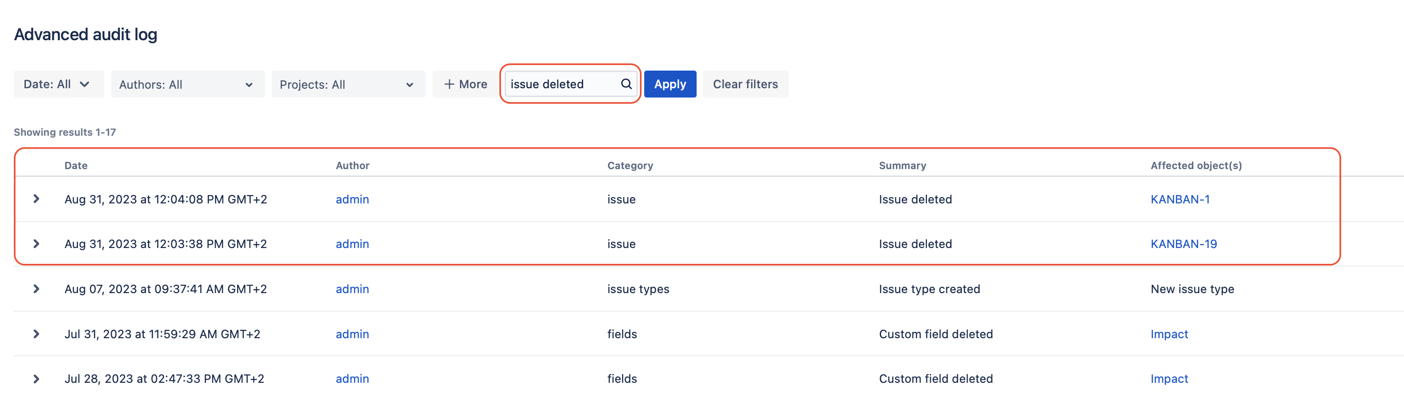

Any issue that was deleted after this configuration change was made will be found by searching for the string issue deleted (without double quotes) in the Audit Logs page, as shown in the example below:
ℹ️ Note that, due to some limitations around how the search works, it is not possible to filter the results by only including the "issue" category. Because of that, and as shown in the screenshot above, the results might also include actions that are not related to issue deletion.
