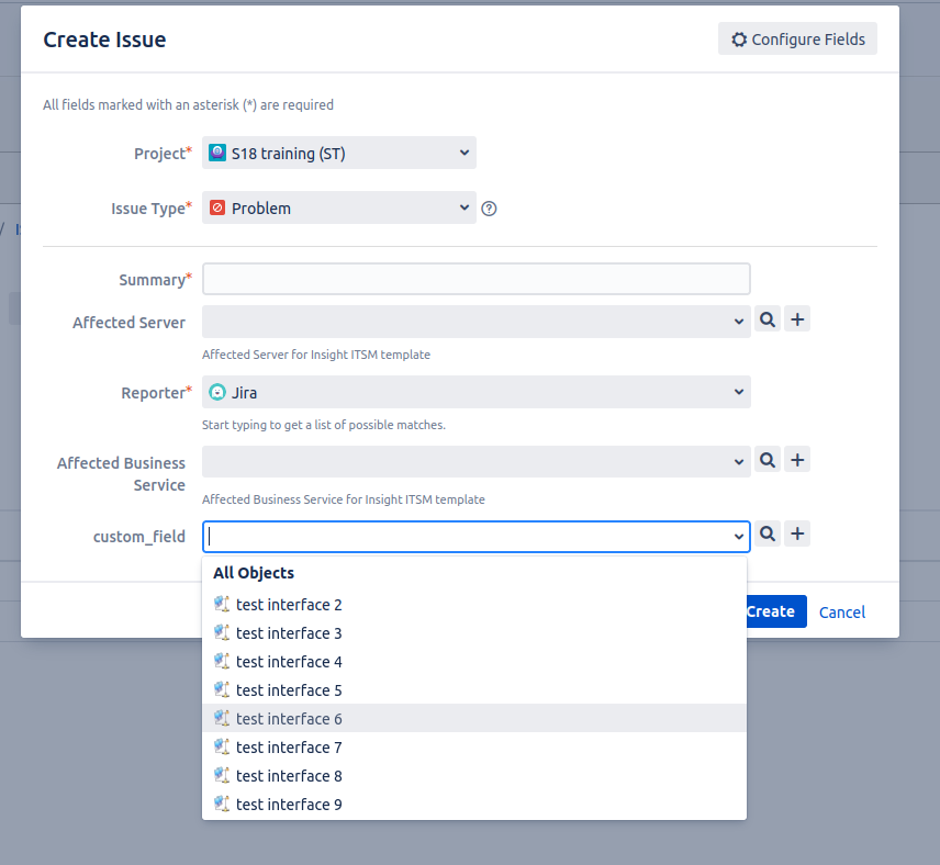

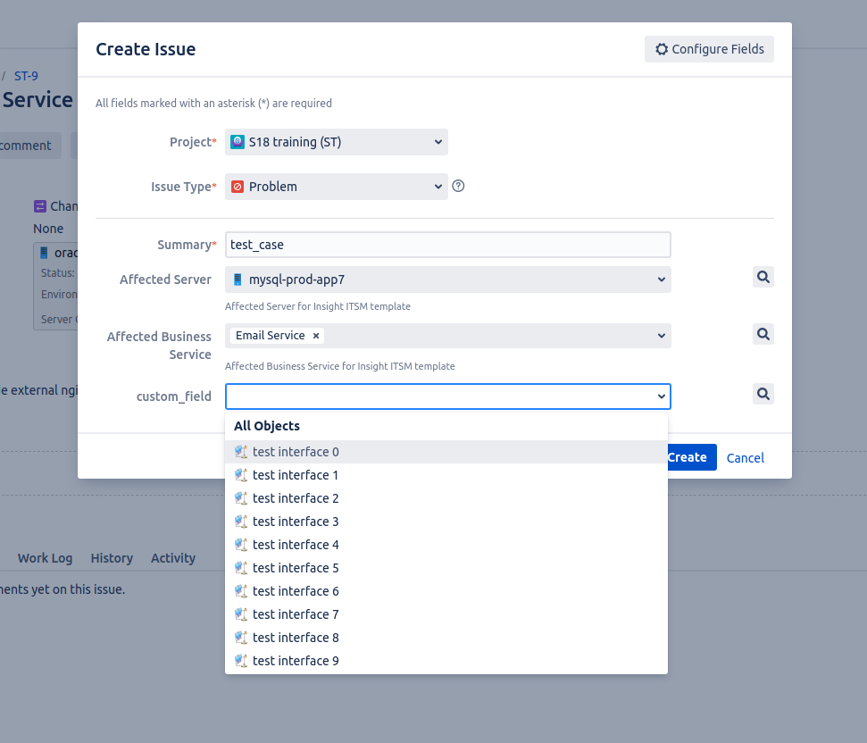

  • After creating a custom field (custom_field) with the type Asset object and configuring it to display the desired object type (Network Interface):
  • We are able to create a new issue in the project using any network interface from 0 to 9 :

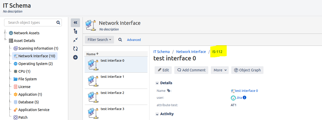

If a single object is required to be excluded, one option to perform this is to exclude the object by objectid.
ℹ️ (You can find the objectid on the object page, you should use the number without the key)
  • In the below example, the ID is 112:

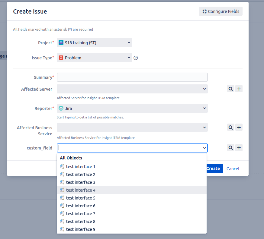

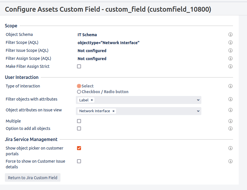

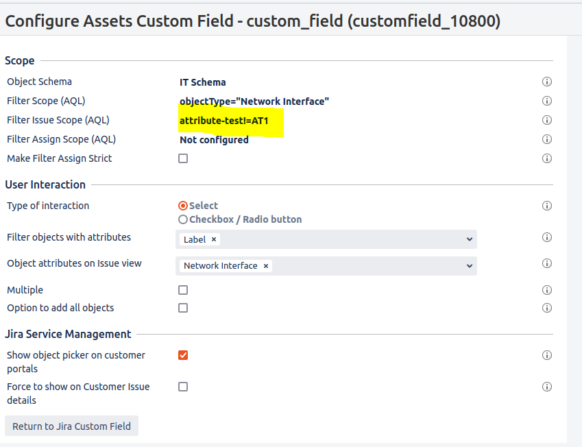

  • We can then exclude it using the Filter Scope (AQL) query, in this case, we are using objectid!=112 to include anything not matching the objectid:
  • As a result, the Network Interface 0 object is not an option on the selectable object for the field:

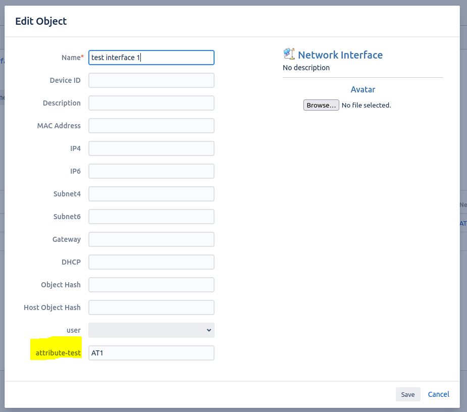

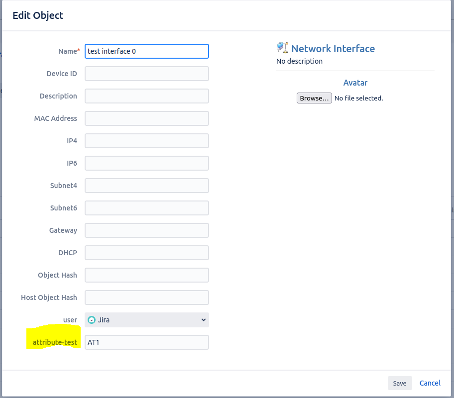

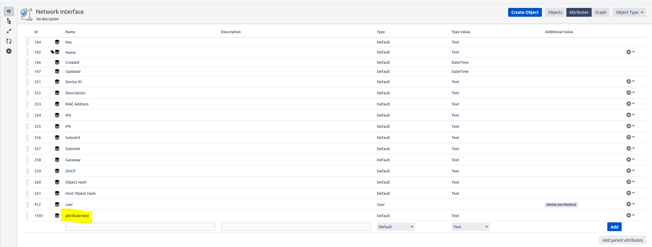

  • In the Assets objects attributes we can create an attribute (attribute-test):
  • Add the attribute value to the desired objects (AT1):
  • We can then exclude it using the Filter Scope (AQL) query, in this case, we are using attribute-test!=AT1 to include anything not matching the AT1 attribute:
  • As a result, the Network Interface 0 and Network Interface 1 objects are not an option on the selectable objects for the field:
