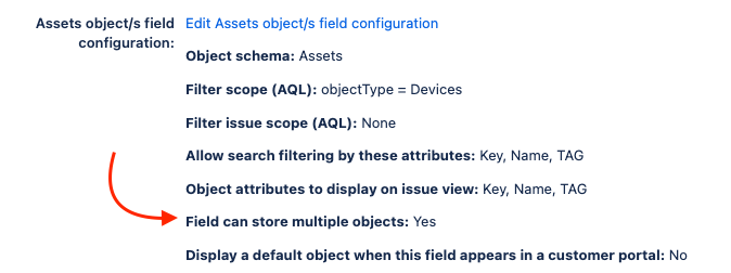

Your Asset field must allow multiple objects to be stored within it

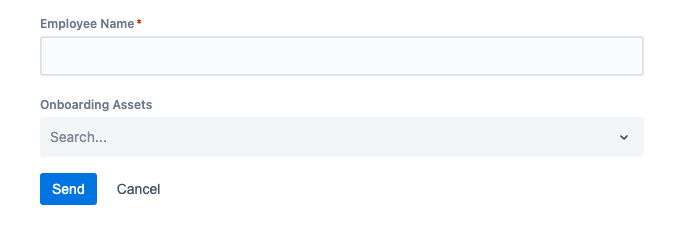

Preparing the Request Type
For simplicity's sake, in this scenario we'll be using a simple Request Type, that captures the Onboarding user's name in the Summary field. This is relevant when setting up the automation action that creates the sub-tasks:

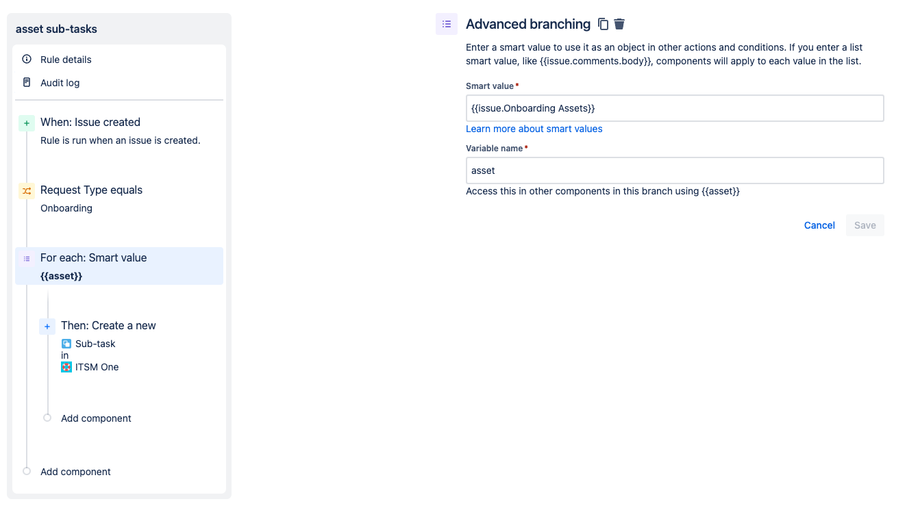

Advanced Branching: this component will define our FOR EACH "loop" that creates a separate sub-task for each asset informed on the "Onboarding Assets" field;
Action: Create Issue - this action will be used to create the sub-tasks.

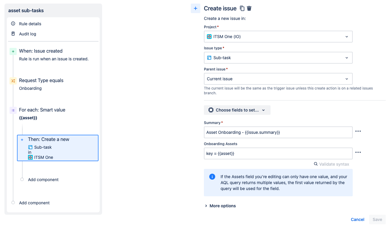

For our example, the Advanced Branch and Create Issue actions should look like so:
Smart values used:
{{issue.Onboarding Assets}} - This smart value is used on the Advanced Branching component, to fetch each individual object key of the objects added to our "Onboarding Assets" field. It can be used within the branch using the smart value {{asset}}, per the examples above.
{{issue.summary}} - In this example, this smart value will contain the summary of the original Onboarding request, therefore the employee's name.

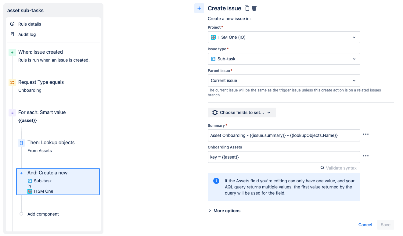

Optional - Lookup objects action inside the branch
Optionally, we can add a Lookup Objects action within the branch in order to fetch additional information from the objects, as the branch smart value will provide us only the object's key as text, not the object itself:
With that, we can then use the object's name (or other information) to add to the Summary on the sub-tasks:
Smart values used:
{{lookupObjects.Name}} - This will contain the Name of the object being used to create the sub-task.

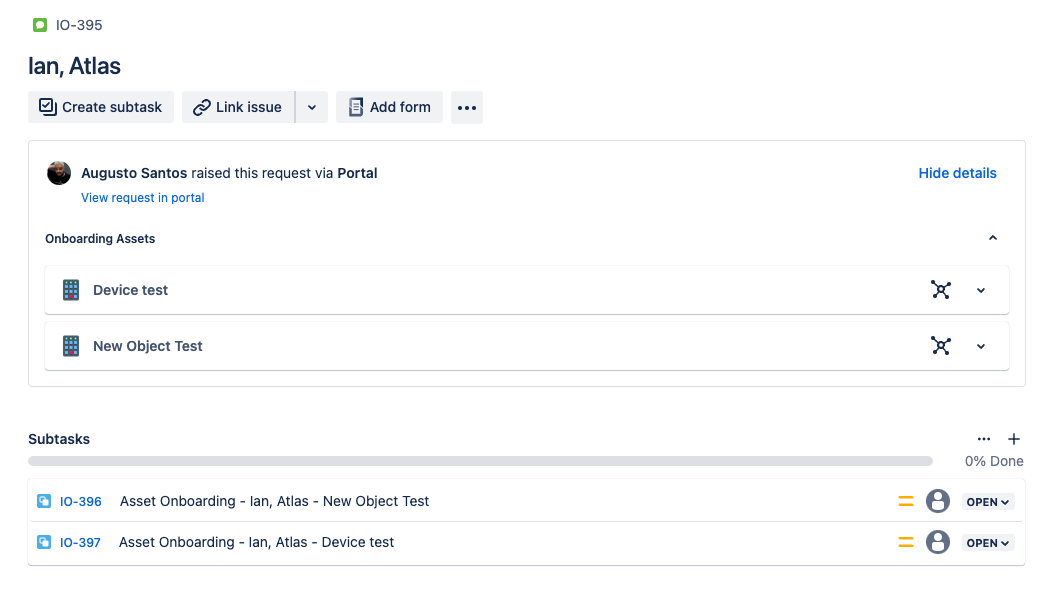

Final results
With the added Lookup Objects action in the example above, a new Onboarding ticket should successfully create sub-tasks in the following format: Asset Onboarding - Employee Name - Asset Name:
