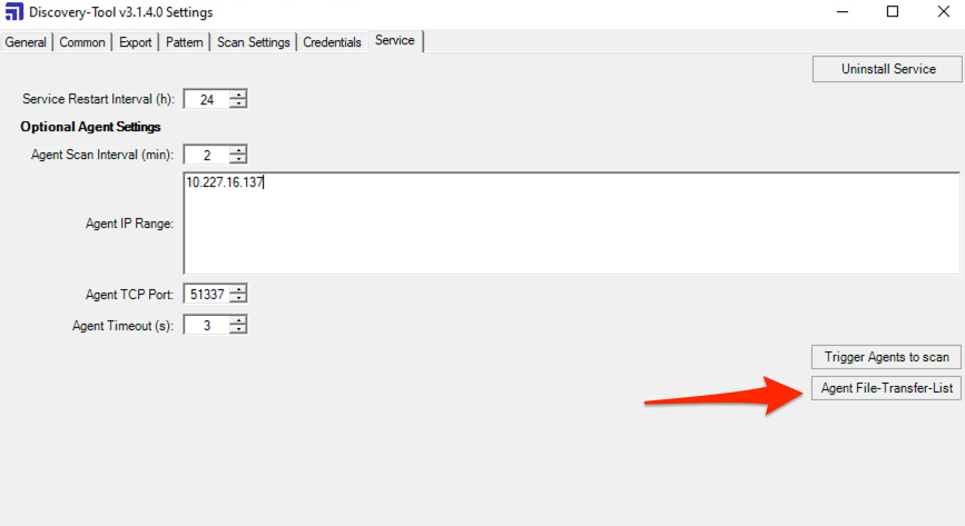

To transfer a file, open the Agent tab and select Patterns transfer. For Assets Discovery earlier than 7.x, go to Scan Settings and select Agent File-Transfer List.

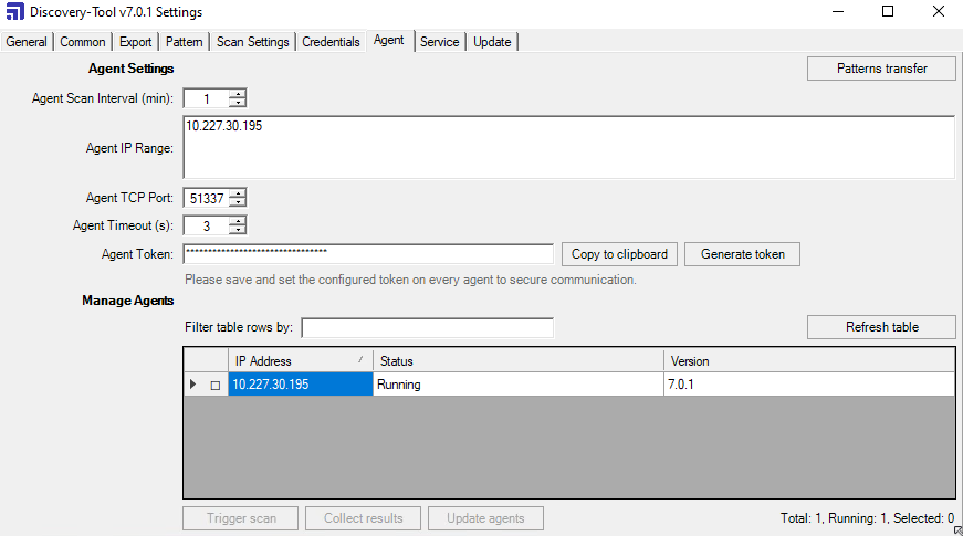

Agents settings in Discovery Tool v7.x:
Agent settings in Discovery Tool v7.0.1
Agent settings in Discovery Tool versions below 7.x:
Agent settings of Discovery Tool versions below 7

  3. Open the Agent tab. Here, you can configure the following fields:
    1. Agent Scan Interval - The interval, in minutes, is when the Discovery service checks with the Discovery Agents for new data available.
    2. Agent IP Range - Define the Agents IP ranges that will be checked. You can define multiple ranges. When you define an Agent IP range, Discovery goes through it as per the time set up in the Agent Scan Interval field and tries to get data from the Agents. If an Agent has new data, it will perform an SSL handshake to encrypt data for this communication.
    3. Agent TCP Port - The TCP Port of the available Agents in the configured IP Range.
      • Discovery tool uses the outgoing TCP port 51337.
      • Discovery-Agent TCP uses port 51337 as inbound.
    4. Agent Timeout(s) - The default timeout for each connection to a remote agent. The default period is 3 seconds.
    5. Agent Token - Add a secure token in this field or generate a token for all Agents and save it.

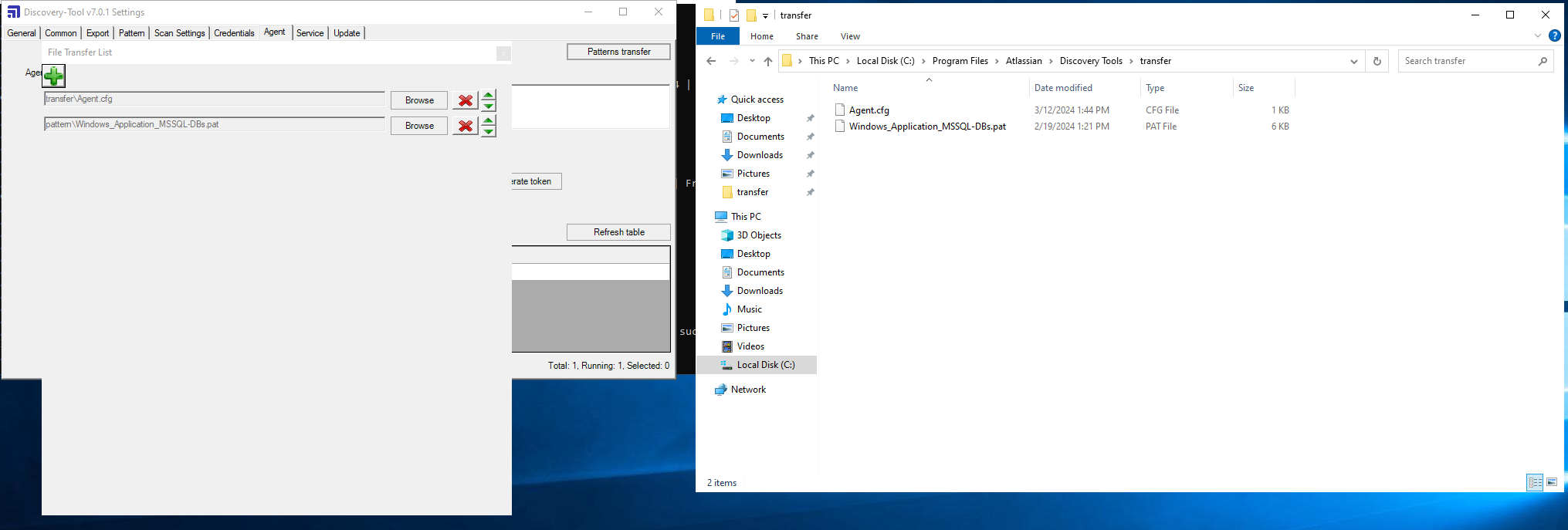

  4. Select Patterns transfer to configure files synchronized with all available agents at the configured range.

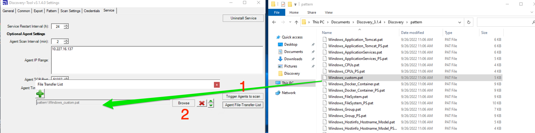

The files you want to transfer must be stored in the Discovery tool directory. Below are the screenshots from Discovery Tool v7.0.1 and 3.1.4. In this example, the Windows_custom.pat file will be copied to \Discovery Agent Installer\pattern Agent directory (with the IP address 10.227.16.137) based on the value set in the Agent Scan Interval field. In this case, after two minutes, as long as the Discovery tool is installed as a Service.
Files to be transferred are in a custom folder called transfer in the Discovery Tool folder
The file transfer list in earlier versions of Discovery Tool
