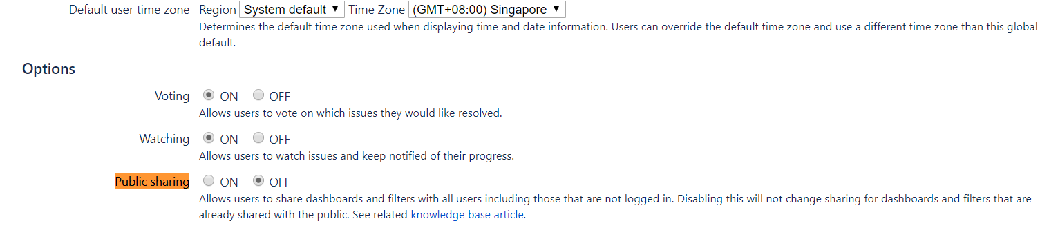

1. Check whether Public sharing is ON.
In order to identify if your instance has content that is open for the public you first need to confirm if the Public sharing functionality is ON.
Since Jira 7.2.2, Jira administrators can disable the ability of Jira users to share dashboards and filters publicly via a new global setting "Public sharing". This setting is available from Administration Menu > System > General Configuration > Edit Settings.
If your Jira instance is private and not to be used by users without logging in you should turn this feature OFF. This way users will no longer be able to share any dashboards or filters with anonymous users.
Turning the feature off will not affect existing filters and dashboards. If you change this setting, you will still need to update the existing filters and dashboards if they have already been shared publicly.

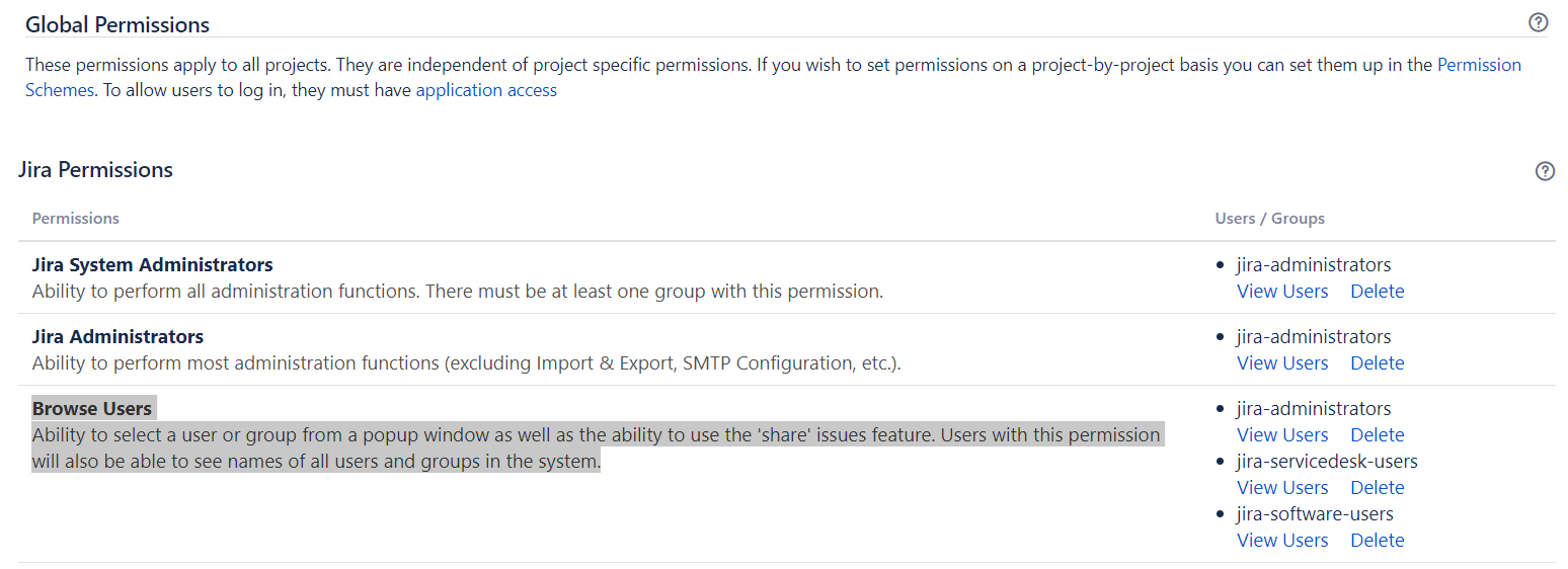

3. Monitor the Browse User global permission
Through the user picker functionality within Jira your user base information could be available to anonymous users. The Browse User Global Permission allows a user to view a list of all Jira user names and group names, share issues, and @mention people on issues. This is used for selecting users/groups in popup screens and also enables auto-completion of user names in most 'User Picker' menus and popups.
If you grant this permission to the Anyone group, you will be allowing anonymous users access to the endpoints that provide a list of users
Ensure that this permission is restricted to specific groups that require it. You can restrict it in Administration > System > Global Permissions.

2. Review the global Browse Users permission
Go to Administration > System > Global Permissions.
Go to the "Browse Users" permission under Jira Permissions.
Remove the group "Anyone" from this permission as explained here.
