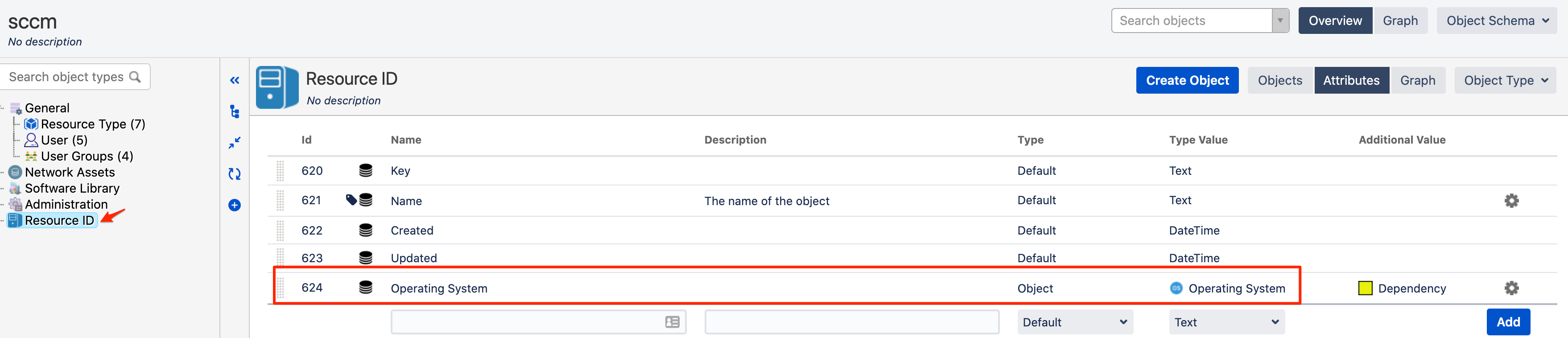

  1. Create a new Object Type to store the Resource IDs. Let's call it "Resource ID"
    1. Add one additional attribute: "Operating System" of the Type Object, referencing the "Operating System" object Type

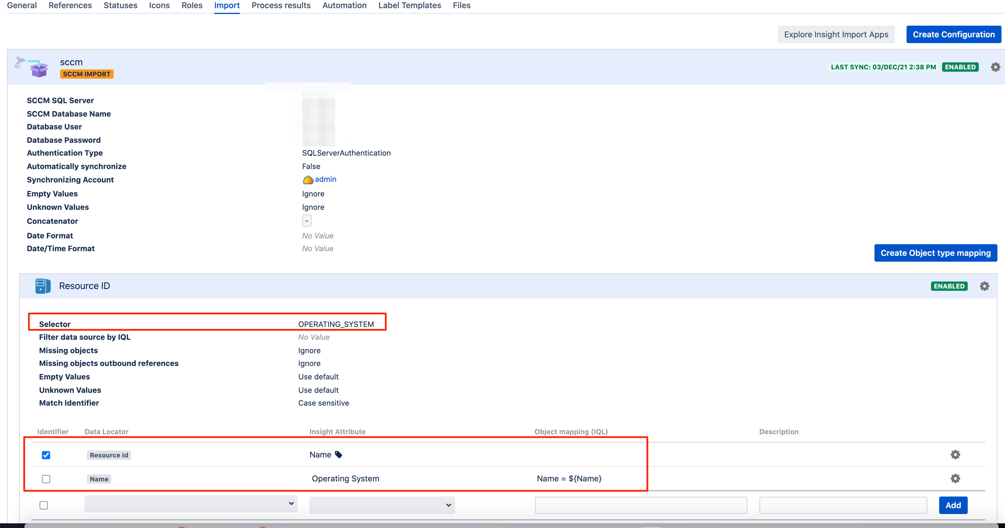

  2. Create a new Object Type Mapping for the new "Resource ID" Object Type. Use the following configuration:
    Object Type Mapping Configuration
    1. Selector: OPERATING_SYSTEM;
      1. Data Locator: Resource Id
        1. Insight Attribute: Name
      2. Data Locator: Name;
        1. Insight Attribute:Operating System
        2. IQL:Name = ${Name}
    1. This will result in the creation of Resource ID Objects mapped to the respective "grouped" OS Object.
    2. Ensure that Selector: OPERATING_SYSTEM; ends with ';'

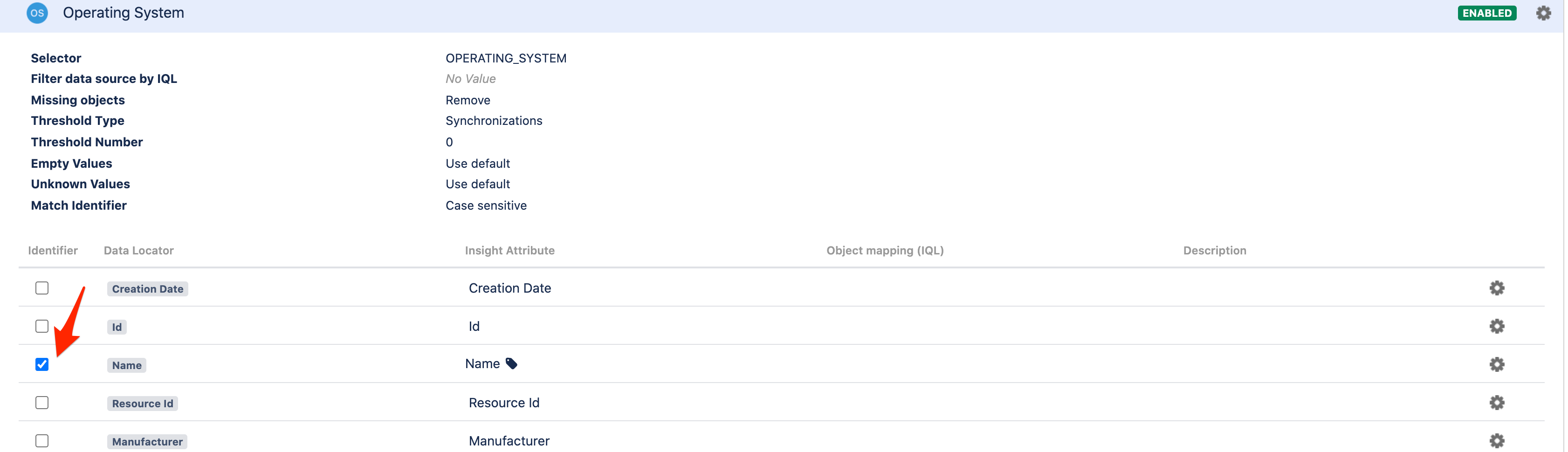

  3. In the Operating Systems Object Type mapping:
    1. Set Nameas the only identifier, and remove the map to the (old) Resource Id Text attribute

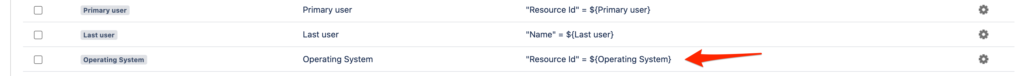

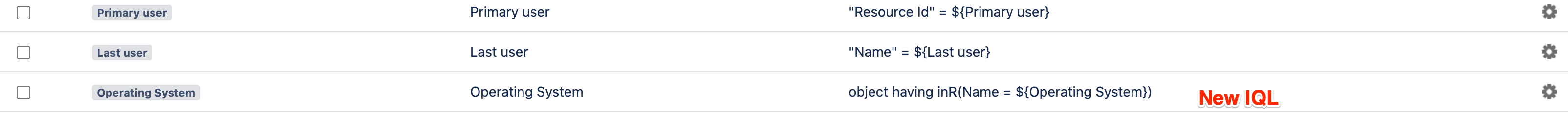

  4. In the System Object Type mapping change the current IQL:
    1. From: "Resource Id" = ${Operating System}
    2. TO: object having inR(Name = ${Operating System})
