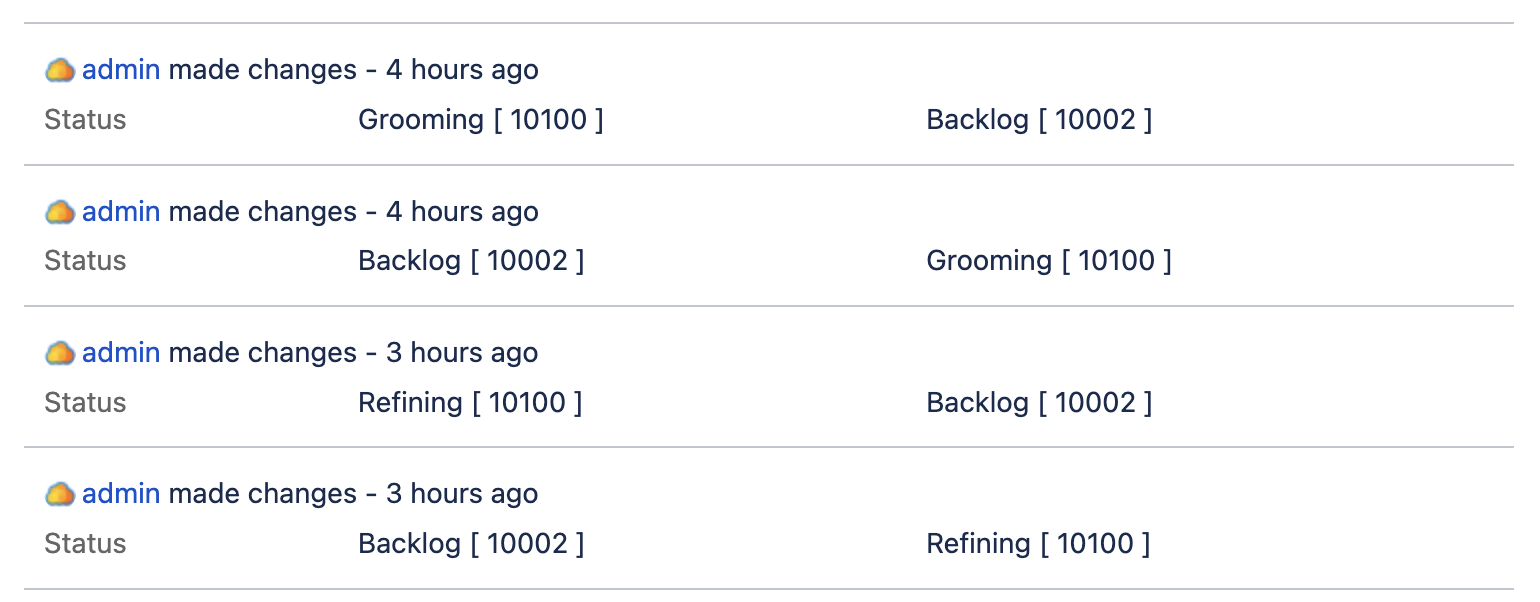

Note on Issue History
The Issue History (aka changelog) will continue to reflect the old names, though.
This is because the changelog's written by copying whatever was the Status name at that time, regardless of what it is right now when the Issue history's browsed.
This may actually be beneficial and be left the way it is — it's useful for troubleshooting Status name changes as the Status Id remains the same. Notice how the Status Id's the same (10100) but the name changed from "Grooming" to "Refining" in this example:
This also means searches for the old Status name will bring up the Issues even if there's no Status with that old name anymore in Jira:
status was in ("old status name")
