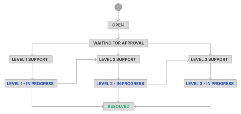

This automation rule example is designed to operate according to the following workflow.
Workflow diagram showing the lifecycle of a support ticket.  From Open, it can move to Waiting for Approval then to level 1, 2, or 3 support, each with an In Progress status.  Tickets can also move to User Testing and finally Closed or Resolved.
According to this workflow, the issue can be resolved at any support level or escalated to the next support level.
In either case, the total time spent in the previous status will be calculated and stored in the system field belonging to that level.

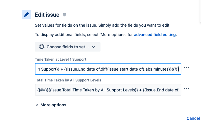

This automation rule calculates two kinds of totals: the time spent in each status and the total time spent on the issue from start to finish. The following expression calculates the time in each status and the total time spent on the issue.
Jira automation rule editing screen. The rule is set up to change the start date field when an issue transitions to LEVEL 1 SUPPORT. The start date is set to the current time in Sydney, Australia.
{{#=}}{{issue.Time Taken at User Testing}} + {{issue.End date cf.diff(issue.start date cf).abs.minutes}}{{/}} {{#=}}{{issue.Total Time Taken by All Support Levels}} + {{issue.End date cf.diff(issue.Start date cf).abs.minutes}}{{/}}

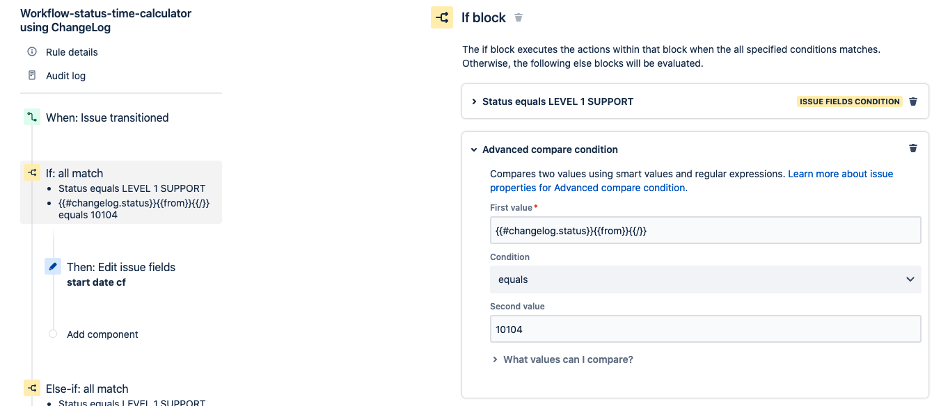

The time difference is calculated using the status entry time and status exit time. To find the status that the issue was transitioned from, the following smart expression is used
{{#changelog.status}}{{from}}{{/}}
Jira automation rule conditions.  The rule is configured to check if the previous status ID from the changelog equals 10104 and the current status is LEVEL 1 SUPPORT.
The status ID can be found by navigating to the global status page, https://your-site.atlassian.net/secure/admin/ViewStatuses.jspa. Hover over the 'Edit' link next to each status line and note the status ID from the URL that appears at the bottom of the page.
