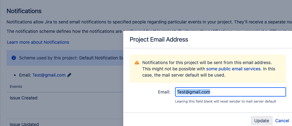

How to bulk update the from email address under Project Notifications ?

Due to change in the email address that is common to all the projects, one need to manually update each project as there is no API to perform bulk operation for all the projects.

Since there is no bulk update operation, you may want to update the Database entry holding the from email address for notifications of the projects manually by following the steps mentioned below.
  • Take complete database backup of your JIRA
  • Stop JIRA
  • Execute below SQL to fetch the list of projects having the email address that needs to be bulk updated.
select * from project_key pk where pk.project_id in (select p3.entity_id from propertyentry p3 where p3.id in (select id from propertystring p2 where p2.propertyvalue like '%Test@gmail.com%'))
  • Update the email address of the all the projects email from notification.
update propertystring set propertyvalue='TestApple@gmail.com' where propertyvalue='Test@gmail.com'
