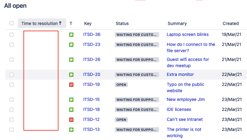

In some rare cases, due to corruption or unexpected events, SLA values can become missing on Jira issues: for example, this screenshot illustrates missing SLA values for the "Time to resolution" SLA:

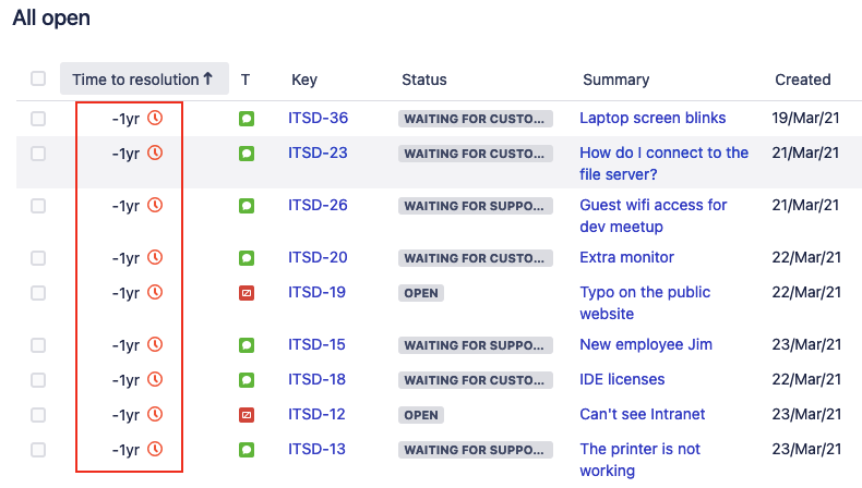

  • Viewing the affected issues in Jira will now show proper SLA values:
