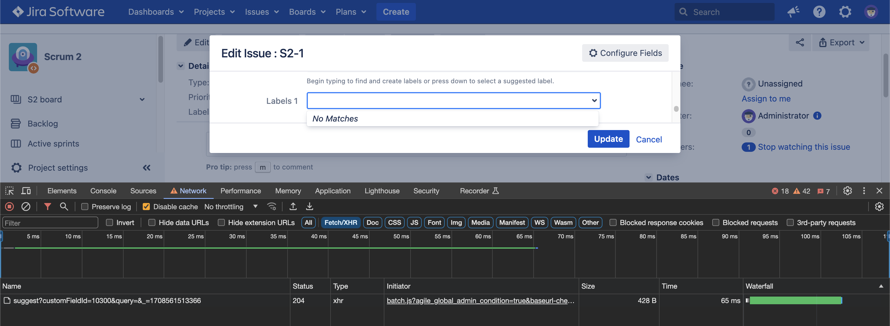

On this example, we're returning HTTP Status Code 204, which means "no content". In the Network tab of the Developer Tools (HAR file) you'll see the response 204:
