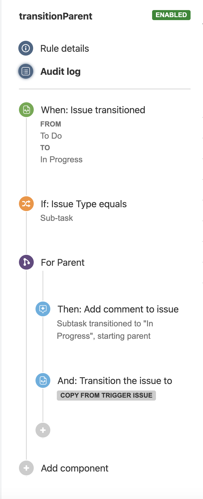

  • Create a rule on the desired Project to be triggered when a sub-task is transitioned.
  • Although the issue that triggered the automation is the sub-task, the conditions and actions should be executed for the parent of the sub-task. We need to open a separate branch for the parent.
  • On the Parent's branch, add the condition to check if the parent is still as "To-do" and then add an action to transition the parent to "In Progress".

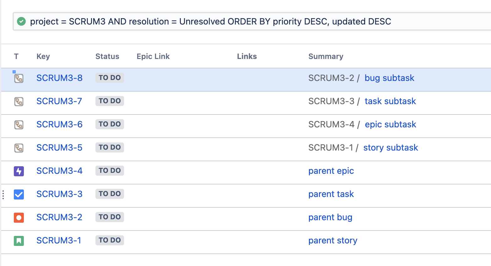

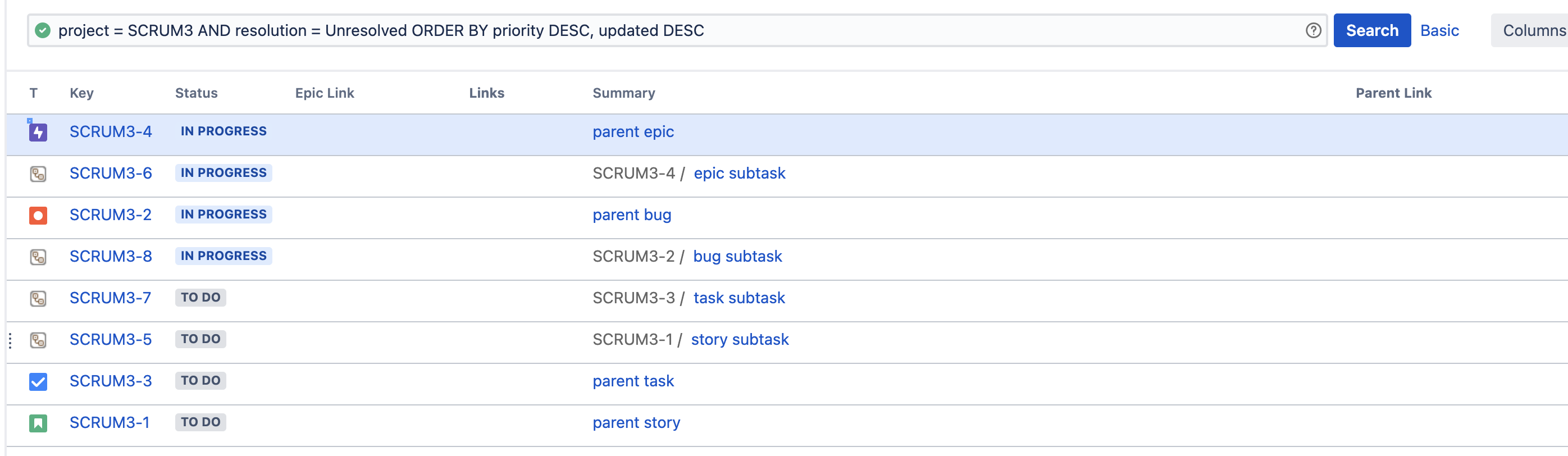

  • Running the rule:
Goal: When one of the subtasks is moved to "In Progress" from "Open", transition also the parent to "In Progress". On the samples below, Bug's subtask and Epic's subtask were moved to "In Progress".
  • Audit Log shows the execution of the rule for both transitions:

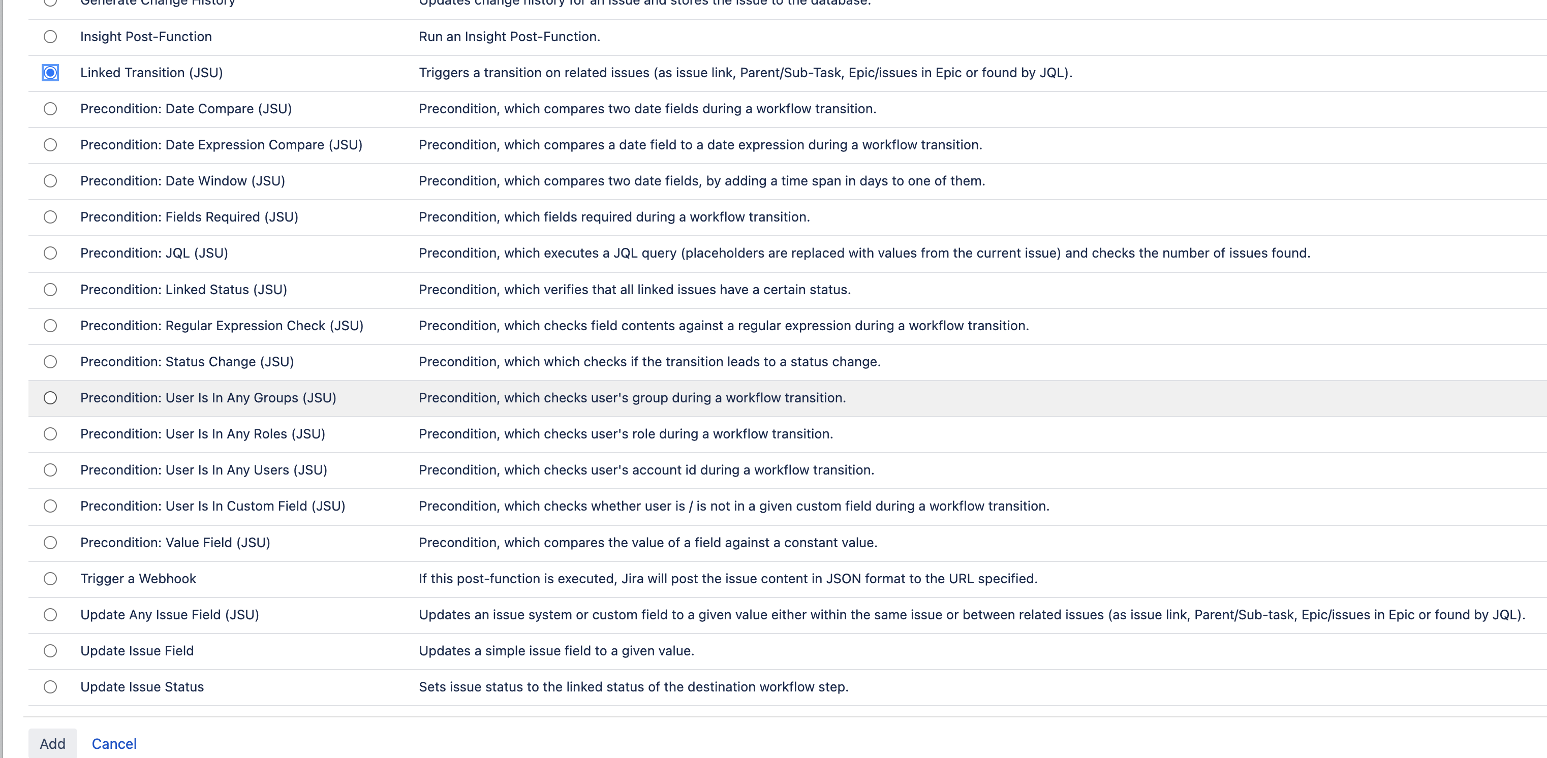

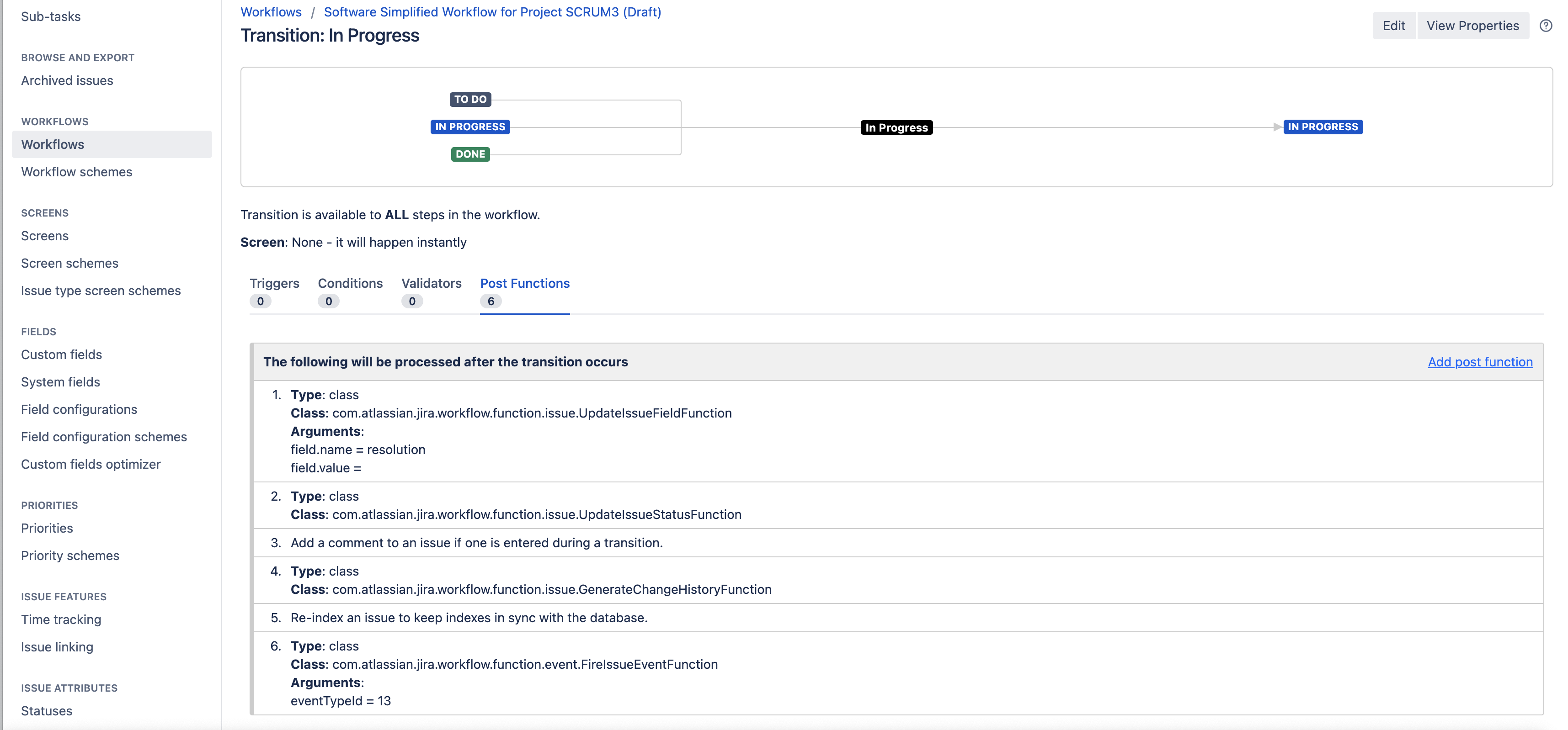

  • On the workflow used by the sub-task, we added a new post-function triggered at the transition to "In Progress":
  • We did select the "Linked Transition (JSU) post-function:

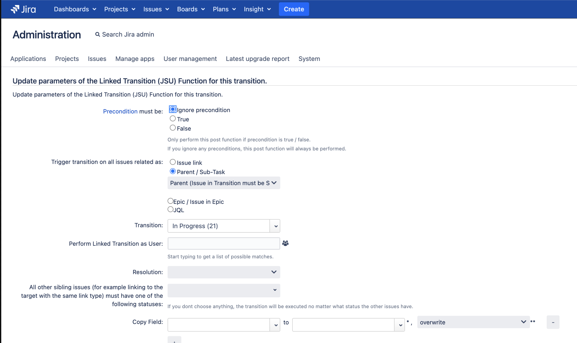

  • At the "Trigger transition on all issues related as", select "Parente/Sub-Task and the option "Parent (Issue in Transition must be Sub-Task)" and the target of the transition, "In Progress":
