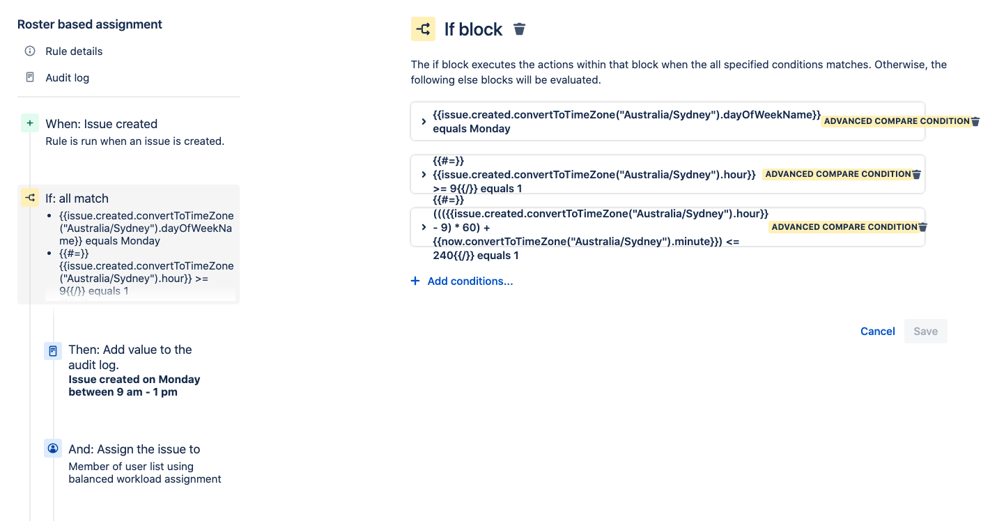

IF block showing the logic for determining the first half of any given day
IF block - Condition 1 (Determining the day of the week)
1 {{issue.created.convertToTimeZone("Australia/Sydney").dayOfWeekName}}

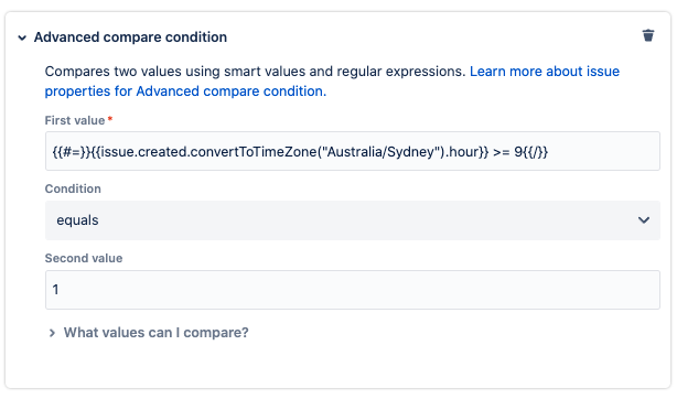

IF block - Condition 2 (Determining start of the first half)
1 {{#=}}{{issue.created.convertToTimeZone("Australia/Sydney").hour}} >= 9{{/}}
IF block - Condition 3 (Determining end of the first half)
1 {{#=}}((({{issue.created.convertToTimeZone("Australia/Sydney").hour}} - 9) * 60) + {{now.convertToTimeZone("Australia/Sydney").minute}}) <= 240{{/}}

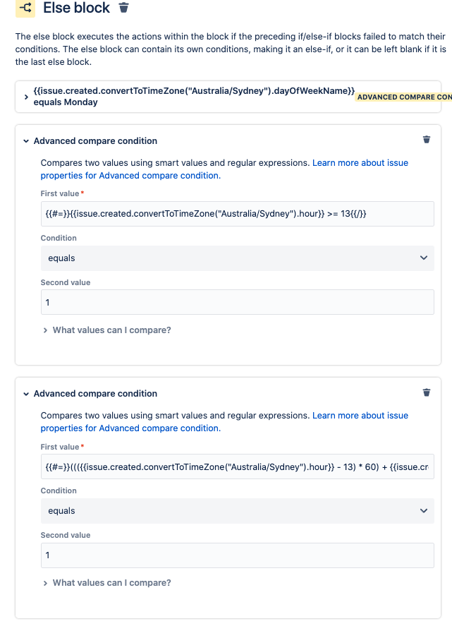

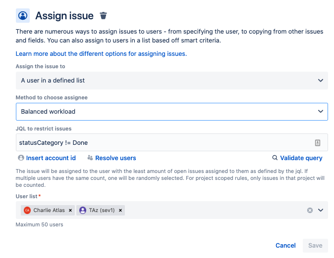

Issue assignment using balanced workload
Similarly, the formula for the other half can be driven
1 {{#=}}{{issue.created.convertToTimeZone("Australia/Sydney").hour}} >= 13{{/}}
1 {{#=}}((({{issue.created.convertToTimeZone("Australia/Sydney").hour}} - 13) * 60) + {{issue.created.convertToTimeZone("Australia/Sydney").minute}}) <= 240{{/}}
This entire IF-ELSE block can be repeated for the whole week either without modification or the length of each half can be changed by changing the number in the compare conditions. Currently each half is assumed four hours long hence it is compared to 240 which is the total number of minutes in four hours.
