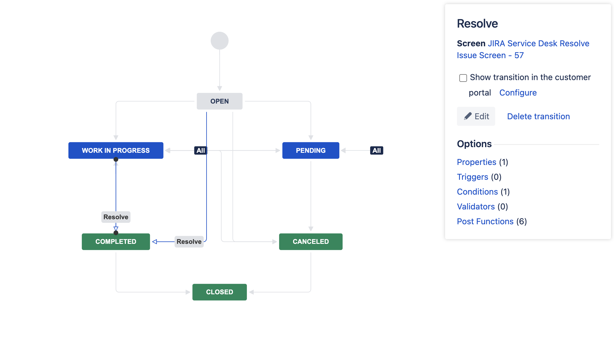

Using workflow validators
  • Forms: Forms attached.
  • Forms: Forms submitted.
To add these, you would need to follow the steps below:
  1. Verify the workflow used by the selected issue type.
  2. Navigate to the workflow from within the project Space Settings > Workflows > Edit.
  3. Select the transition to add the validator.
  4. Add the validator Forms: Forms attached/Forms: Forms submitted.
  5. Publish the changes.

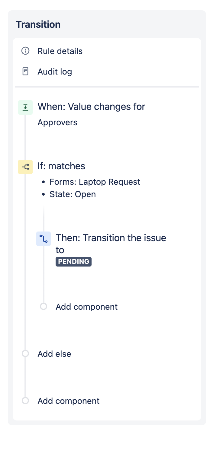

Using automation
To add conditions using automation
  1. Trigger: Choose an appropriate trigger based on your use case.
  2. Condition: If Forms attached > select the specific form (add additional conditions as you see fit).
  3. Action: Transition issue.
After adding the validator/automation, attempt the guarded transition without a submitted form and confirm it is blocked; then attempt it with a submitted form and confirm it proceeds.
