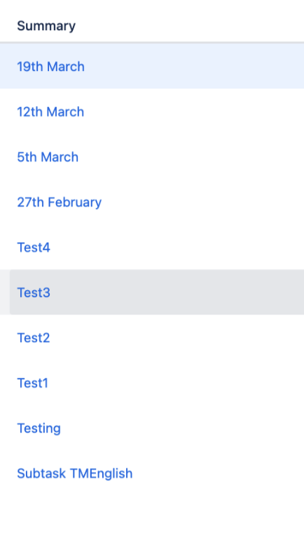

New issue navigator:

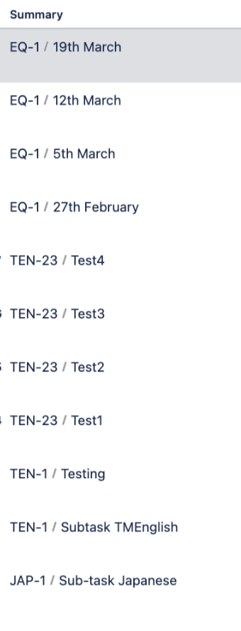

Old issue navigator:

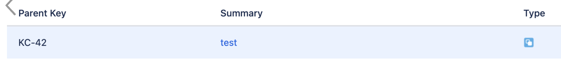

The output of the filter querysearch for your reference.
