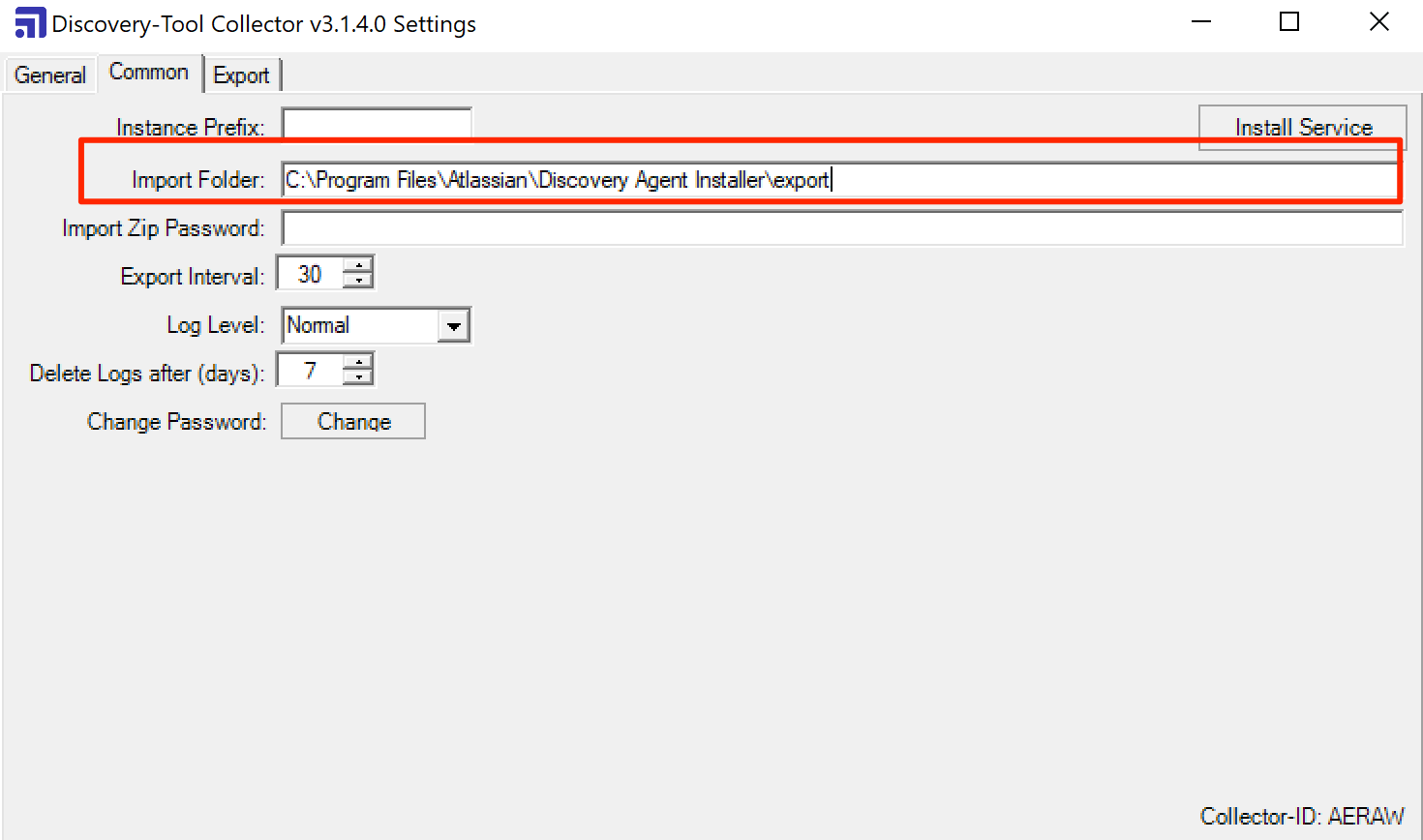

  4. Configure the Collector settings
    1. Open Collector-Tool Settings with the command Collector.exe -s.
    2. In the Import Folder field, set the shared path where the Agents' scan results are exported.

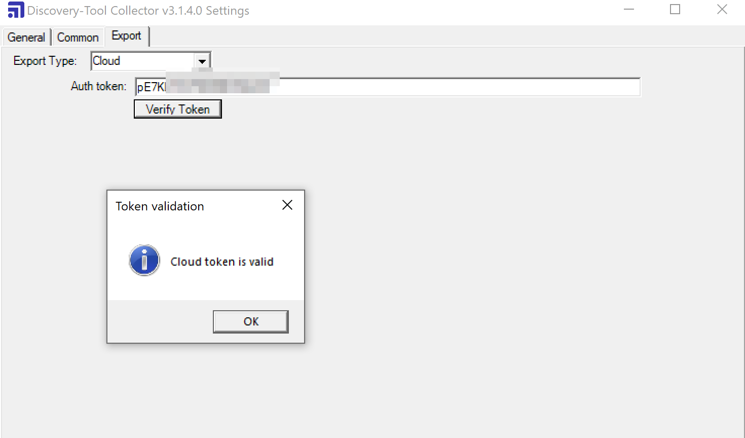

    3. Go to the Export tab and set Export Type to Cloud.
    4. Add an auth token for secure data transfer into Assets. Generate a token for importing
You can now close the Collector settings. Discovery Collector will run every 30 minutes by default. If any Agent scan results are found in the Import Folder, they will be exported to the Cloud.
