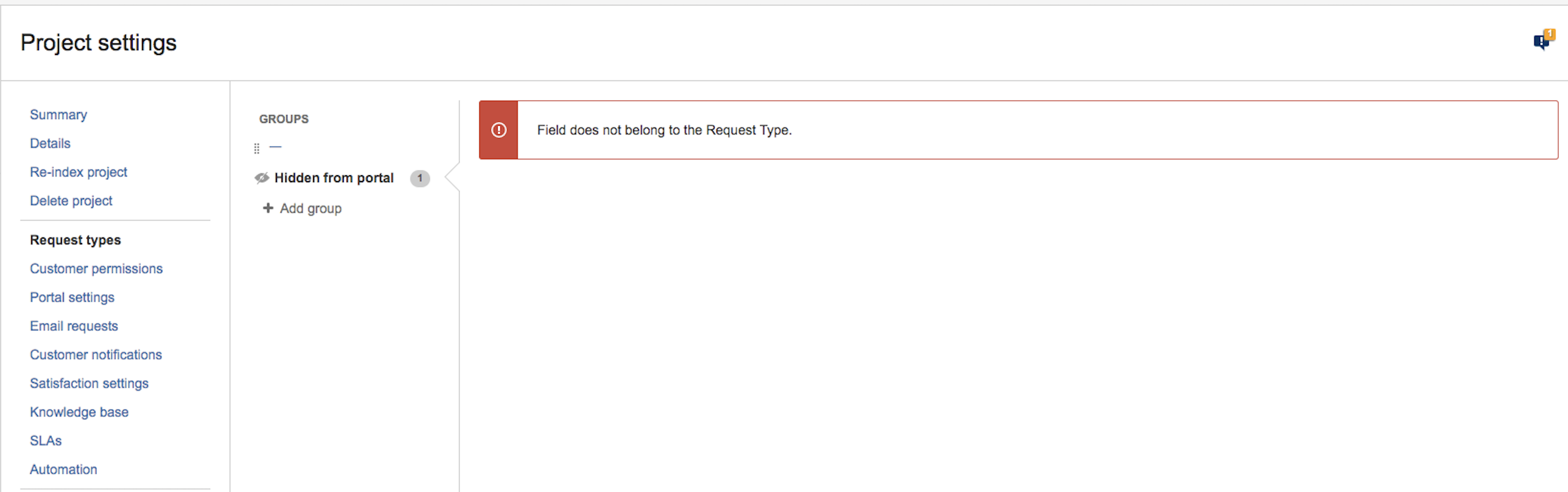

In a Service Management project, whenever a new Request Type is created, the error "Field does not belong to the Request Type." is displayed in the UI when clicking on the "Edit fields" button:
