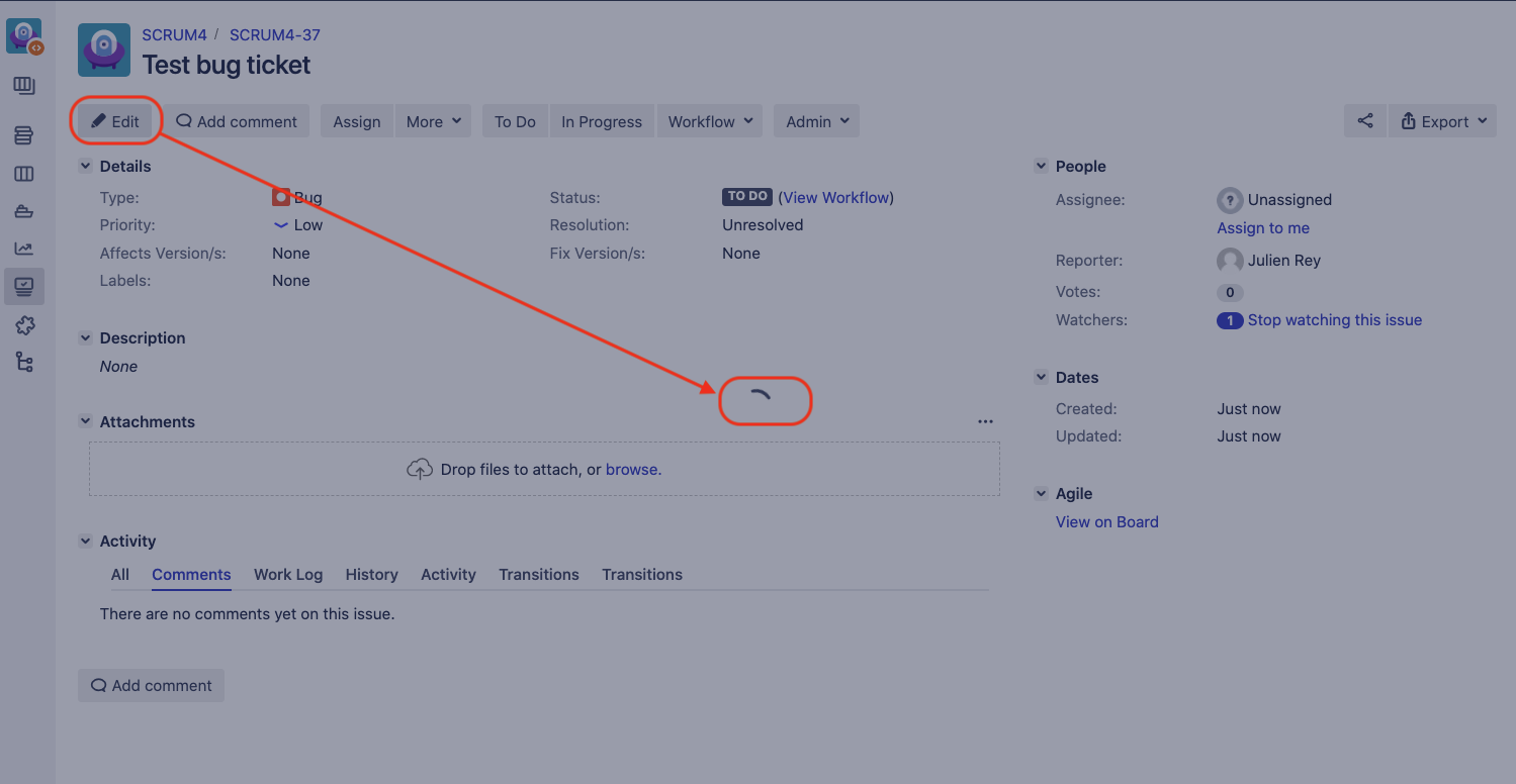

When clicking on the Edit button from the Jira View Issue screen, the page hangs and a spinning wheel is shown instead of the Edit Issue screen:

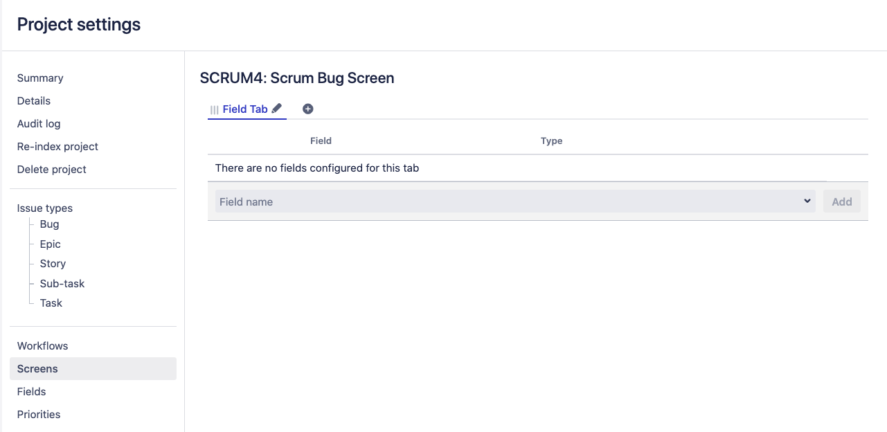

  • Go to the configuration of the Edit Screen associated to the type of the issue where you see the problem (by going to Project Settings > Screens) and check the fields configured for that screen. If no field is configured for that screen (as shown in the screenshot below), then Root Cause 1 is relevant:

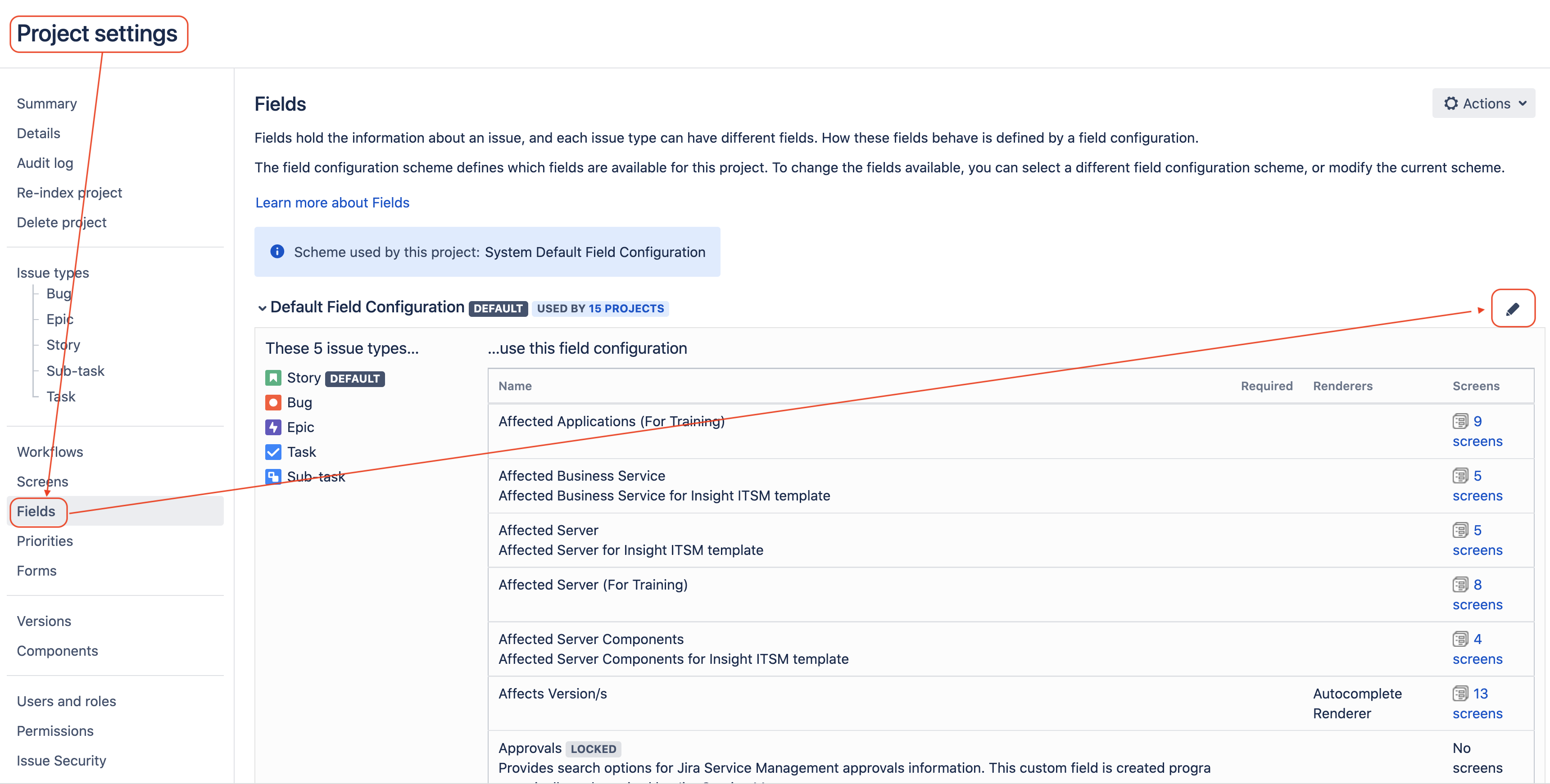

      • If you find Javascript code injected by at least 1 field, try to remove it for each field 1 by 1, by following the steps below:
        • Go Project Settings > Fields and click on on the Pencil icon on the right
        • Scroll down to the field, edit it, and delete the content of its description
      • If the issue goes away after you removed the javascript code associated to a field, then Root Cause 4 is relevant

Root Cause 1 - Known Jira Bug
If no field is associated to the Edit Issue screen, then you will run into the bug listed below: the Edit Issue Screen will not load and you will get a spinning wheel:
JRASERVER-72779 - Edit button causes JIRA to hang when Edit issue screen does not contain any field

Root Cause 1
Make sure that there is at least 1 field associated to the Edit Issue screen.
