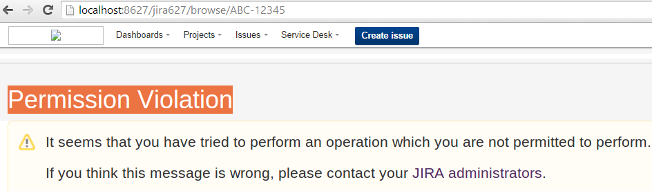

One or more issues are not searchable. Trying to access any of them e.g. ABC-12345 via direct URL displays the message "Permission Violation":
Denied Operations [DC]
