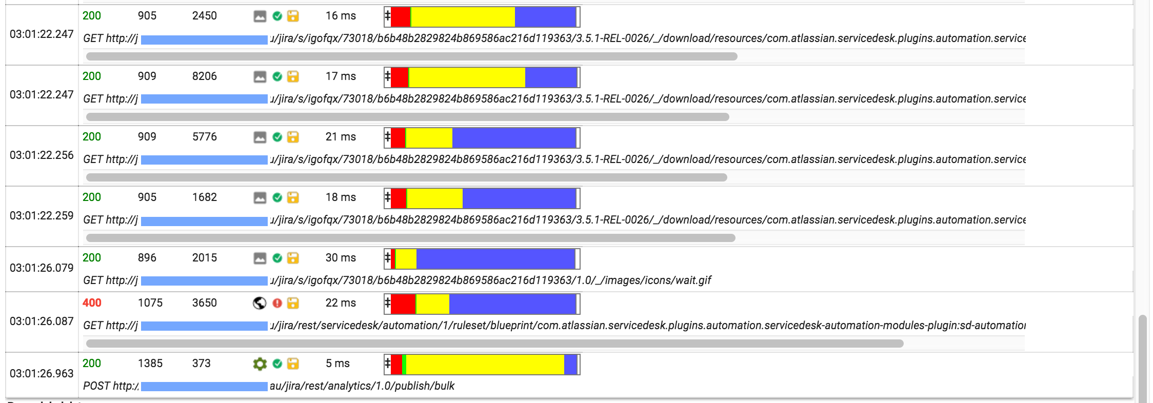

  2. Capture a HAR file for the Service Management Automation page that is displaying incorrectly and review it for HTTP 400 errors.

  1. Examine the URL with the 400 error and check whether there is a colon (:) character in the URL
