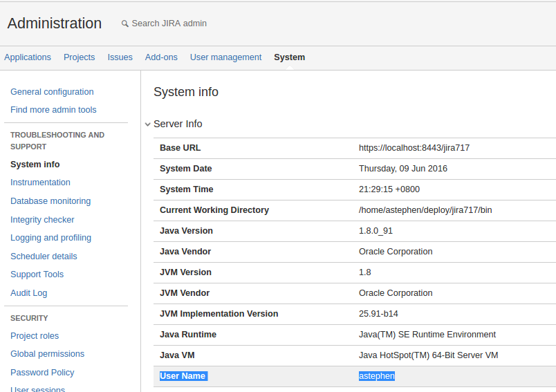

You will first need to find out the user who installed Jira. There are 3 methods to do this.
From The System Info page on your Jira instance:
From a Support Zip ( application.xml file ) search for <JIRA_USER>

You will also need to know the group the user belongs to run Jira and most of the time the group name is the same as the username that runs Jira
If you're unsure of what these permissions should be, please consult with your System Administrator and the user who installed JIRA.
If you are the user who installed Jira, you can see these details by running these commands:
whoami (this will tell your exact username) id -g -n (this will tell your group name)
