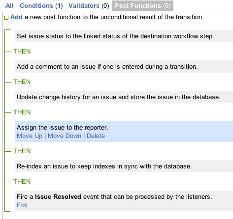

There is a custom transition in your workflow. If you look at the workflow post functions, the re-index is not after the issue update. In this example, the reporter gets changed but the issue does not get re-indexed. See cause 3 below.

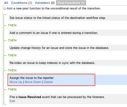

Move the position of the of the re-index post function and set it after issue update. See below screenshot as an example :
