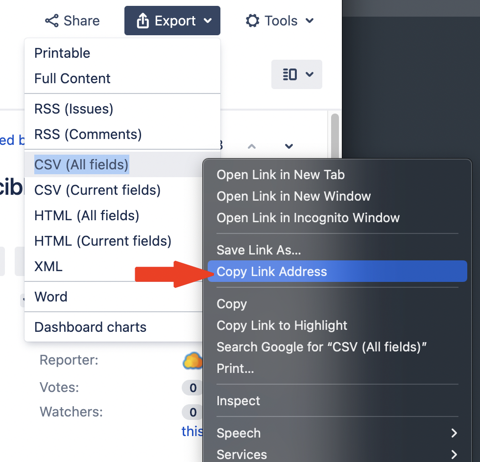

  1. Perform your search in the UI
  2. Copy the URL of the format link you choose in the Export menu:
  3. Paste this URL into the URL bar of a new browser tab.

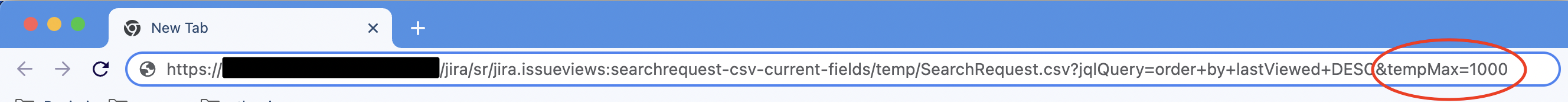

  4. Append the &tempMax= parameter to the number of issues you want (up to the max limit). Members of the unlimited group can remove this parameter to export the entire result set.
  5. Click return or go from the URL bar to download the exported results.
  6. If you want to export in batches, you can also append the &pager/start=1000 at the end of the URL string to instruct JIRA to export from index 1001 and above. You may need to append &tempMax=1000 as well. Example:
    https://<jira_instance>/jira/sr/jira.issueviews:searchrequest-csv-current-fields/temp/SearchRequest.csv?jqlQuery=order+by+lastViewed+DESC&tempMax=1000&pager/start=1000
  7. Next export should append the &pager/start=2000 (change from &pager/start=1000 to &pager/start=2000) at the end of the URL string to instruct JIRA to export from index 2001 and above (1000 rows).
