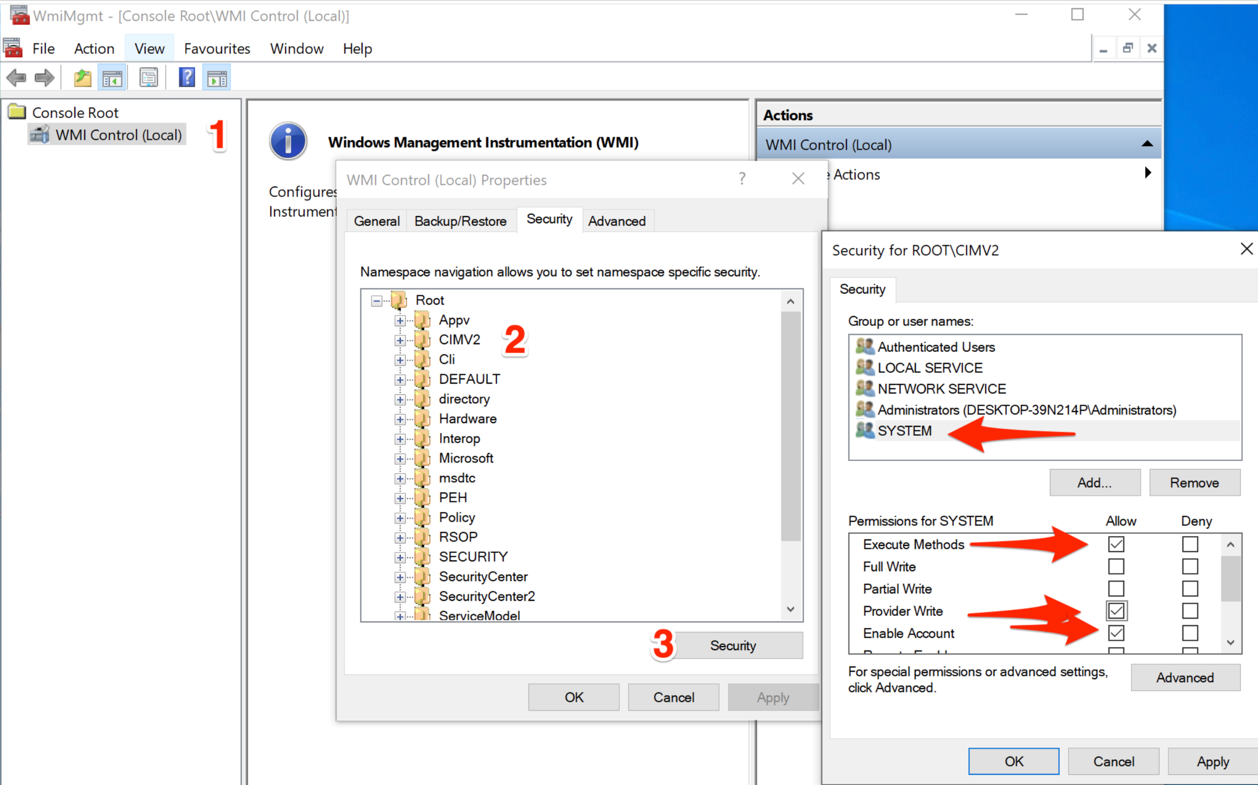

Grant DCOM Permissions to SYSTEM user
  1. On the Host where the Discovery tool is installed, Win+R / Run : wmimgmt.msc
  2. Open the WMI Control (Local) Properties > Security Tab
  3. Expand Root, and select CIMV2
  4. Click Security
    1. If not there - add the SYSTEM User, and make sure this user has:
      1. Execute Methods
      2. Provider Write
      3. Enable Account

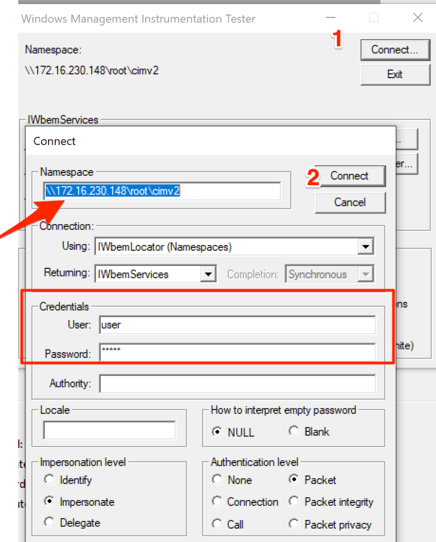

Test WMI connectivity with wbemtest.exe tool
WBEMTEST is available on any Windows system and it is a graphical utility that you can use to test connectivity to remote systems.
  1. On the host where the Discovery tool is installed, go to Start and type "WBEMTEST.exe" into the search or run box.
  2. Click Connect... and enter:
    1. The server name or IP of the the target host on Namespace: \\<targetIpAddressHere>\root\cimv2
    2. And user credentials (same ones as you use on Discovery Credentials tab) including any Windows domain, for example "domain\username".
    3. Click Connect
    4. If connection fails, please reach out your System Administrator to troubleshoot VMI connectivity issues between the target host and Discovery host. Ensure you grant DCOM Permissions to SYSTEM user if it is a scheduled scan
    5. If connection succeed, run a query
      • On the same tool screen, click on Query
      • Run the following query:
        SELECT * FROM Win32_Processor
      • If succeed, Discovery should be able to scan the target Windows host successfully
