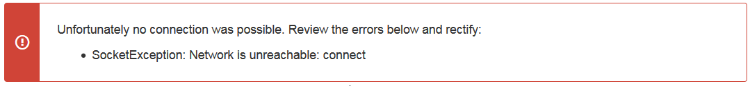

After you finish setting up the Outgoing SMTP Mail Server in JIRA, while you try to test the connection the the following error appears:
The following stack traces appears in the atlassian-jira.log:
1 2013-07-25 15:00:36,343 http-bio-8080-exec-16 ERROR test 900x1185x1 11bp8rq 192.168.0.105 /secure/admin/VerifySmtpServerConnection!update.jspa [plugins.mail.webwork.VerifyMailServer] Unable to connect to the server at test.mail.smtp due to the following exception: java.net.BindException: Cannot assign requested address: connect
